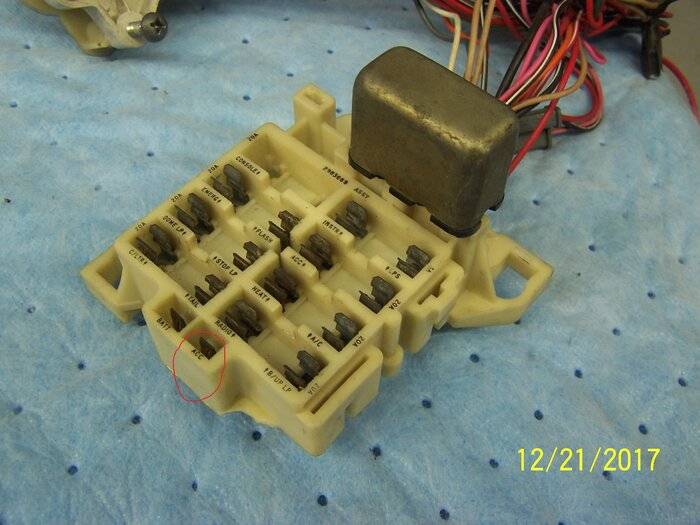

I'm not sure what they mean by "crank power supply" but you want to terminate it on a Key on supply. Look at your fuse block to see if there is a empty spade on "ACC". There are two sources for power on the fuse block. One (red) wire goes to Batt always hot. You don't want that one since you don't want the fuel pump powered up all the time. The black wire goes to ACC which is from the ignition switch and only powers the fuses for things like the radio and A/C. If you terminate your fuel pump at that ACC spade you will need to put a 30A fuse inline with that if they didn't supply one because the ACC spade is not fused. Here is a pic

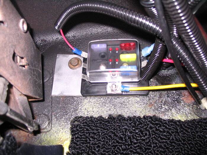

I ran a separate fuse block for extra accessories it takes the load off the factory harness ran a relay wire from the acc off the factory block the trigger it on.

The blue circuit in the engine compartment is the run circuit & yes & would run a separate wire & a relay to switch it on , this will not power when cranking tho , but in theory if you turn the key on for a few second before trying to start it it will pressurize the fuel system & should start immediately if you are using EFI . , the brown wire at the ballast is the power while cranking circuit if you need to tie into that but you may have to use a diode to prevent it back feeding depending how other things are connected .

10 GA wire from starter relay to relay to new fuse box relay trigger wire from ACC on factory fuse box.

it has a relay :)
