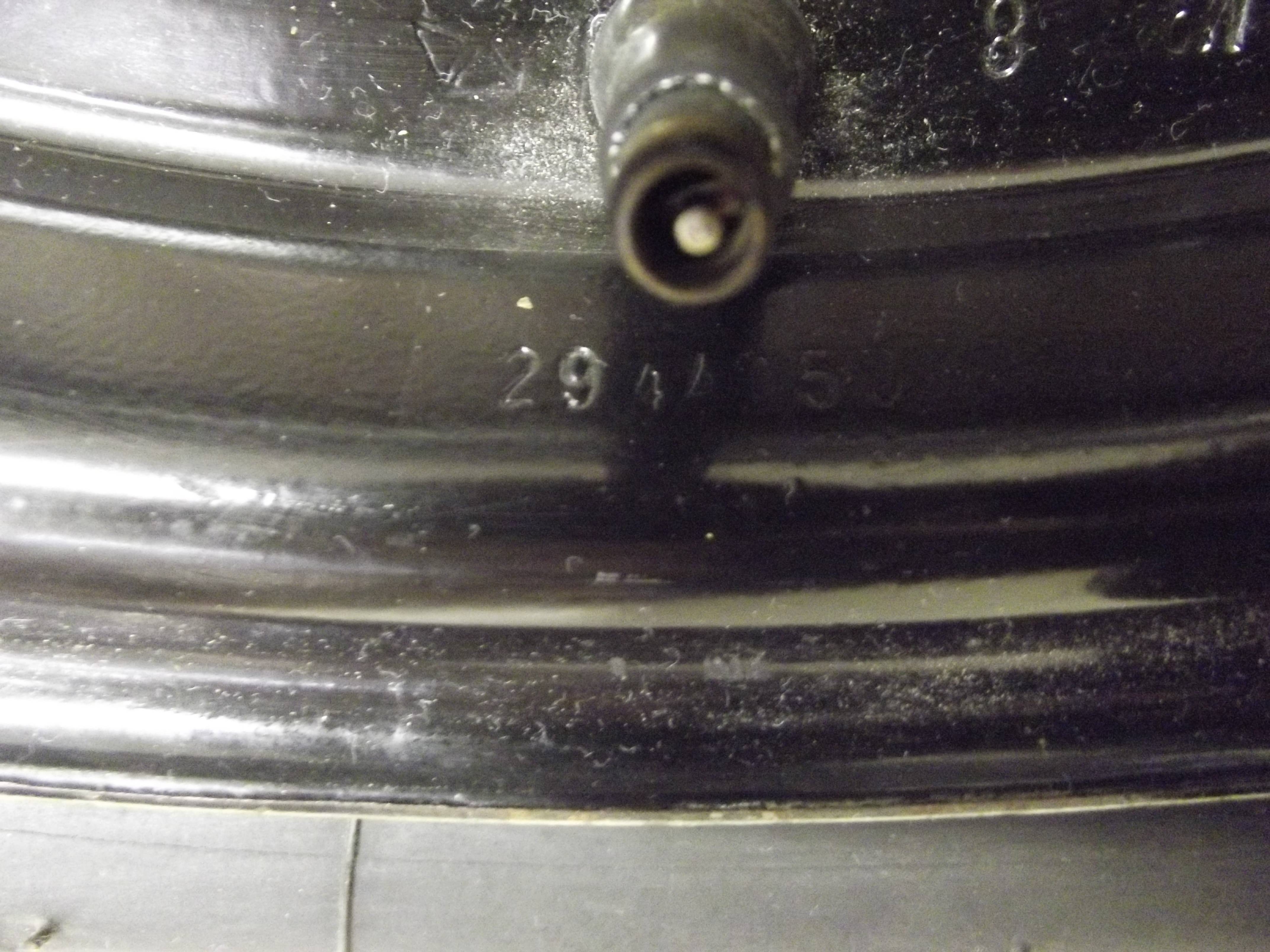

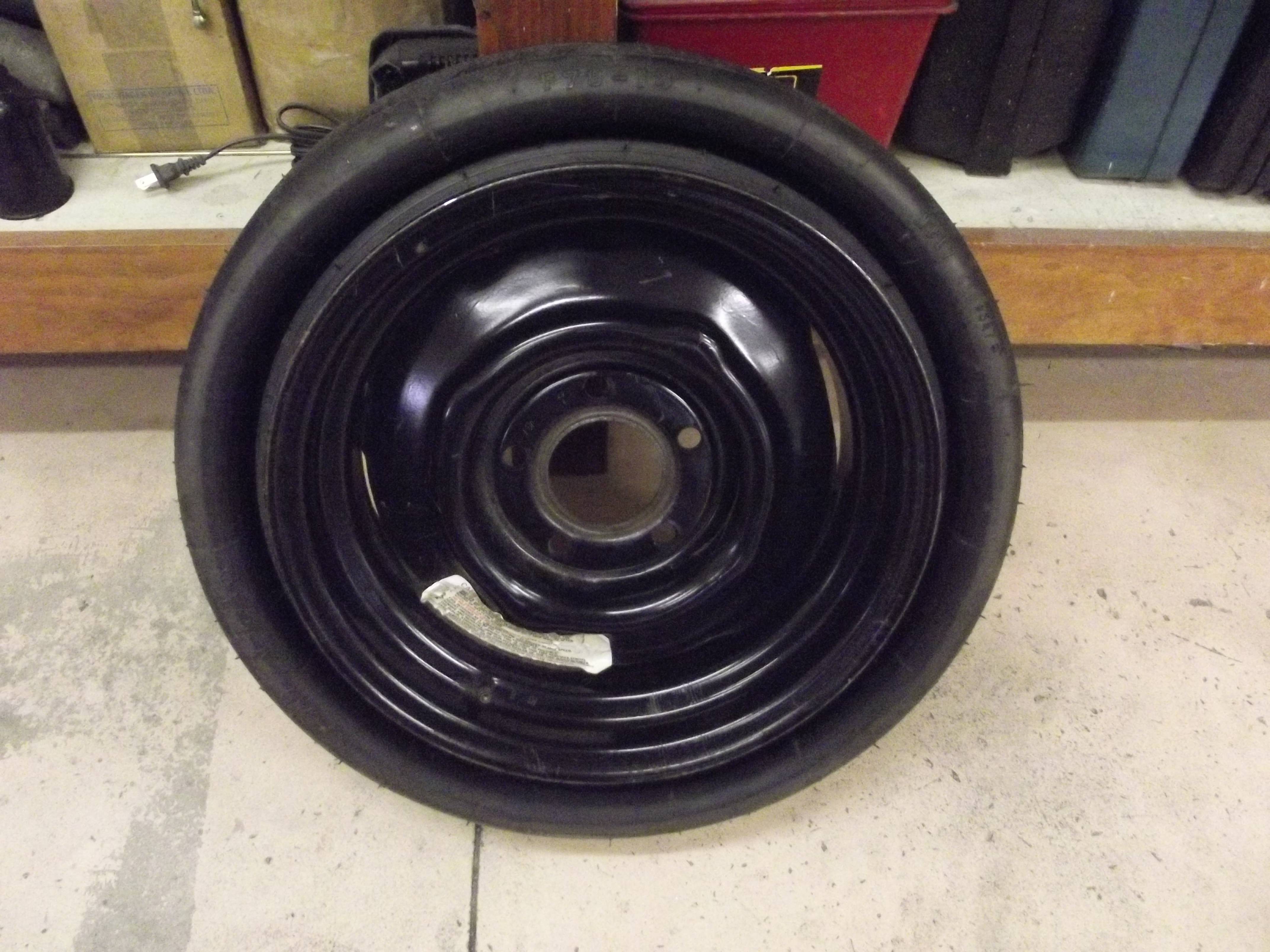

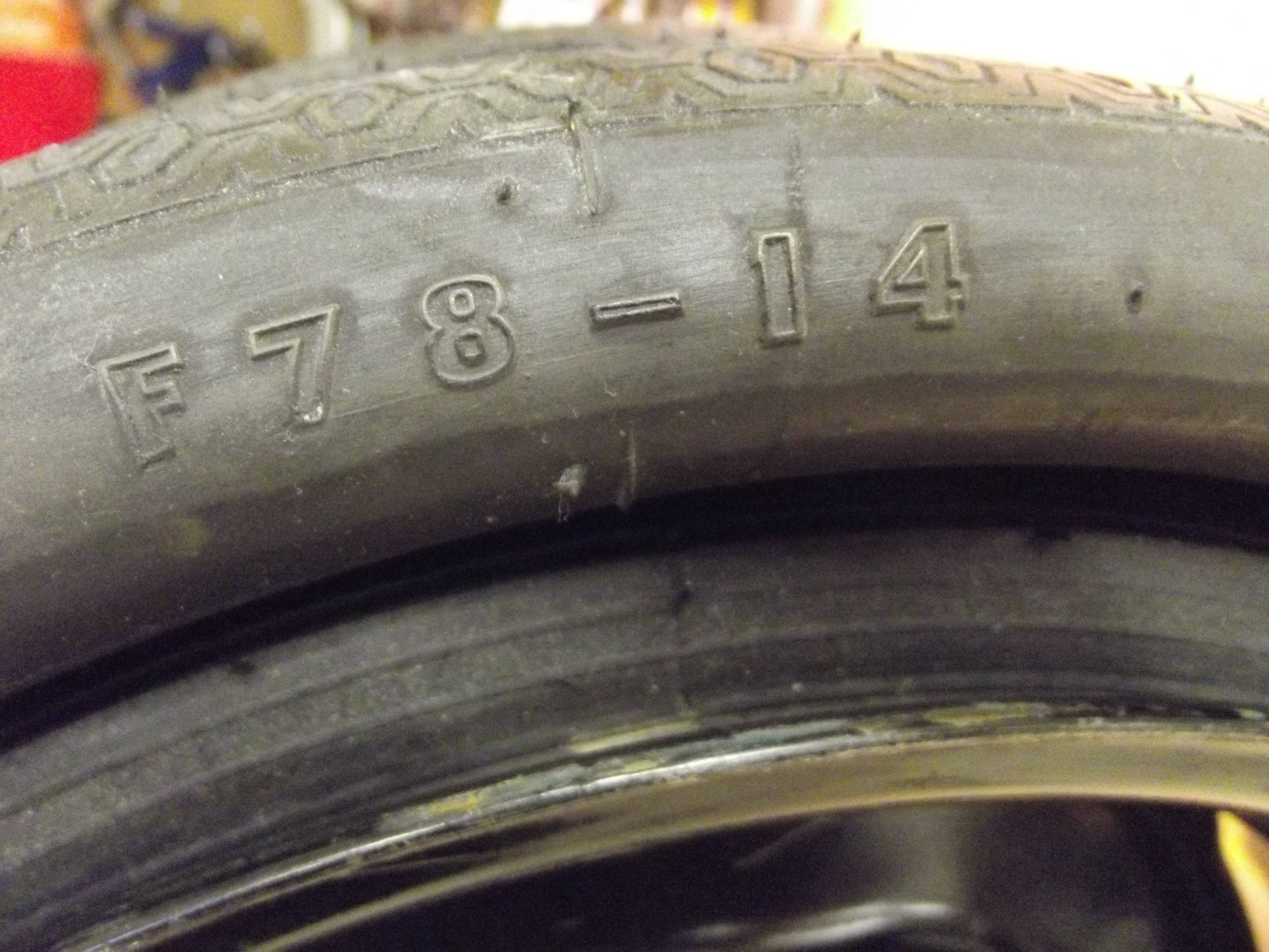

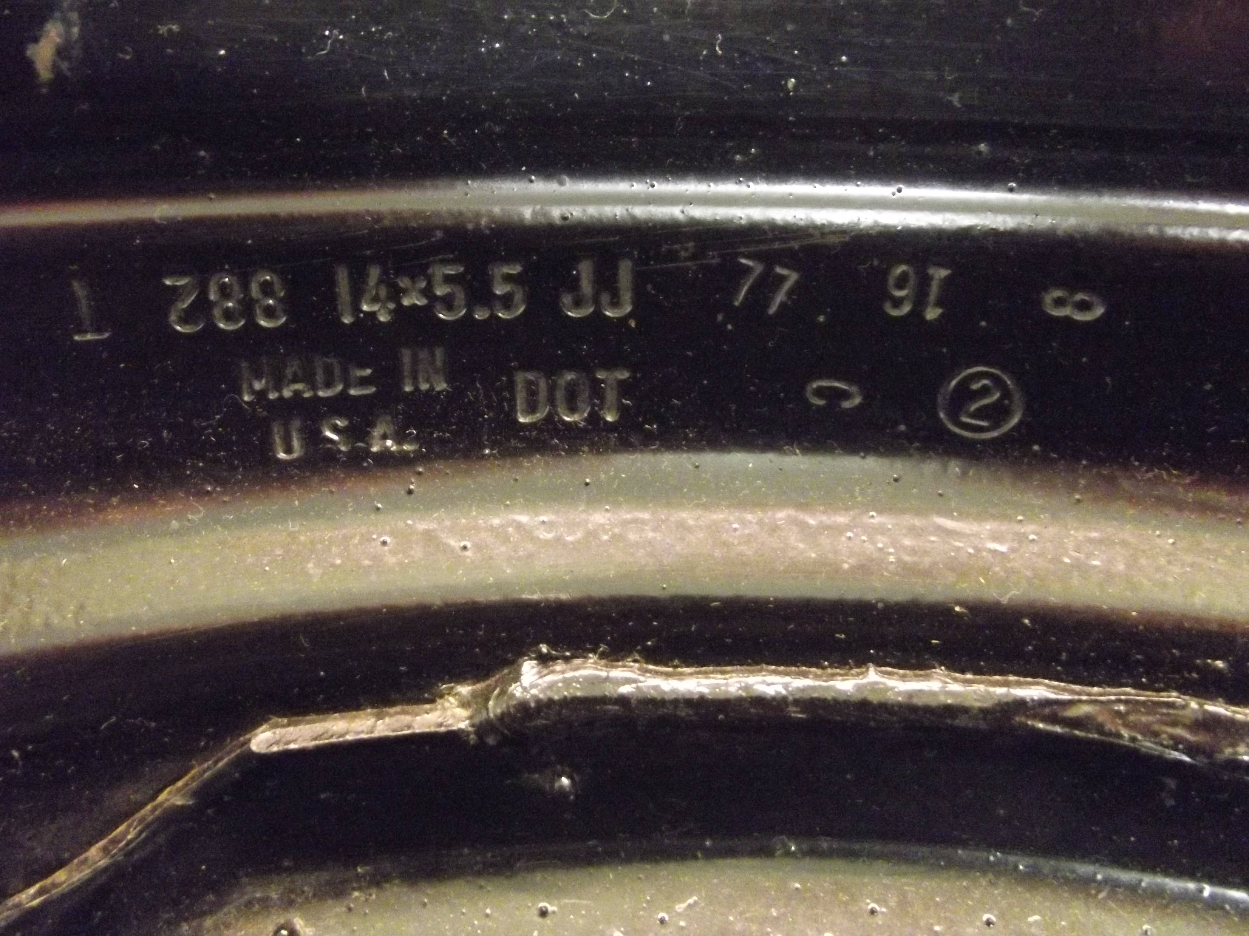

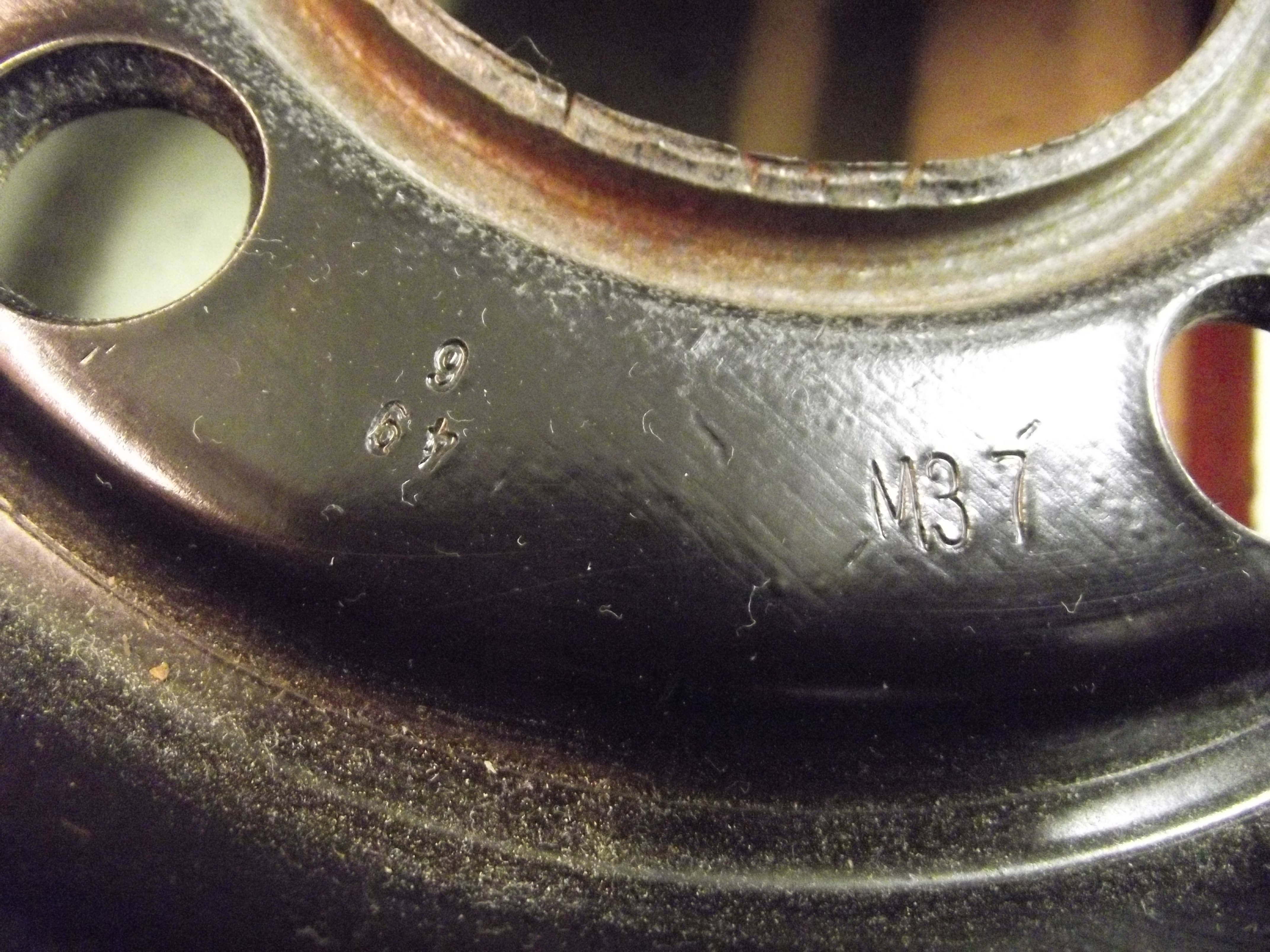

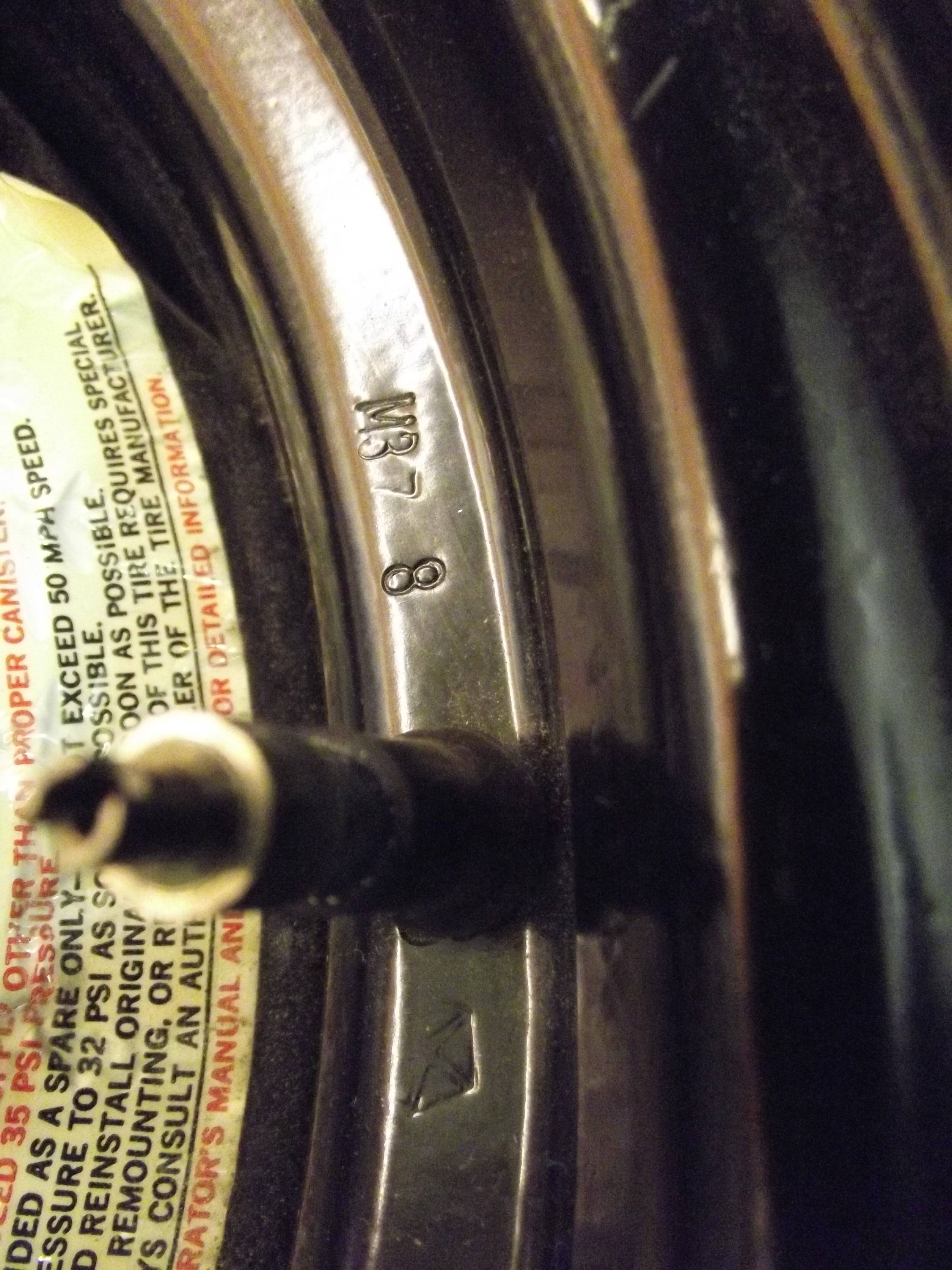

Trying to ID this spare tire. And maybe a date.
Thanks
floyd
Mar 18, 2012
295
166
