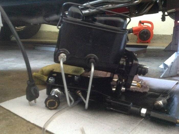

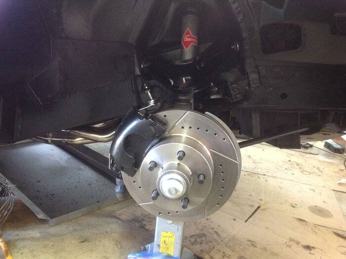

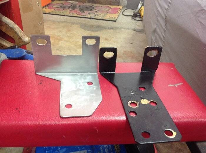

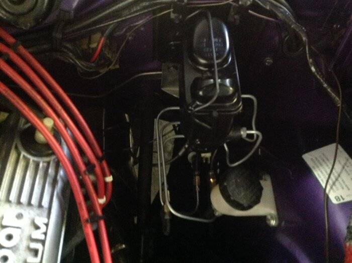

This kit needed some changes to make operational, But Now the car Brakes Better than ever and wanted everybody who was thinking about this know its a Easy Swap.
Looks good Ken, but you need to tell us more. What kit and parts did you use and what modifications did you have to do?
Notice you have sway bar. Were the calipers suppose to be to the front or back? Or did it matter?

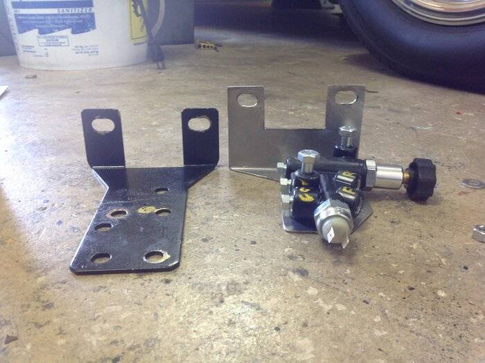

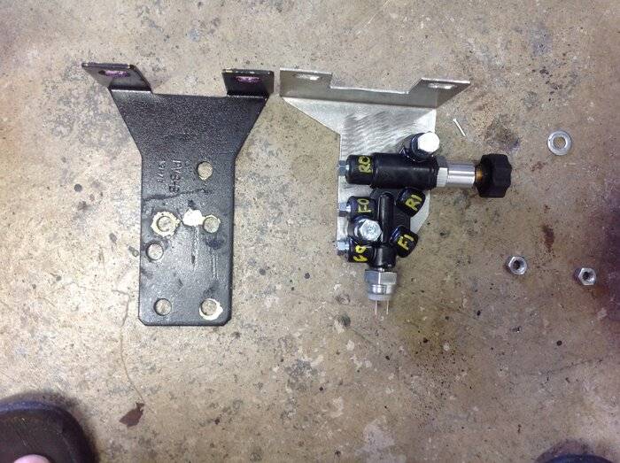

Sorry about being vague, The kit was suppose to be a complete drop in. However the porpotional value hit the LH Fender well when installed. I made a New Bracket which dropped the Porpotionsl valve lower &
then turned the valve 180 degrees. This ment Flaring new lines, which ment buying a Double flare tool. After alignment, car is stop at 80% Front braking power 20% rear, with No pull and wheel stays straight. Thanks Ken

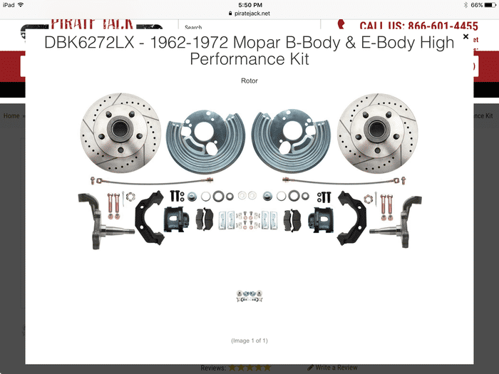

Some kits are based on existing components for instance Master Power use calipers from the Mirada's.
