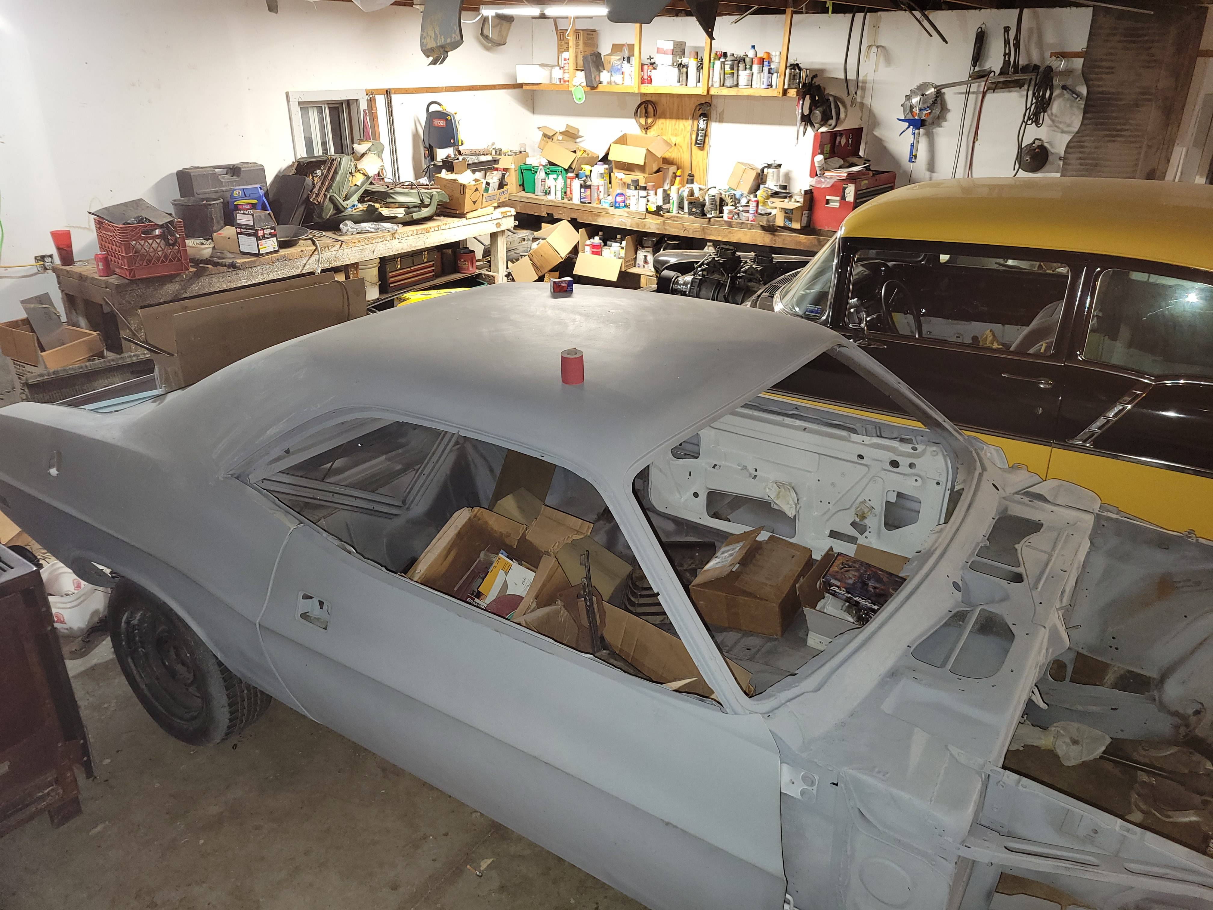

Please tell me the correct color and texture for the k-member and a-arms...torsion bars, too. Thanks
