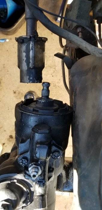

I installed a K member from a B body (don't know the year), into my 70 Barracuda, so I can install a 360. The car was originally a slant six. I noticed that when I installed the gear box (power steering) the shaft from the gear box and the steering coupler are about 1/2 inch off. Is there any adjustment I can make? Is there a flexible joint I can install? If so, where can I get this joint. I will try to send a picture. Thanks
If you have the correct matching parts, k-frame, steering gear, steering column, there is no need for any kind of modifications. There is some axial movement in the steering coupler itself. Send us a picture of your setup.

I'll send a picture. The steering gear and shaft are from the Barracuda. The K member is the only part different. Thanks

Here are some pictures. It looks like the steering gear is really angled. Can the the steering shaft be moved down. It looks like if the parts did match up, the slot for the pin wouldn't match up.

Is the steering gear up tight to the shock tower? I know it's close, but it shouldn't be touching like that.
It could be the wrong k-frame, but it could also be the correct one but with some damage to it. Can you tell if anything looks to be bent or broken and someone tried to re-weld it? Look at the front vertical face of the k-frame and there should be some numbers stamped or even a "coin" tacked on with some numbers on it.
Sorry to say, it is the wrong K- member. You can break the welds and rotate the box or replace the K. Do an internet search. I know this was gone over in detail on www.moparts.com

I think it's from a 69 B body. I think I'll try to get a k member for an E body. Thanks. I'll look at the link.
