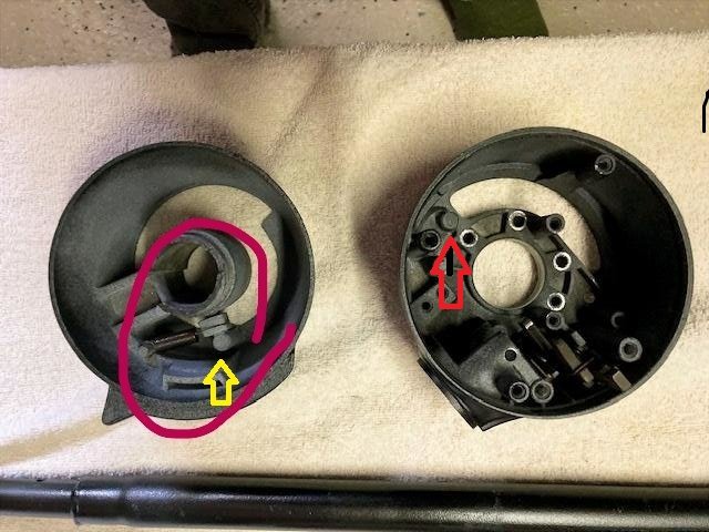

Would you post a picture. The arrows show where I was thinking. It can help others. I would have got back to you soon. But I had to B and E and change a few locks.

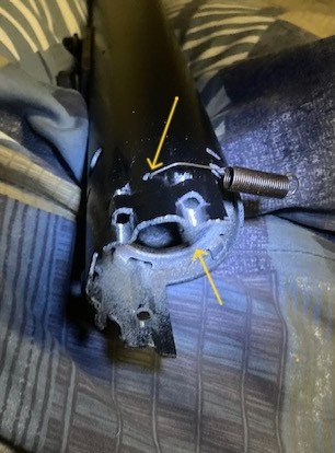

The first picture top arrow is the tube where t hole is for the spring.
The bottom arrow is where I'm asking if I need the spring washer (or wavy washer shown in the video from Cuda Cody). The video shows a 70' column restoration. So, 70' had a lock tube not this release lever, and I'm wondering if the spring washer is needed only on the 70' column. I'm 100% sure my column did not have a spring washer between the top of the tube and the release cone.

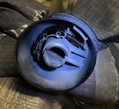

The second picture shows the release cone mounted on the tube with the spring in place.
Hope the pictures will help someone else out who forgets how they took it apart.

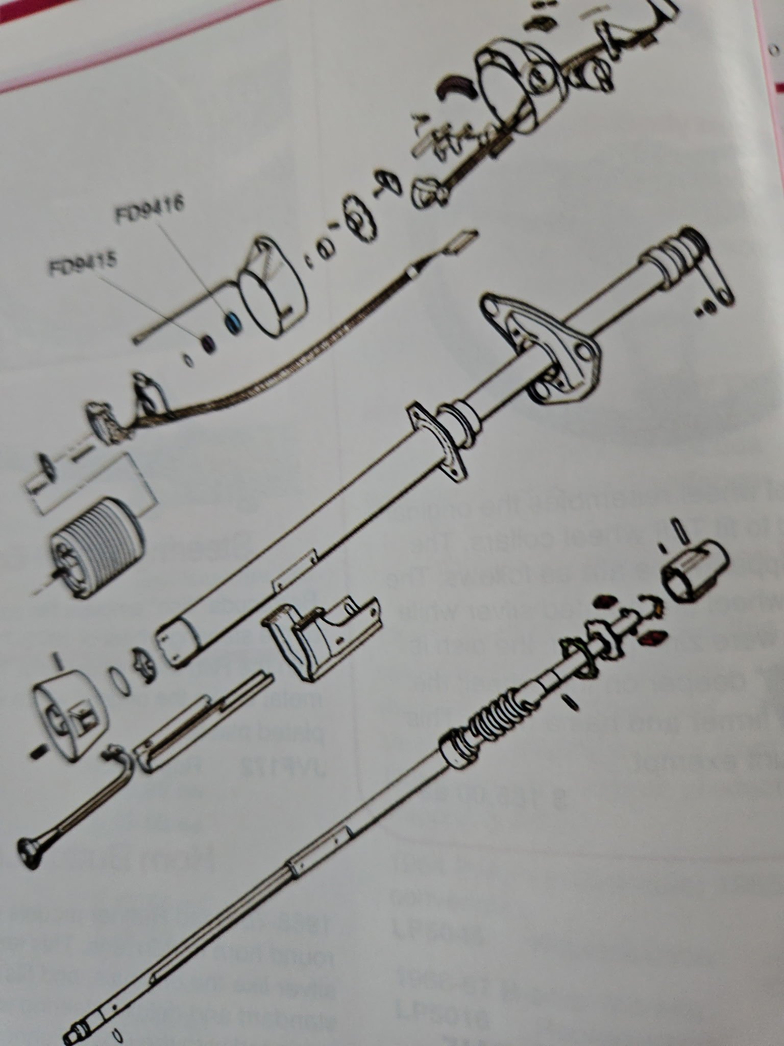

Now does anyone have an exploded view of a 73' column. I still need information on the wavy washer. So far, I have only found 70' column views, and they are different.
