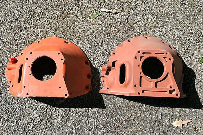

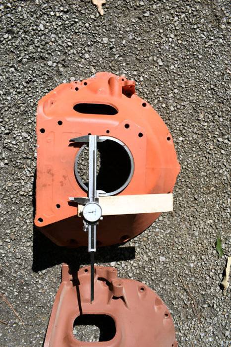

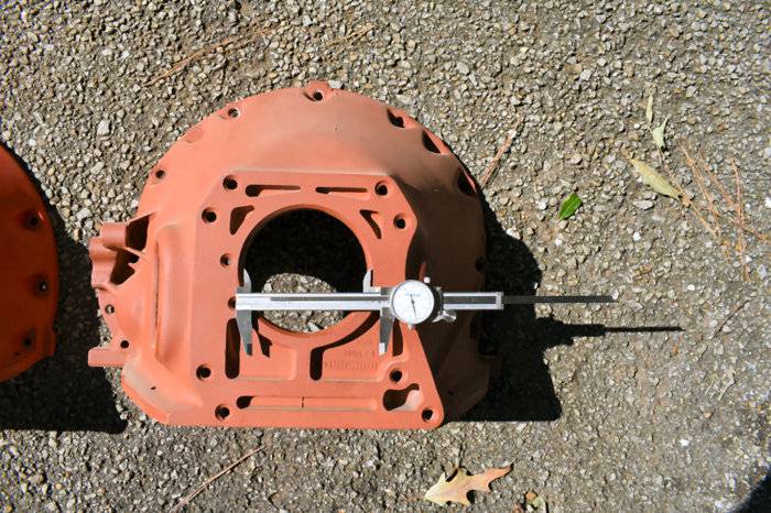

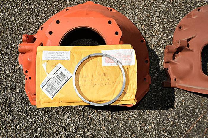

To add to 69hemibeep's comment. Attached photos of an adapter ring that will allow your small block bearing retainers outside diameter to fit the big block bell. Might be cheaper than a new bearing retainer. Not advertising for anyone, but Brewer's had this ring.

We are going to do a 4 speed conversion on my brothers Challenger small block and we got ahold of a big block trans with the large bearing retainer and Brewers machined his bell housing to fit. Great service.
