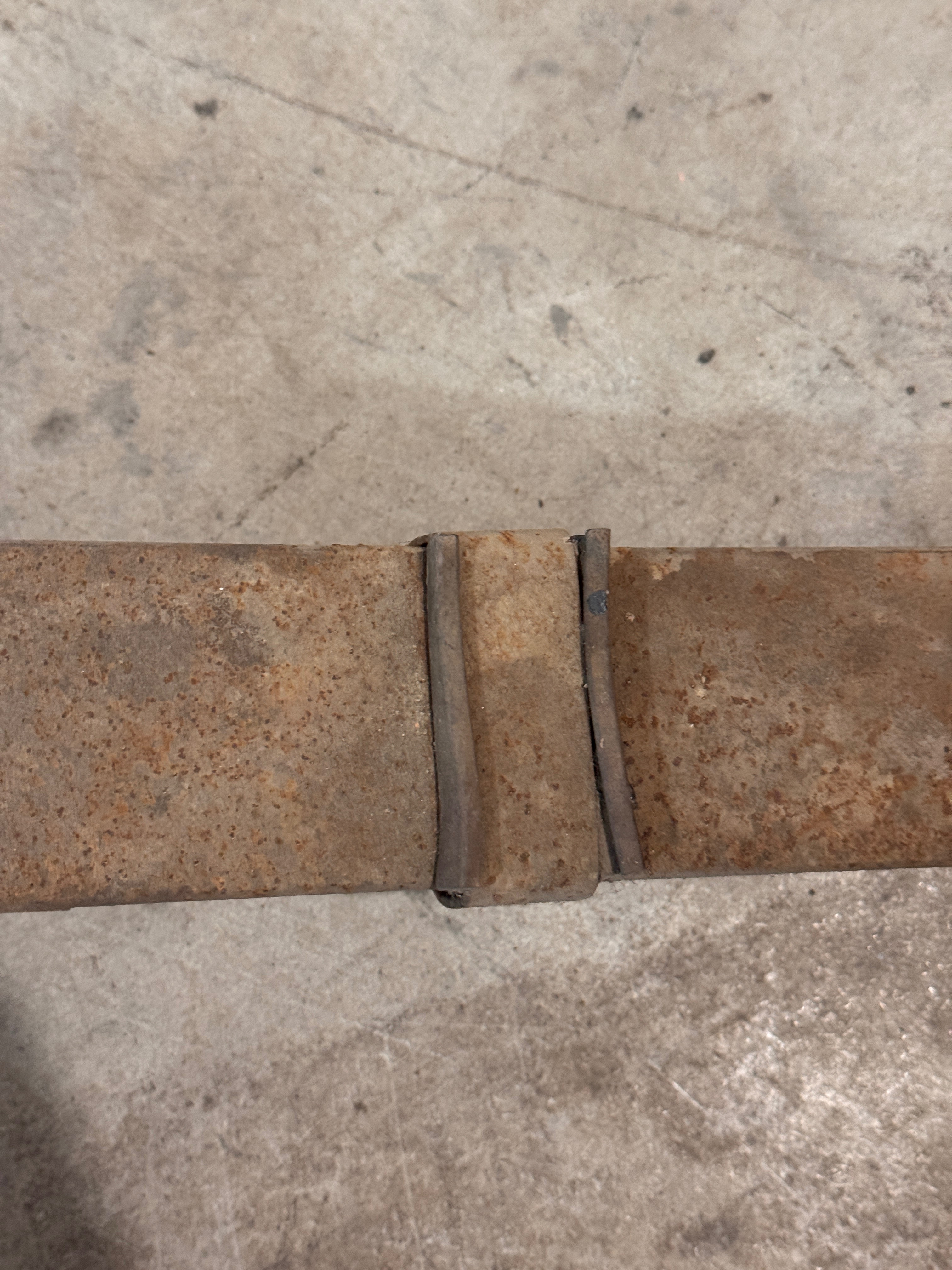

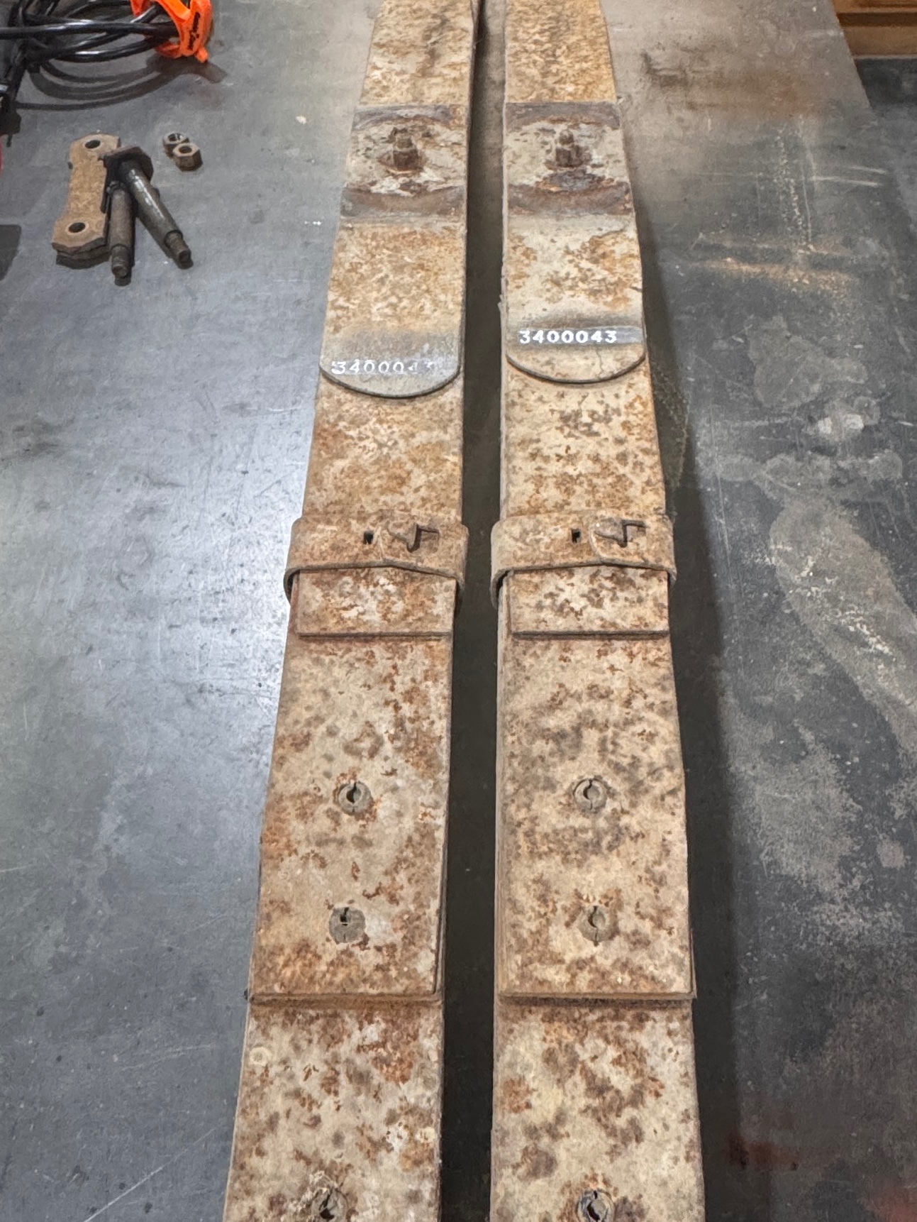

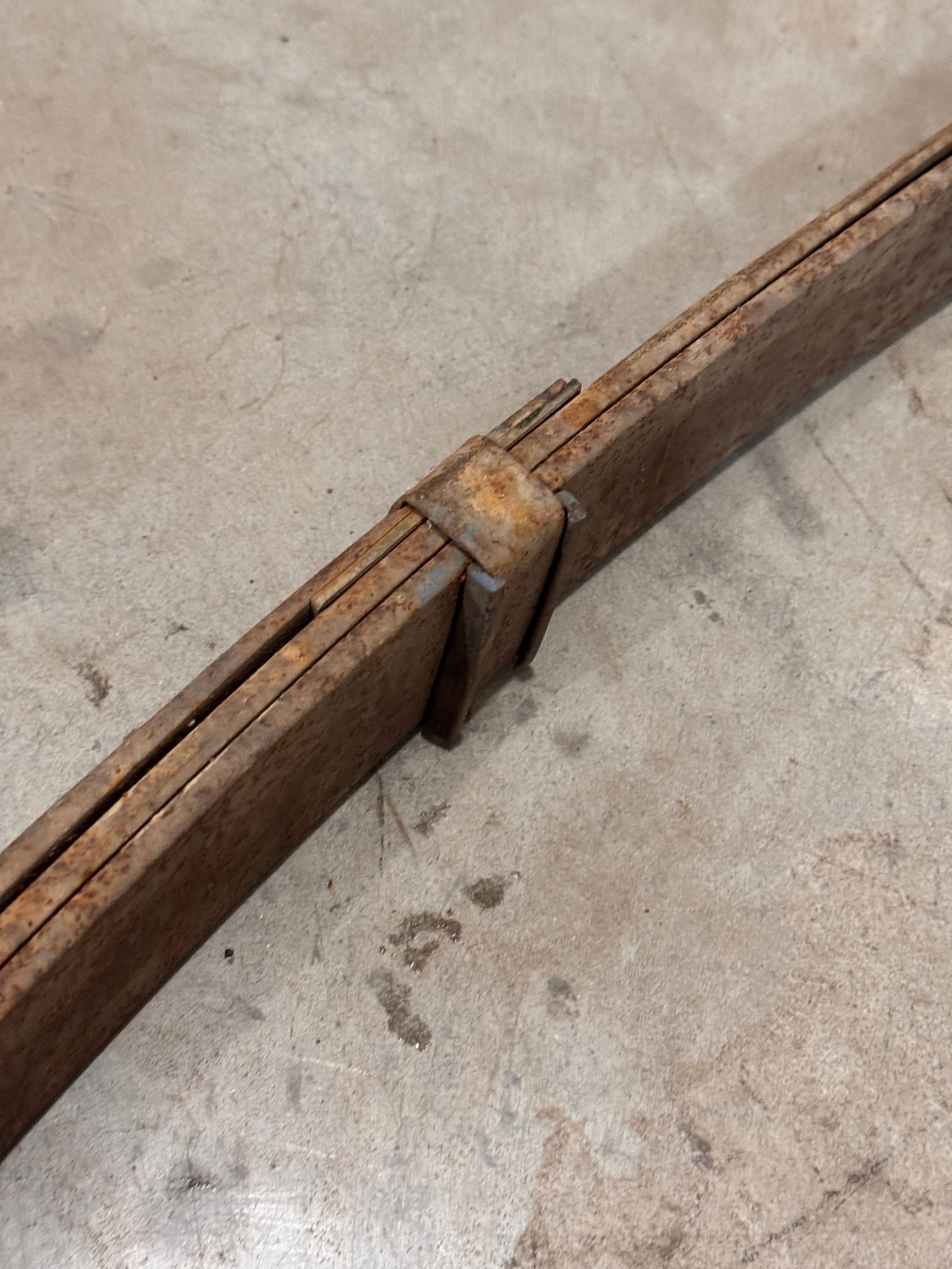

Looking to rebuild my leaf springs and was wondering if there are some opinions out there about what kit is the best to use. There are several of the MOPAR parts sites with offerings and prices seem to have quite the range. The kits don't seem to include the center bolt either, what is a source for that?

Thanks for those tips. Anyone else have an opinion on a kit, maybe looking a little deeper in the bands/straps, insulators, etc?
