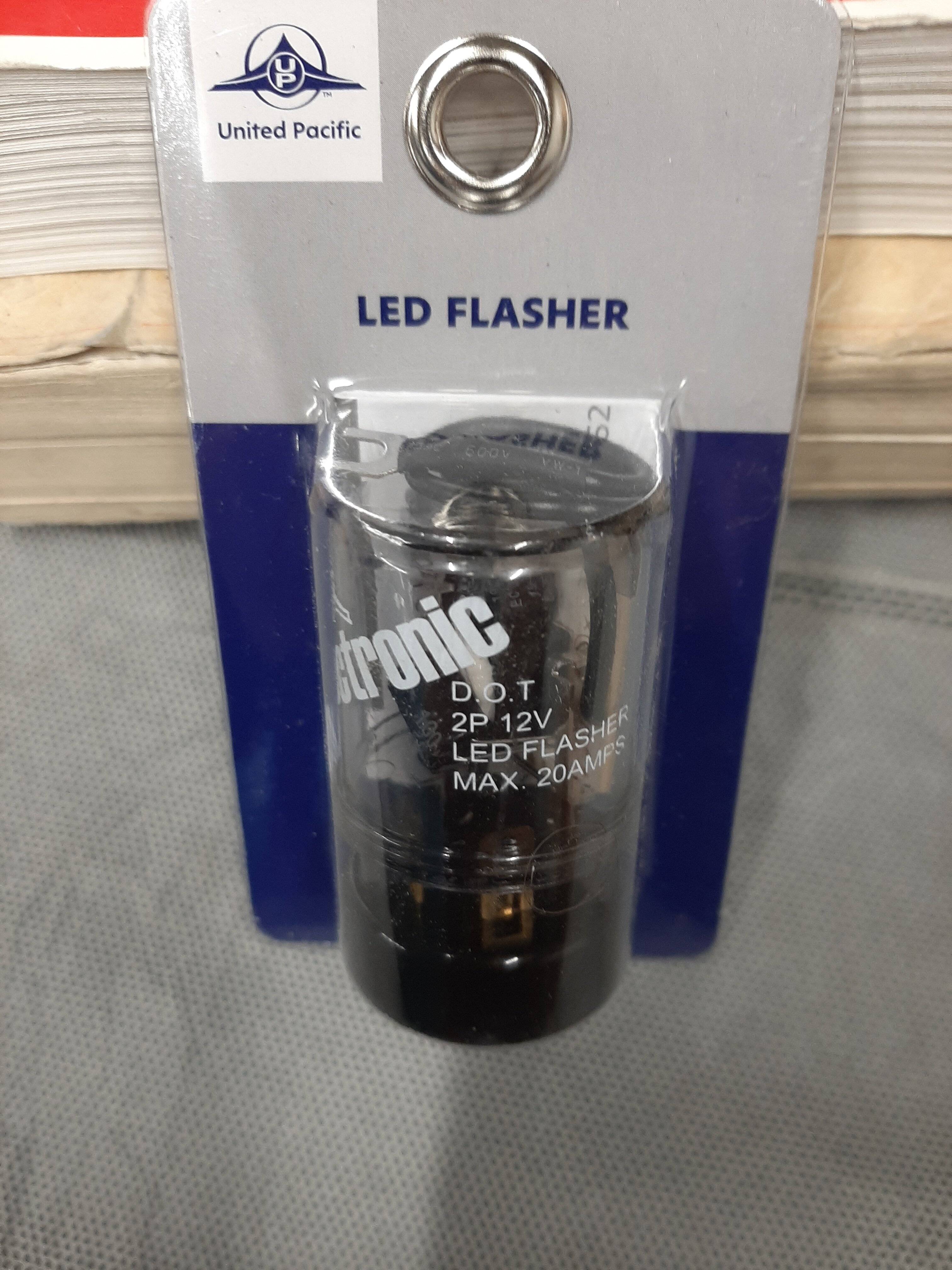

Here's the flasher unit with ground pigtail and reversing polarity base I used and now my LED emergency flashers and turn signal lights work great.
Terry W.

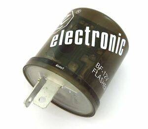

The EF-32 is the direct replacement for the 552 (stock) flasher. If you prefer the one with the ground wire, the part number number is EF32-RL. These are available on Amazon for no more than 12 bucks. I supply the CEC brand with my LED arrays.

When you plug in the electronic flasher, it is polarity sensitive. One of the male prongs is positive and the other prong is negative in the wiring harness. The flasher may not work when you plug it into the wiring harness. That's what happened to my lights. I made up a couple of wires with ends, crossed them over when I plugged in the flasher to the harness and my lights started blinking. I bought the polarity reversing base to eliminate the pigtail wires I made up. The base replaces the wires for a cleaner look. My photo above shows the reversing base below the flasher in the package.
Terry W.
