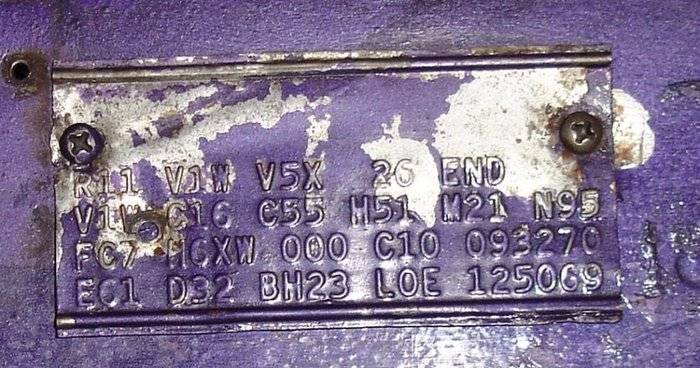

Data plate listed the car as: BH 23 LOE 125069, (not a Cuda, but a BB)

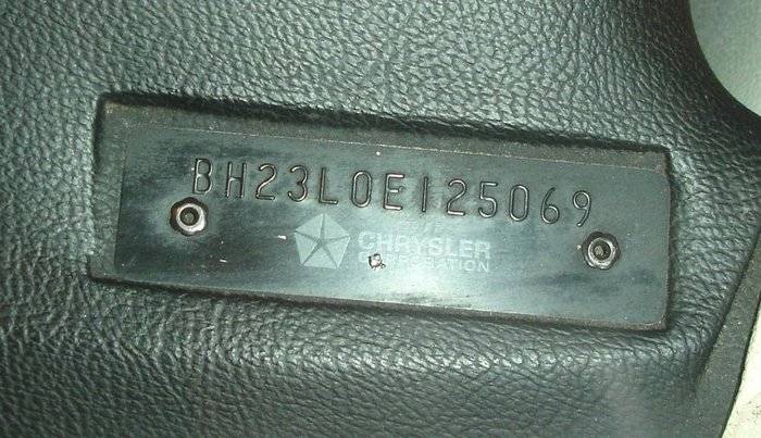

Dash plate matched the data plate.
The serial number on the body was altered.
Could this have been done through a motor vehicle agency?

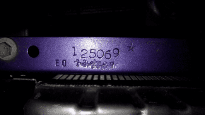

Strange. I wonder if it was a theft? You wouldn't re-body into a 383 2bbl Barracuda. And I wonder if they didn't know about the cowl VIN and missed it? The question; what was 124327????

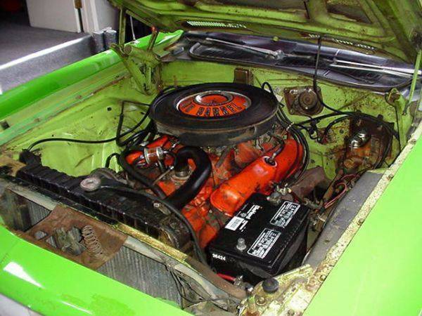

I've gotta say I've never seen anybody use a strap like that around the exhaust manifolds to install an engine. And interesting choice for the exhaust manifold on the right side.

Strange, the numbers on the cowl and the radiator frame match, which makes me think that the dash tag and engine plate were from another car.
The dash tag also looks like it was riveted in slightly off.
This car raises a lot of flags!

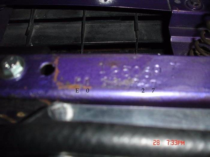

Aren't 70 radiator support numbers on the side not the top? Does not look like the numbers on my cars. The cowl looks correct
Yea, The frame looks re-stamped, the radiator frame numbers are usually on the driver's side back of the frame, usually hidden by the top of the radiator.
You can see the 124327 scratched out with a new number above it.

I have seen several E0 cars stamped on the top of the radiator support. California cars are a little different but not as different as this restamping.
My stamping is on top but in the opposite direction right to left E0 125780 with a 12 1969 build date so the original looks like a earlier 69 build the fonts on the new number are wrong the cowl number runs the same as the 1 pictured definitely looks like a vin swap maybe there is some other signs of fraud what does the star mean is that

Yea I'm sure that's why they posted the first pic that is all blurry so the new owner won't know they have been ripped off until they get the car. Definitely a franken car and nothing I would want

Looks like vin has been cut out of another dash with rivets in still in place and this cars dash vin cut out and replaced with the cut out piece. Pretty sharp looking rectangle piece surrounding the vin tag. Or just replaced dash :)
