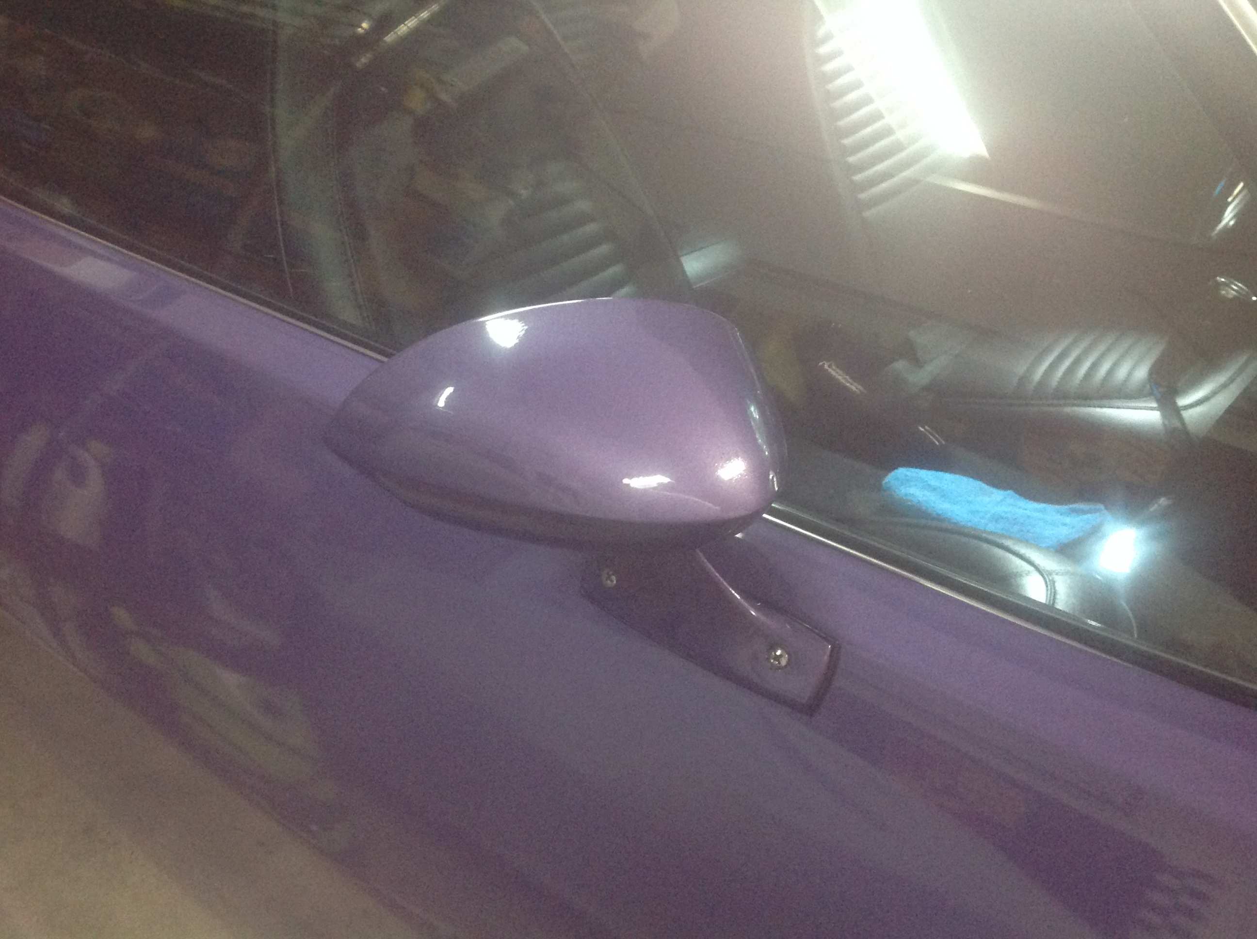

Dec 10, 2023 #1 ken 408 Stroker Active Member Joined Apr 2, 2019 Messages 35 Reaction score 9 Location San Jose, CA I have a 70 Barracuda, the Sport mirror on Drivers side is loose inside the mirror. is there a way to tighten something is side the mirror, any info would help

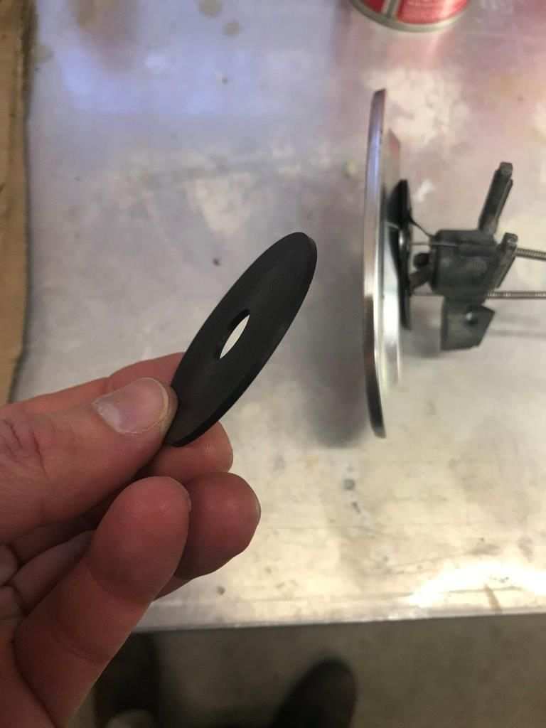

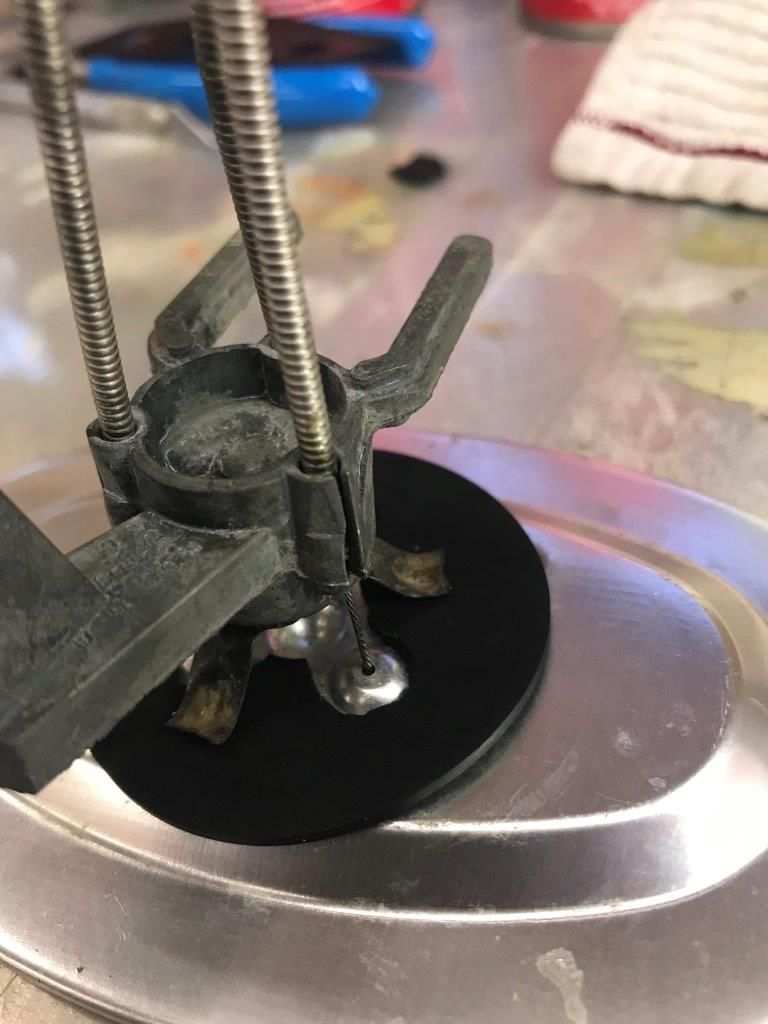

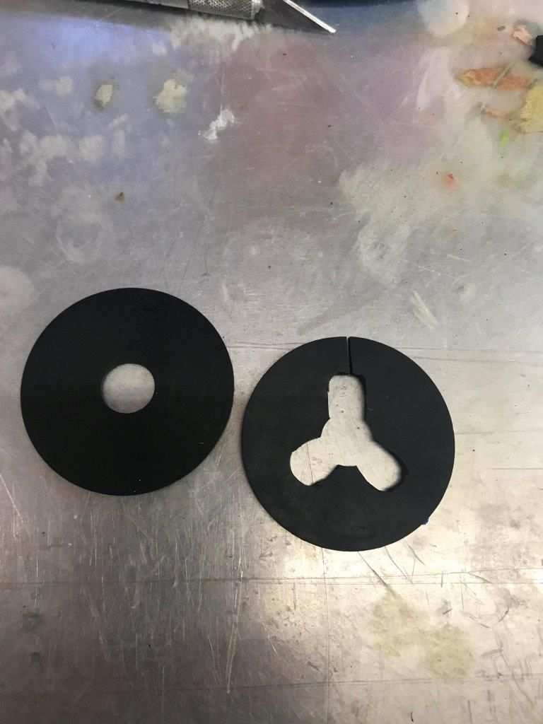

Dec 10, 2023 #2 floyd Well-Known Member Joined Mar 18, 2012 Messages 275 Reaction score 151 This worked for me. Hardware store rubber fender washer trimmed as shown.
