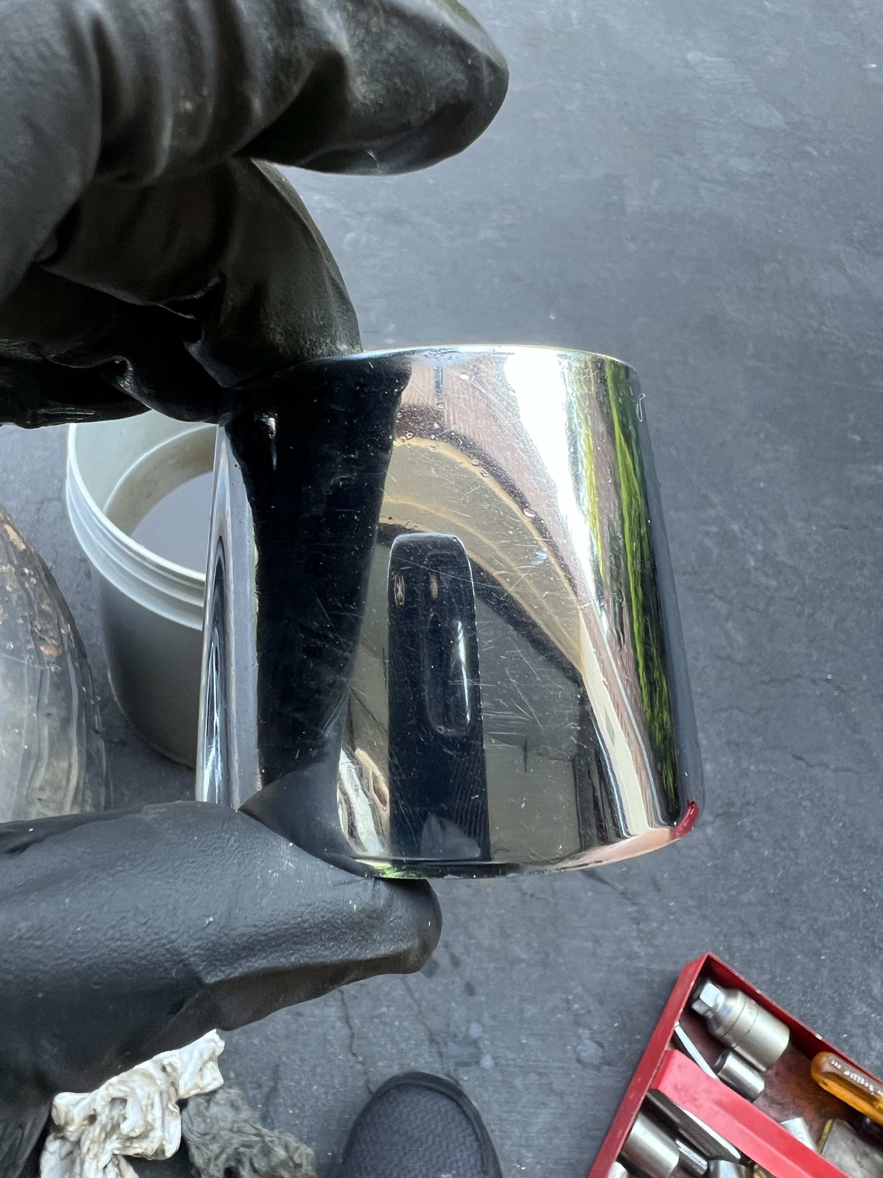

Trying to refresh the original Magnum 500 rims. What type of black should these be? Flat or gloss?

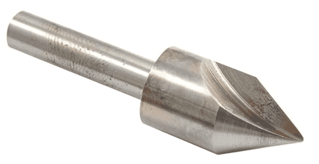

You can carefully clean up the conical lugnut seats in the wheels with a 1/2" 60° countersink bit. Link is to Amazon.
This can remedy minor seat issues but does take away a small amount of seat material which slightly enlarges the 1/2" holes.
