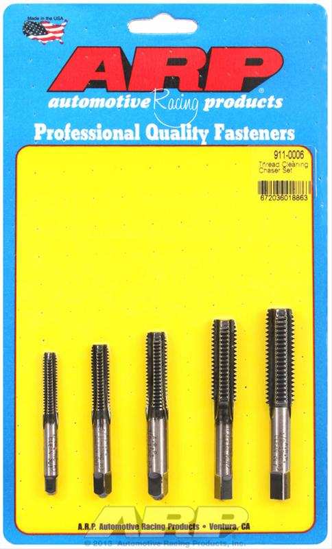

I bought these awhile back, they helped quite a bit for my engine block rebuild.
