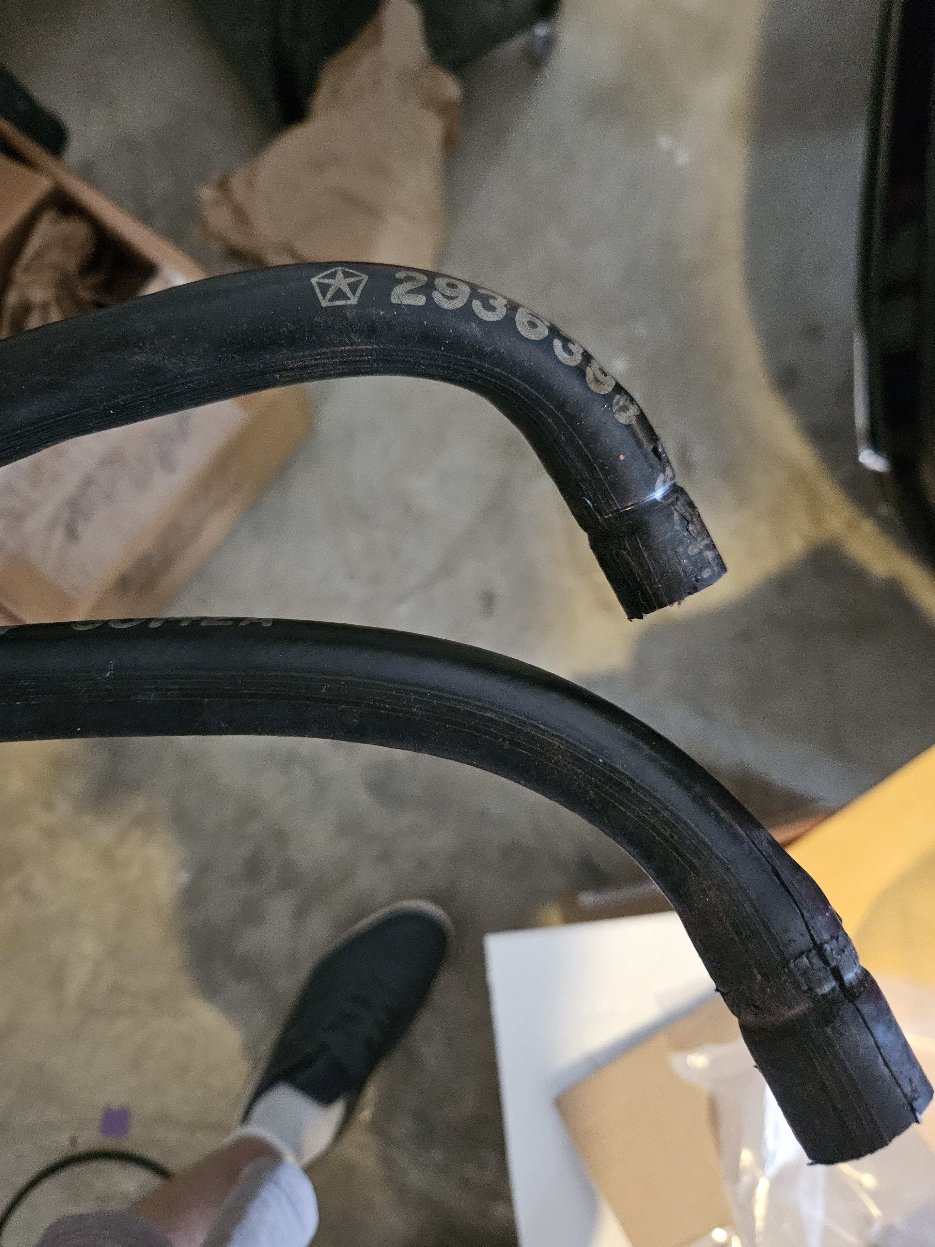

I'm having issues replacing what appeared to be B body heater hoses on my 440 R/T but the Year Ones i got
for A/E cars aren't molded like the others seem to be and the hoses kink or is it just cheap hose. There much
more pliable than the ones I took off which could be OEM as far as I can tell because there thicker and much
stiffer. I kinda sacrificed them when I was taking them off not thinking i would be needing to put them back on.

I had to somewhat, you get extra. They seemed ok until I put them in the bracket.
I even cut a little off the bottom of the nipple since I had some extra threads.
Seems like once they bent they lost there shape and the stenciling is like chalk
I got them from Classic Industries not Year One. Hoses 860457/2936 402 42095

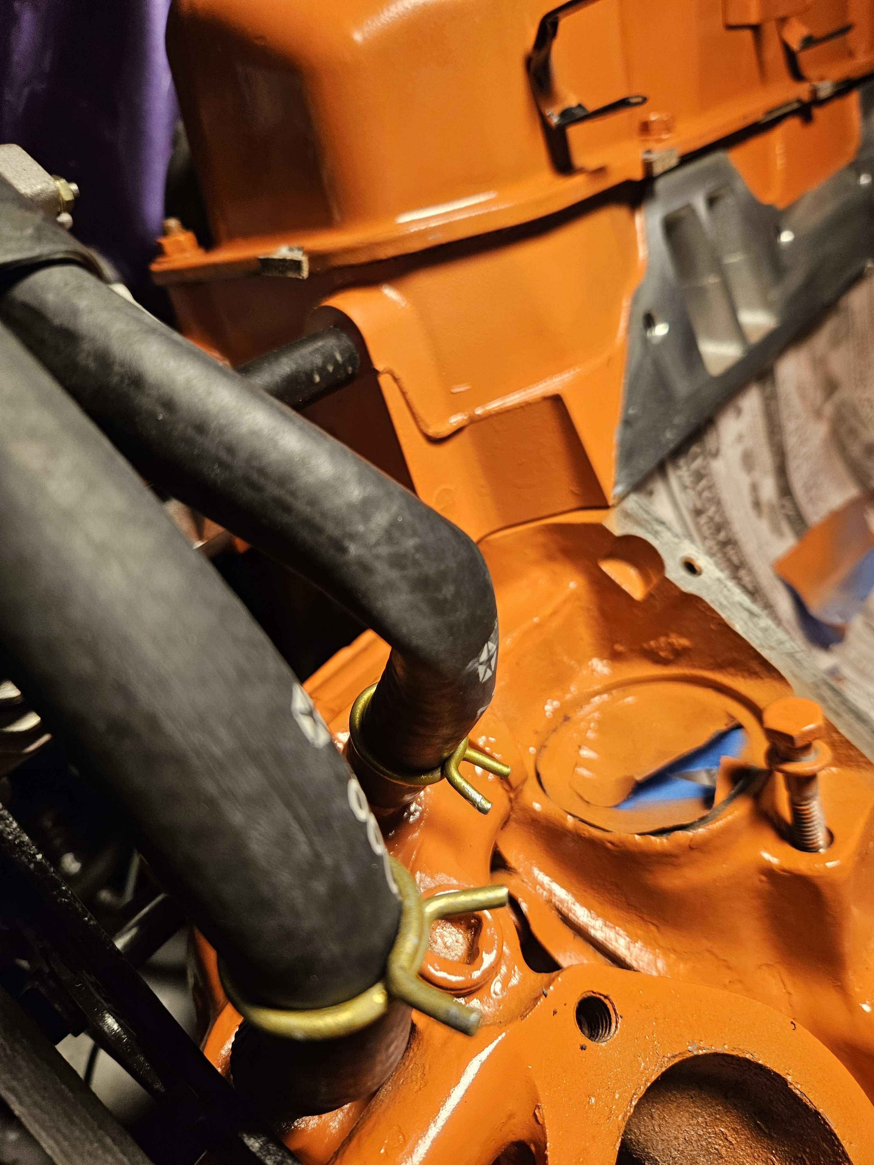

I put the old hoses back on in the hope I could get the engine fired back up and
that was more of a bear than taking them off. There part numbers are 1605534/
2936398 and are motherf****** to get on and the spring clips are guaranteed
leak free. That I have no doubt...

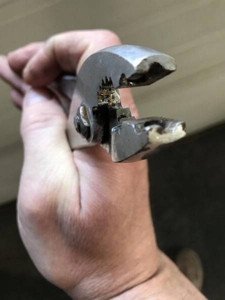

Those hose clamps are definitely leak free and factory engineered by Mooar! They go on and off best with pliers made for them! An inexpensive set of pliers can be made by getting a pair of ten inch pliers and cut grooves in the jaws parallel to the handles. See photo below from FBBO.
