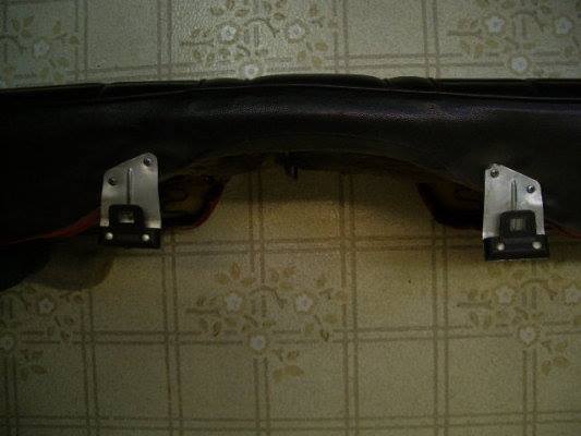

20 some years ago when my kids were little I found my rear belts still in plastic with a rubber band under the rear set.
Now they just hang over the seat a little.

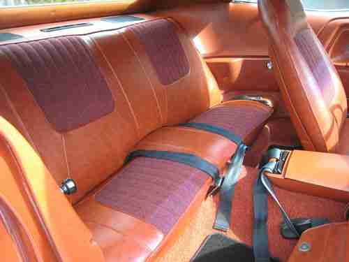

HAH! LOL! I plugged in FRONT on google and low and behold I found an entire 2 photos. One pic was not a neat installation, but the other doesn't look as bad. Still it is a poor location and design. Camaros had them but were up behind the shifter, near where the seatbelt ends sit typically. OK. That solves that.

Those belts should be orange...

I remember seeing this car on a forum. The owner wasn't trying to be 100% correct. He has black floor mats, speaker covers, and a black defrost vent also.

Were they all orange my TA is H5K4 & the belts were black from factory

I had an original '70 Burnt Orange Interior Challenger. Had Black Belts just like that one.

My 70 rt burnt orange interior came with orange belts

They are black with standard Seat belts which the pictured car has.
They are burnt orange with deluxe seat belts. They would have a button to push to release them, not lift up the whole top on a picot. You also got the dash warning light with deluxe belts.

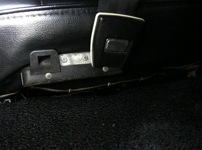

Those belts in the picture look like the deluxe (Option C15) ones, with pushbutton, and are attached to a bracket on the front of the rear seat cushion. FRont belts also had their own holders in front of each buckets, two on each side, so the pocket on the console was redundant, but the holders on the front seat are not handy to use regularely, I use the
console ones.

I have a pair of mint seat belt holders like that and I sent them to a gentleman who copied the size and everything on them and is supposed to be reproducing them.....the c15 option
