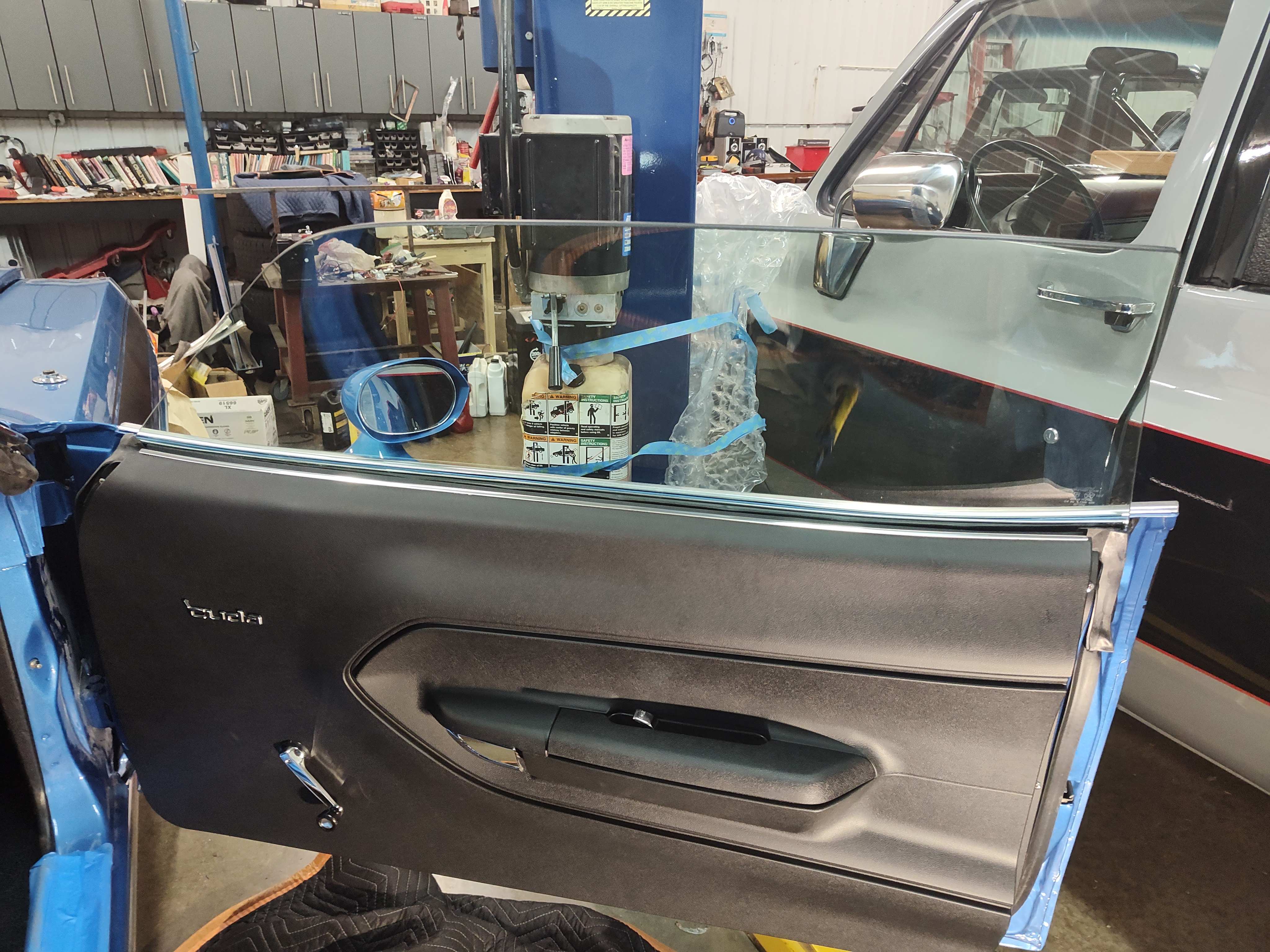

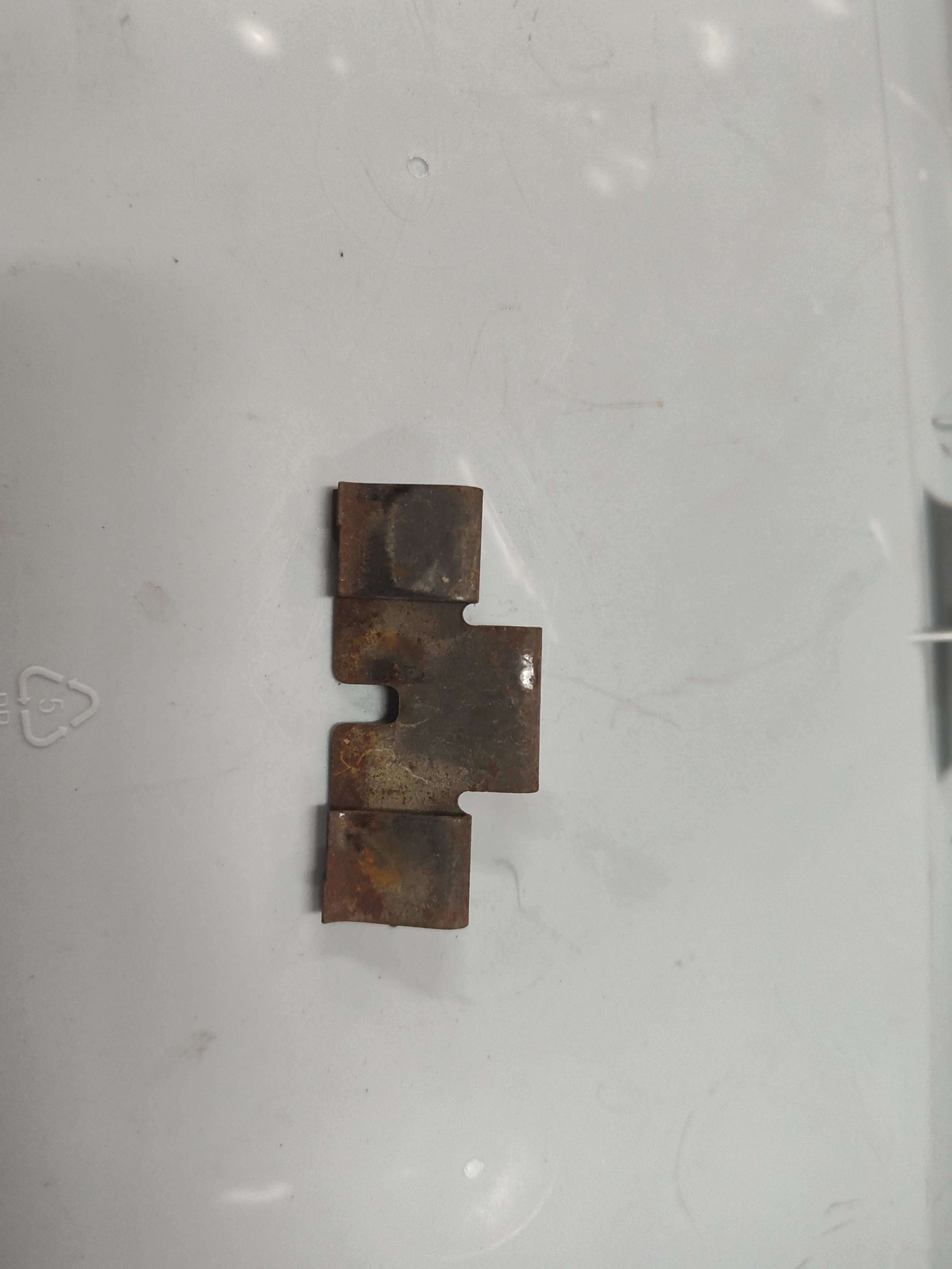

I'm getting close to the end of this project and have a clip that I need to identify and find its location. I'm in closed the picture on both sides of this clip. Any help would be appreciated. The clip was located in the parts bin for the door. There's one clip in each of the parts bins for the doors. Thanks in advance. The vehicle is a 1972 cuda

Okay well I should have looked a little harder before asking this question. They appear to be upper door panel clips and I only have two instead of six. LOL

They go on the door panel and clip over the top of the door. Three on each side . One will do.

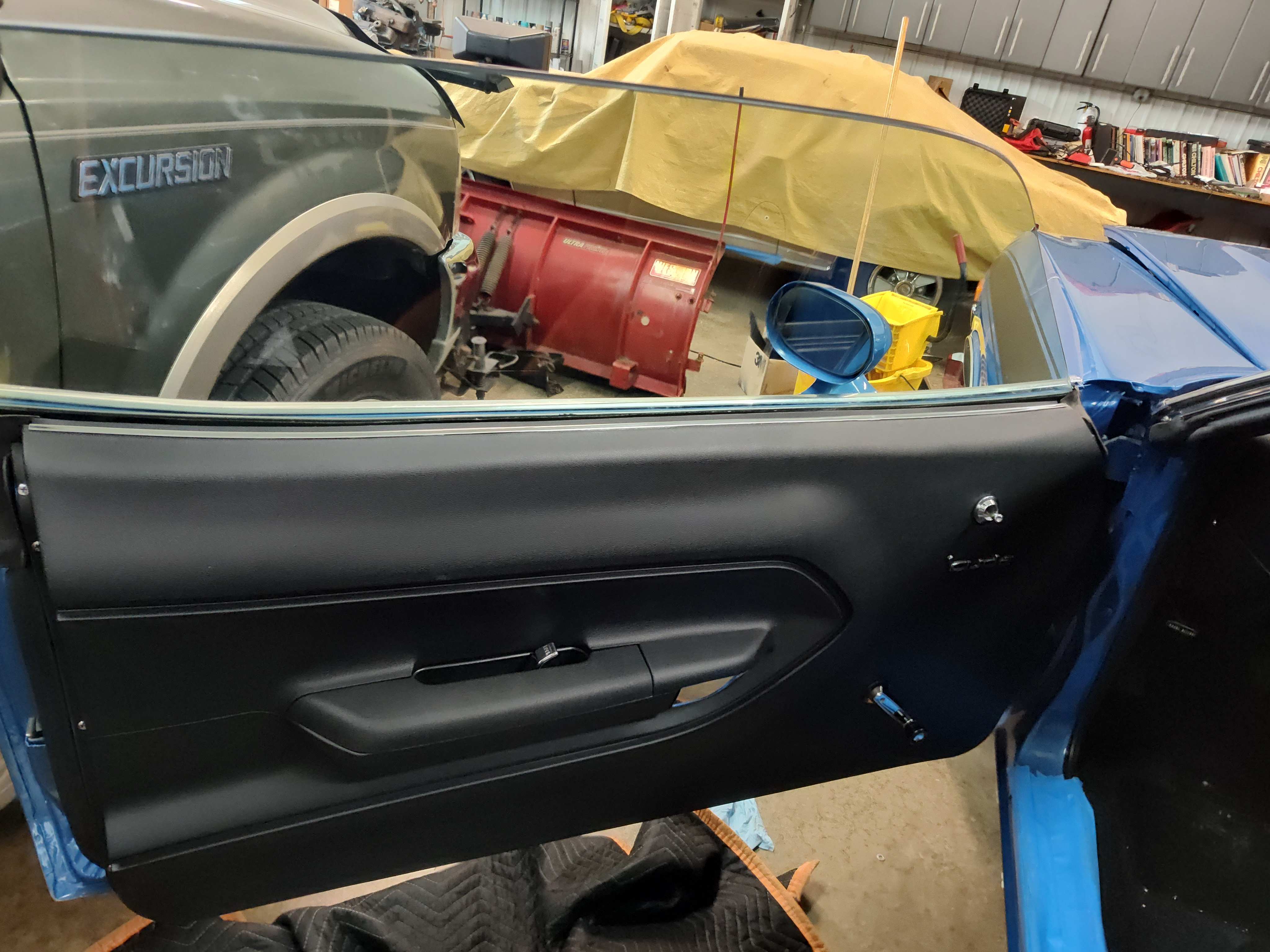

Got the doors done and I think we're about 97% done after 3.5 years. Thank goodness

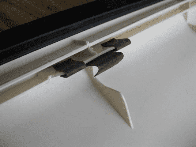

Could it be a mirror Clip? Or window Clip where when installing front window it sits on this? However those clips are longer and have Screw holes.
