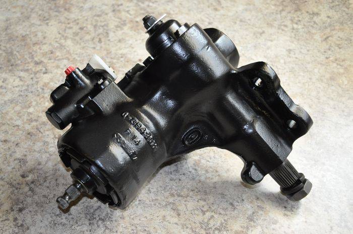

If your car is all original, you can have your original rebuilt and tightened up to three possible levels.
A standard rebuilt box would generally not be a big improvement; they were sloppy and inconsistent when new. Firm Feel can build your original.
Firm Feel Steering Box Rebuilds E-Body
Keep in that your front end should also be rebuilt if you have not done so already.
There are other options from mild to wild if you wanted to upgrade to a higher level.

More information on the FF box from their website;
All FFI Power Steering boxes are thoroughly cleaned and inspected; the cases are machined for roller bearing sector supports, and the worm gear assemblies are resized. The box is then fitted with Firm Feel's exclusive reaction springs, ranging in three steps from slightly firmer than the OE police box to two steps firmer yet, depending on your needs. All boxes are bench tested and shipped ready to install.

Remove the box and send it to Firm feel in Vancouver WA. They will rebuild it to the level of firmness you desire, Tim

You can go with the Borgeson Mopar power steering conversion boxes, you'll need a adapter. $50 off at Summit Racing with free shipping.
