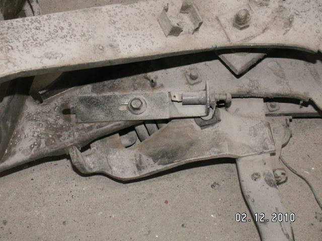

If the pedal bushing is worn the pedal will be loose and not contact the switch head like it should. Something to look at.
Dave
farmboy70
Feb 1, 2010
25
western Pa
Loosen the bracket on the pedal mount panel (7/16 head bolt) the bracket will slide.
