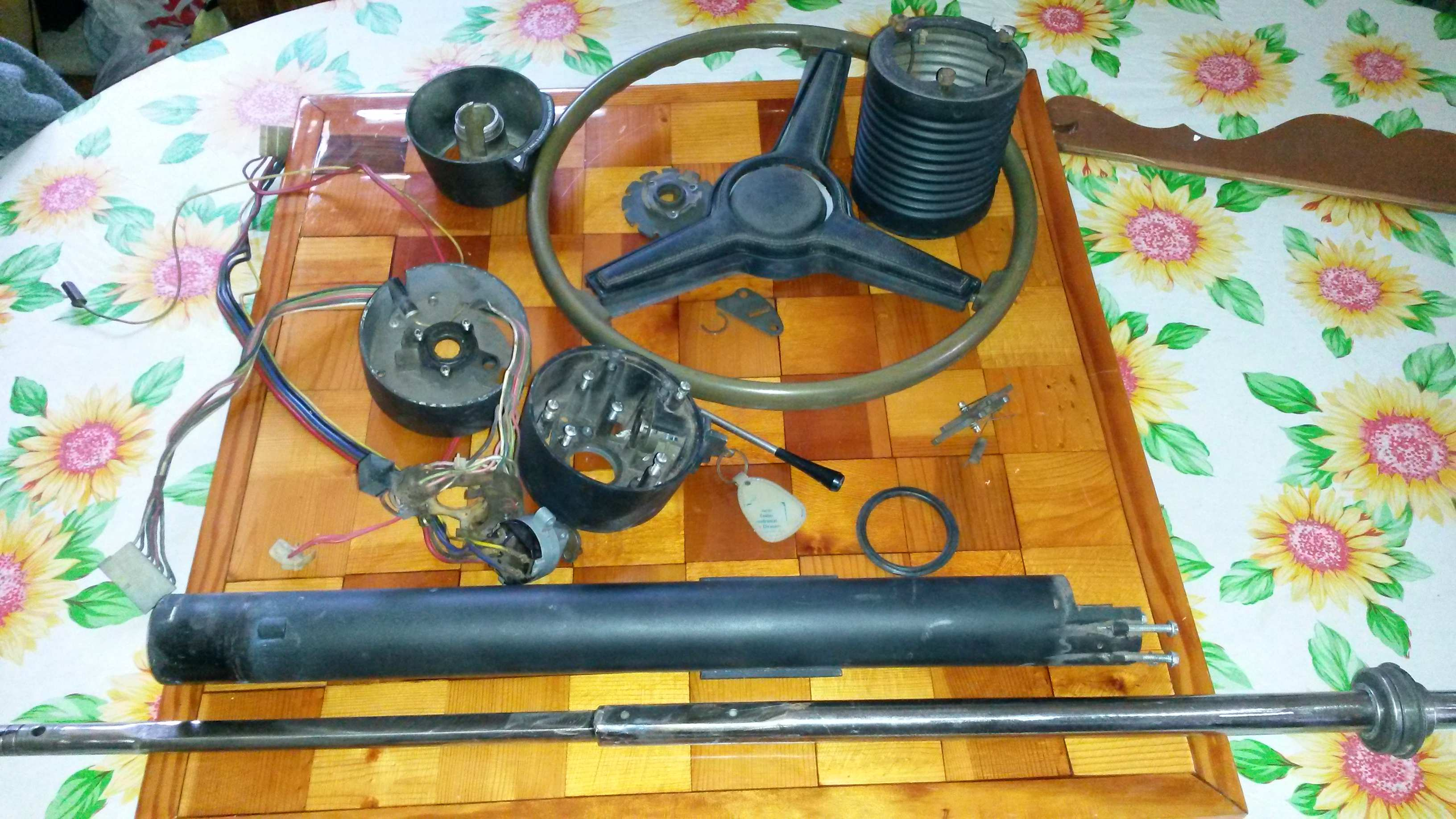

Here's a link of a member just replacing his entire ignition switch.
