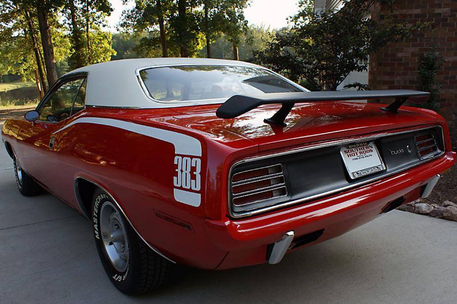

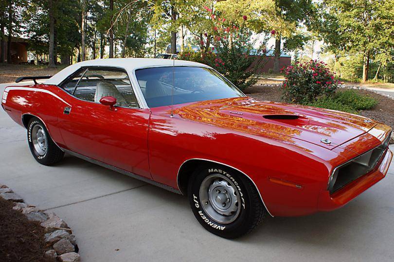

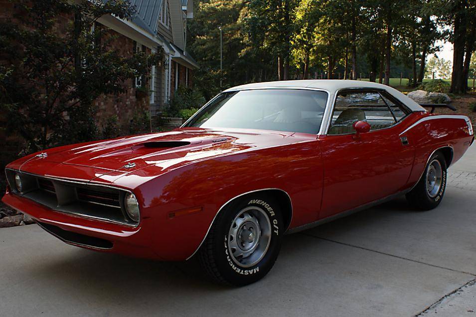

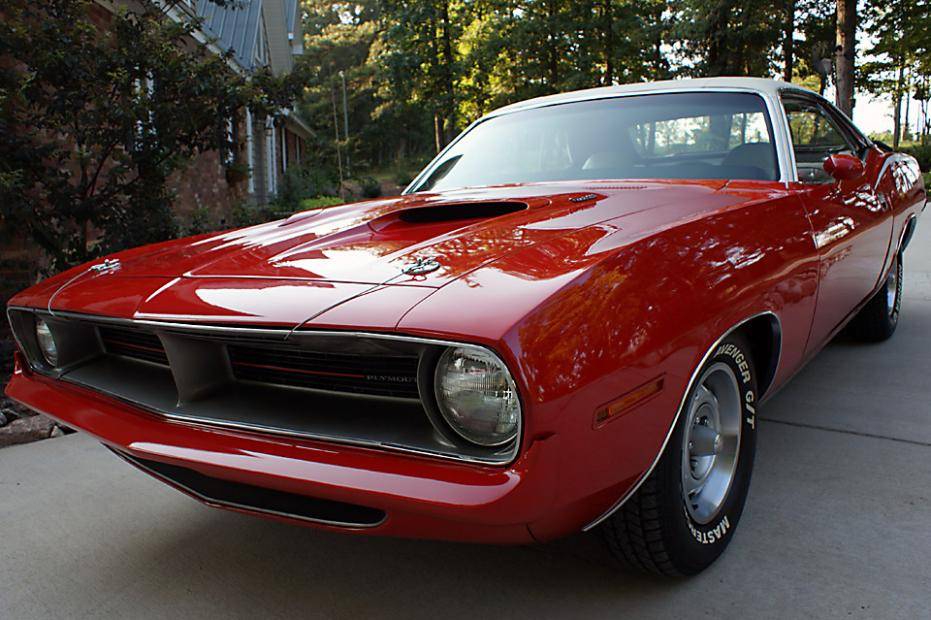

Hi There all, just joined this great forum
I have finally taken posssion of 70 cuda numbers matching 383 .
I bought the car in Georgia in September last year and due to a lot of beuracratic red tape from the Australian government it finally arived in last month
The car is all pretty origanal with an older resto there are some things i will need help on though, like the car has 2 different side mirrors, the passenger side is about 6 1/2 inches wide and comes to a point but the drivers side is about 5 1/2 inches and is sort of mor round looking
any way any help would be aprciated
thanks
Mark
ps photos to follow

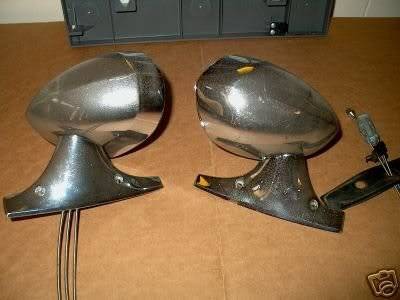

haha ... the E-Body Rallye mirror dilemma - been there, done that! hahaha

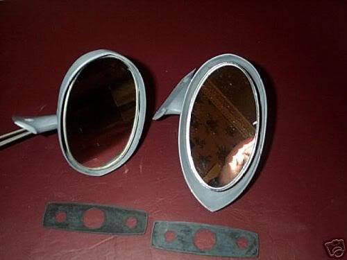

For the 1970 E-Body, the Driver and passenger side actually were different.
As you've noticed, the passenger side is a little more pointy, the actually mirror doesn't fill the housing quite as much and is a little more elongated - plus the entire stalk is shorter and the mirror sits closer to the body - this is standard for the '70.
See pic below. Mirror on the left with the remote wiring is driver-side. Mirror on the right is passenger side.
Left & right '71-'74 E-Body mirrors were both the same size - and very much the same shape as the '70 driver-side. The passenger was again a little shorter, moving it closer to the body - but the base-plate (that attaches to the car) was a little longer than the '70 model.

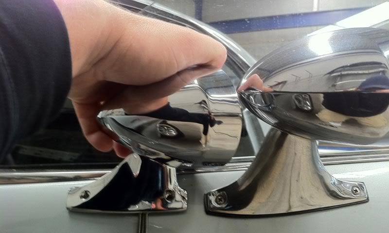

But ... you actually may not have either of the above hahaha
I actually had a '73-'74 B-Body mirror on my driver side. Similar in looks to the '70 version, but side by side you really see the difference.
The base plate is longer, taller, and the screw holes are much wider apart. The actual mirror & mirror housing itself are also slightly larger.
The one in my hand is a correct '70 Challenger repro drivers-side mirror, and the one on the car is from a '73-'74 B-Body.
The correct mirror came as a spare with the car but I much preferred the B-Body mirror that was already on there, so I bought a matching one for the passenger side.
Took me a while to figure out which was which but I finally got there. I went over to BE/A spares website (the repro company) and checked through them all until I found what I had.
Most B-Body mirrors are virtually the same, with the only real difference being the length of the base plate, and the position of the screw holes.

*** First 2 images stolen from Christer off another Challenger forum. :thumbsup:

Hey Russ, well it looks like Redcuda has fallen asleep but i'll just say thanks for those great photos and all that info on the mirrors, i certainly DID NOT know all that! wow, Chrysler certainly did things differently didn;t they! I had no idea the mirrors were designed to be different on both sides (BTW how did you find out this? As i have never read about it anywhere in any mags or forums, or chatting to people). I can maybe understand why the base stem was shorter on the passenger side, to help prevent them from being scraped from the driver not being as aware of whats going on on that side of the car...but the 70 having a completely different shape, more pointy, that doesn't make sense, although they must have had a good reason.

BTW, i'm looking at that last picture, is that your Chal... can't work out where the windscreen goes, the roof line looks like its going backwards if that is the driver side (LHS), also its seems a strange colour, faded pastel green looks like

.. and regarding the last pic. If the colour looks weird, it's just the lighting in the shop. The Colour is Cortez Silver. A 69 GM colour popular on Corvette's & Chevelle's.
And the roof-line looks weird because the door is wide open. :thumbsup:

Russ thanks for the info re mirror awsome i do have the standard set up round on the driver side , pointy on the passenger side
