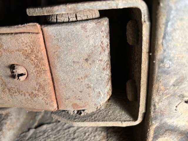

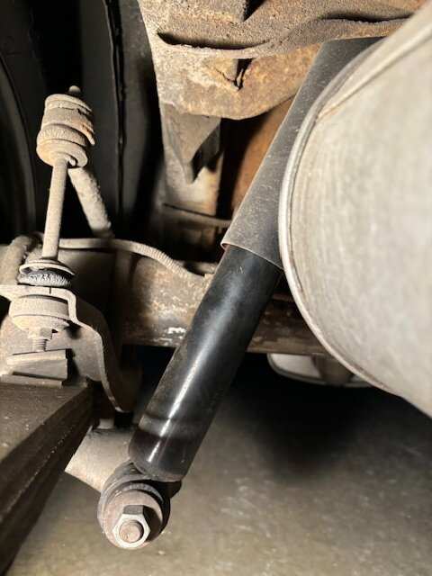

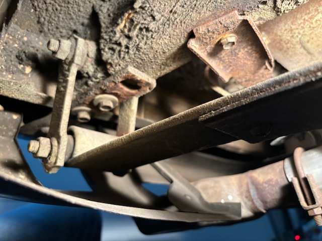

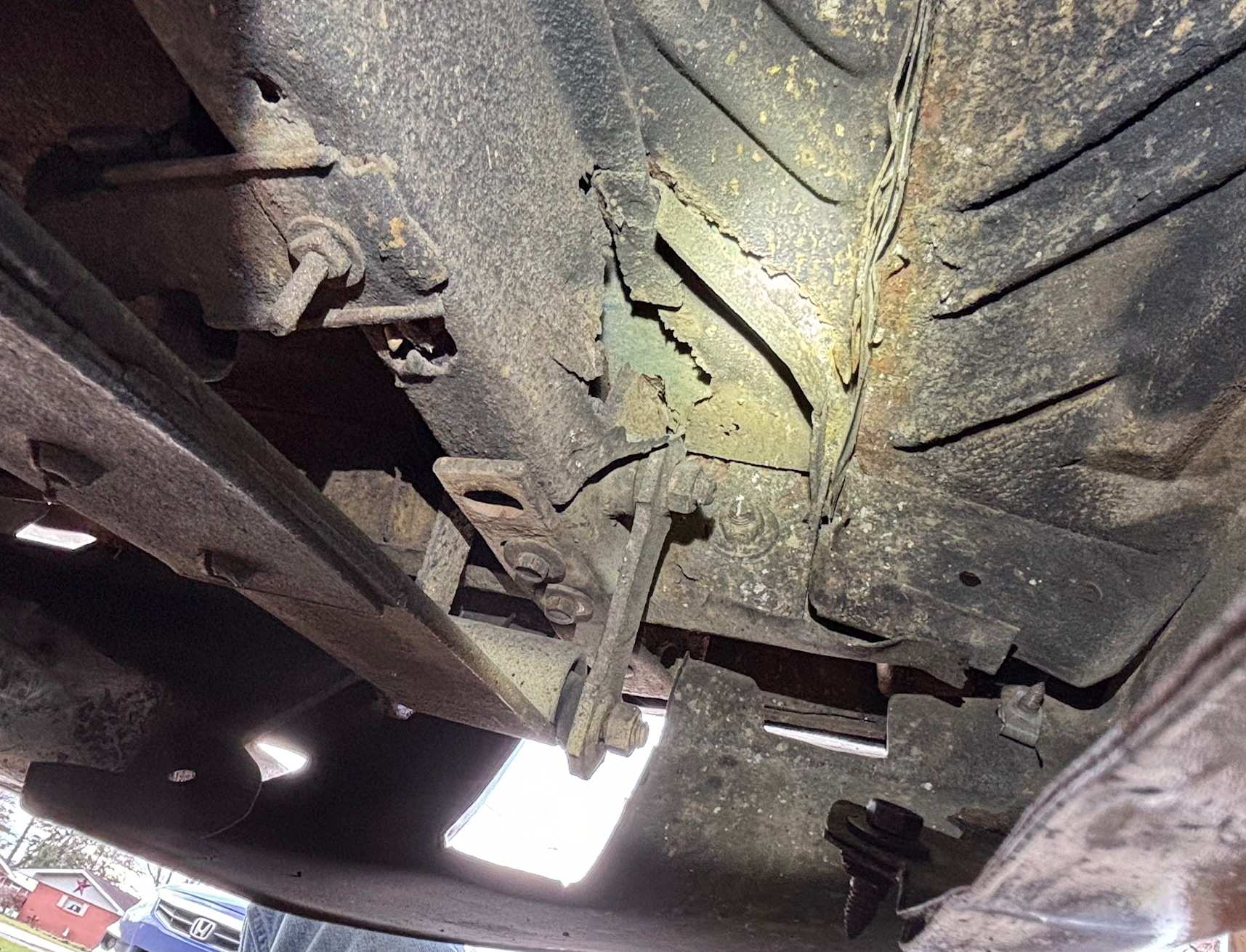

I could use some help with my 74 Challenger.

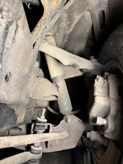

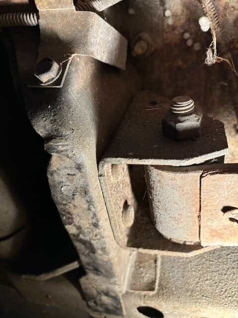

I've owned it since 75. It has original rear springs which sagged badly in the last few years. I lowered front end with torsion bar bolts to level it (probably not good in long run). HD shocks are from 1988. Got under the car and photographed a litany of sins which follow. It was originally 360 4 bbl rally, but now is a 415 stroker with about twice as much HP and torque. Still has 3:23 rear.

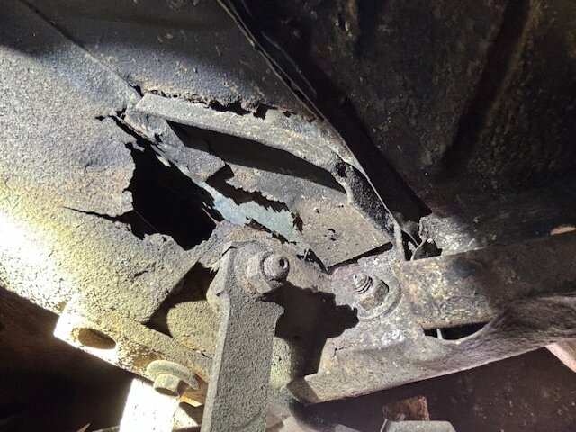

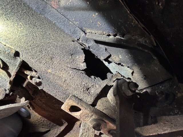

Most serious problem may be frame rusted near drivers side rear spring rear attachment (photo 2) Lot's of other issues.
14 photos in 2 parts; 1-4, 6-7,9-10 are of rear suspension
(11,13,14,16,18,20) front suspension will be sent separately, next post.
Photo No. View Parts/issues
1 left rear looking forward old shock, rotted bushings...
2 left rear looking back rear spring attachment point on frame serious rust, bolt/rubber off center in hanger
3 left rear spring front hanger sideview
4 left rear spring front hanger, underside

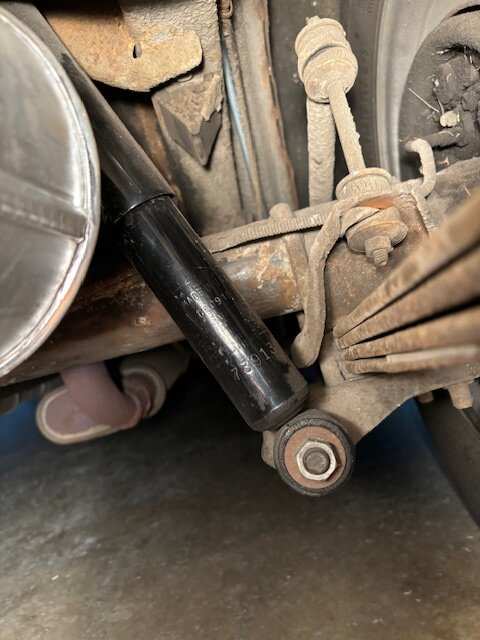

6 right rear looking forward rotted bushings, shock lower bolt off center
7 right rear looking back rear spring hanger, bushings off center
8 right rear spring, front hanger side view
9 right rear spring, front hanger underside, dry-rotted bushing
11 right (passenger) side, looking forward lower control arm, ball joint, shock (leaking?)
13 right (passenger) side, looking back L. control arm, shock, ball joints, rotted bushings, corroded upper control arm..?
15 (same) (same+upper shock attachment loose?)
16 left (driver's) side, looking back loose connections, rotted bushings, shock, lower control arm
18 left (driver's) side, looking back upper ball joint +...
20 left (driver's) side, looking forward lower control arm, shock, +...

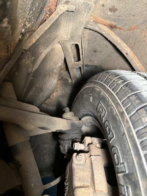

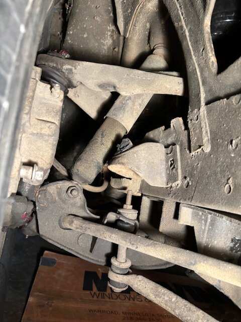

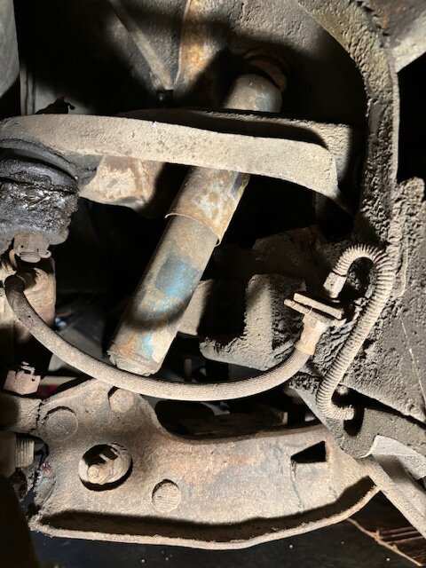

74 Challenger - suspension help. These are photos for front suspension:

Just looks like a 50 year old e body that needs some love. Obviously, any rusted out frame rails have/need to be addressed first.
Complete rebuild if it was mine. Total new bushings replaced, etc.
there are a few companies making leaf springs that can be ordered to your taste.
My opinion ( if you’re keeping it) disassemble all the suspension and rebuild/ replace what’s needed.

1) LR frame rail - would you repair or replace?

Unless you have a doner car, I think a repair cap is in order. Classic Ind. AMD possibly can sell you these.
Espo seems to be the most popular around these days. I have MP heavy duty on mine.
I like QA1 adjustable personally. There are several good options out there.
I would definitely put some frame rail connectors in while your at it.

Man, before you EVEN think about an upgraded power plant or other items, you MUST address the rot under there. To do it right will not be cheap, and you don't want to go cheap on the structural integrity of your car. Someone on the forum likely knows of a shop that could do the repairs.

I've seen left rear frame rails for sale from anywhere from $ 200-380, on eBay, JEGS, Classic industries etc. Would a cap have good structural integrity? less expensive to install? I've heard many folks speak well of QA1

I agree with Fasjac and Rick72Chlgr440, time to bite the bullet and repair/replace any structural components and replace the entire 50 year old suspension front and rear (leaf springs, bushings, ball joints, tie rod ends, pitman arm, idler arm, shocks, etc.). And definitely consider subframe connectors and torque boxes!

thats not to far from here 1975 that;s when everyone raced from stop light to stop light I got my drivers license in 76 fun times. need pics of the rust you are talking about can;t see much in the above pics and yes all the suspension parts need to be replaced;also tubler upper a arms or offset bushings in the original a arms will give you more caster and box lower arms it will make it handle a lot better

oh you do need a rear frame rail and a trunk floor extension ;they make the parts you need It;s great you are getting her back on the road again. got my cuda back on the road about 8 years ago I call it the time machine cause when i drive her i feel like I;m 25 again
