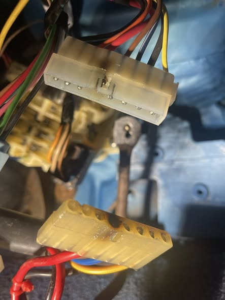

When I tried to start the engine motor would not turn over. Also no power to radio, power windows. Tried turning key back and still no interior power. Battery is good. What do I check?

It is key switch.Follow the dots. Understand how it's wired first. Blue charge circuit, yellow battery supply, red ACC circuit. Headlight sw is feed from splice one under dash.
One word explains the wiring and connections. Inadequate! Read Description and follow the dots. The wiring is not heavy enough and the connection were not designed to carry that much amperage 1:RED wire 16 Battery power yellow dot to splice one feeds fuse block, 2:charge wire 18 black wire blue dots to splice one through amp meter to red wire blue dot 16 to battery, 3:ACC feed from splice 1 Red wire Q3_12R yellow dot to steering column. Black wire 12BK red dot to ACC side of fuse box.ch load. The round back alt has an output of 37 to 45 amps max and the wiring is designed for that.

I am glad I found this post because I had something very similar to ask. I rebuilt my dash and replaced the harness. I pulled the steering column out and I had the heavier gauge red and black wire by passed the connector and looking at where the previous owner placed in and asked why. Also noticed new switches have the red and black wire not installed in the connector. I guess this is on purpose. Would installing a shunt wire help off load that circuit or is that mainly for the charging system and bulk head connection?
No, and careful with that "shunt wire" idea, defeats circuit protection for the stock unfused wiring.Would installing a shunt wire help off load that circuit or is that mainly for the charging system and bulk head connection?
