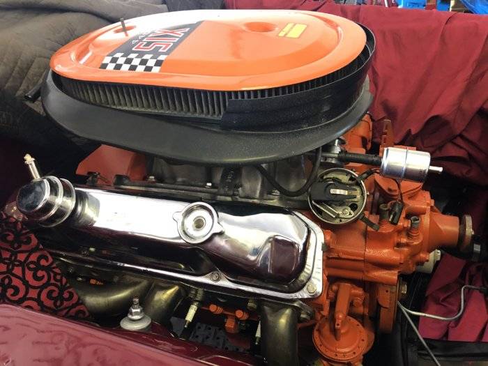

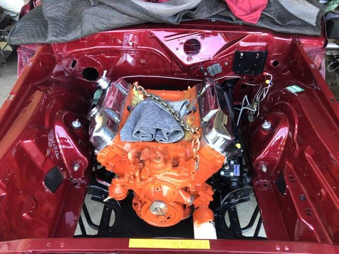

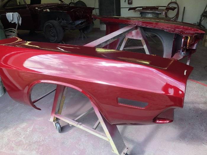

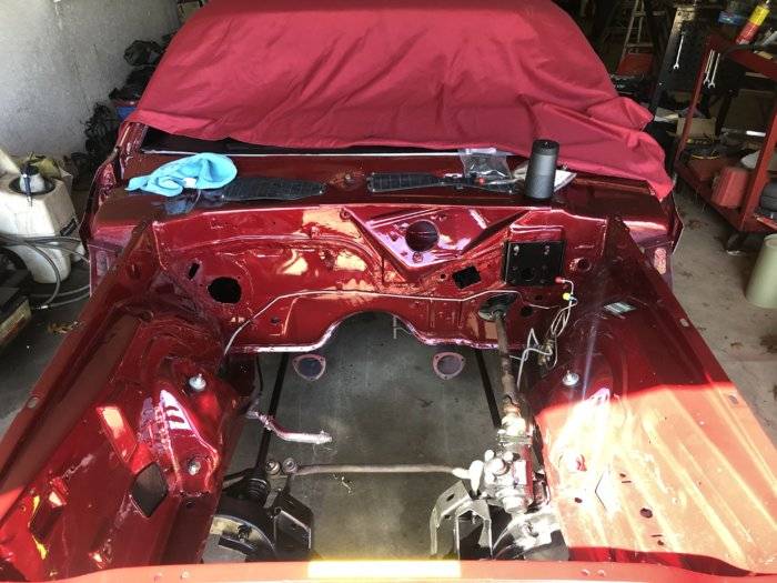

Actually it’s not Octane red. It’s a Ruby red, with House of Kolor Kosmic show clear.
Stainless brake lines are run, and Borgeson conversion is in. About to drop the engine in carefully.
Don’t look at steering sector shaft, as I pulled it today, and finished drilling the roll pins, and installed a new seal and plastic bushing, painted it. Got a Rim blow for it.

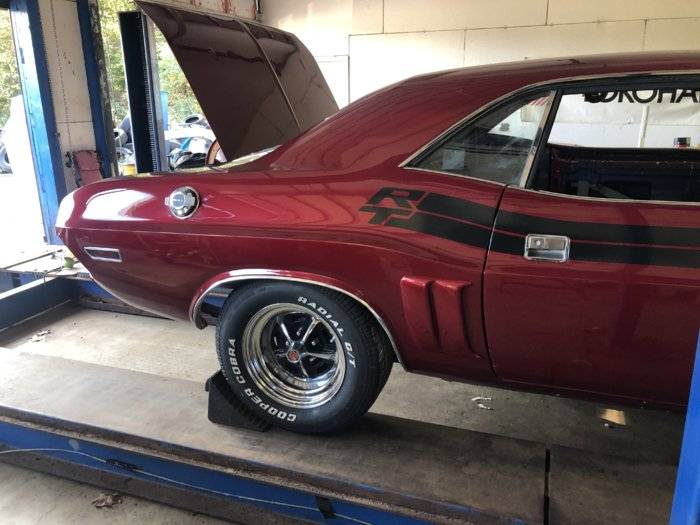

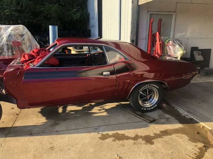

I can’t wait to see it all together, fenders on and stripes all on. It turned out way prettier than we expected.
The painter, Danny, calls me a few weeks back. He’s like you got to order another set of stripes! I’m like why are they wrong?
He says they look awesome but I ruined one side. Come down and look at it.
I probably have another week on it, and he gets it back to put the fenders, grille, bumpers, on it, buff it again.
I’ll focus on the interior and putting dynamat down, new carpet, headliner etc.. over the next couple months.

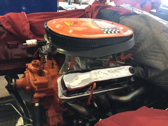

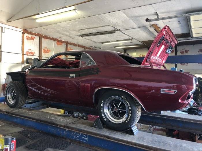

Well should put the intake and carbs on today.
Got the driveline shift linkage pretty much everything underneath done.

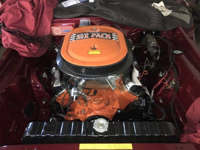

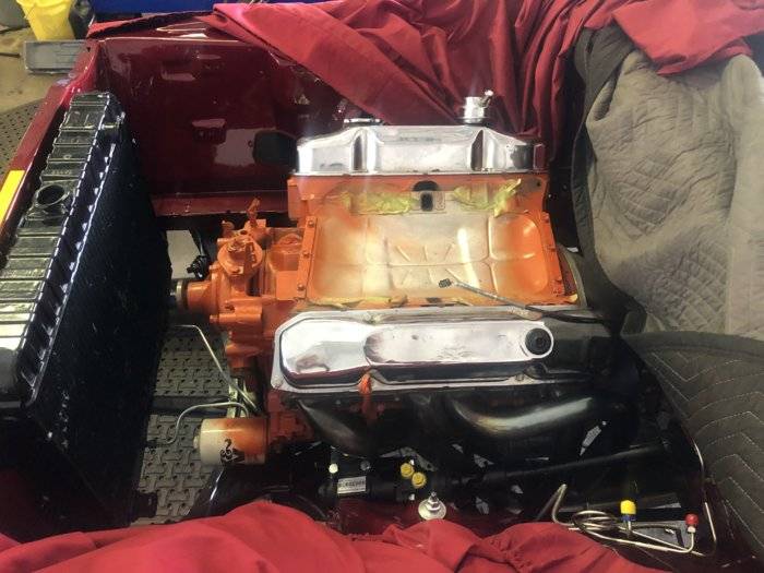

So close

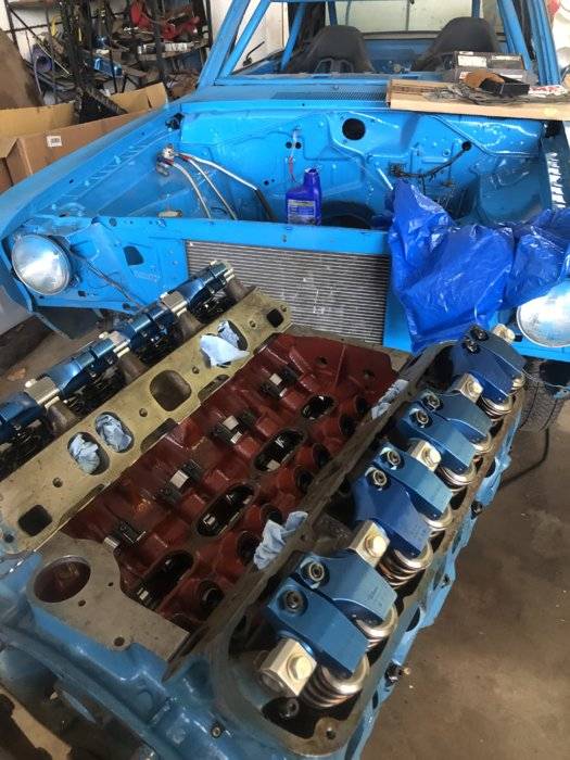

Wiring is being time consuming, as it’s getting the tape pulled off, and new fabric style tape put on. Cleaned up to were it looks nice, as it all worked and didn’t require replaced.
A water pump pulley was being a problem, as the new power steering pump belt runs where the alternator was before. It seems I had them possibly reversed anyways.
A buddy came through and we dug through his acres of mopar gold, and a 73-74 van 440 gave up its water pump pulley. Somewhat larger pulley compared to the one I had, so the water pump will slow down a bit, but it aligns perfect, but the pulleys almost touch. Hmm power gain maybe?
