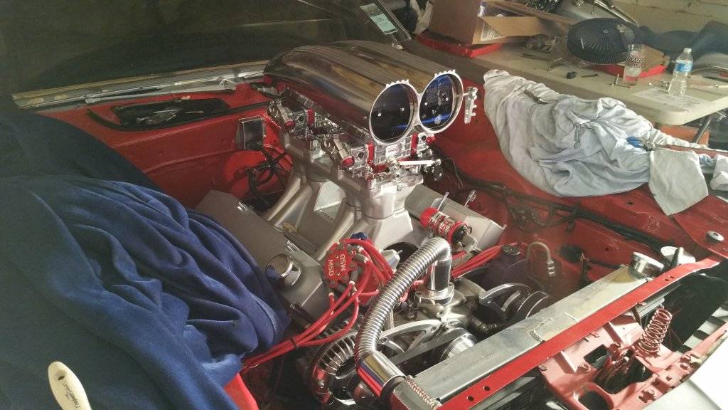

I love mine track or street. Loads up a bit when sitting so on the street i lean her out a hair and turn up the idle a tad and pow no issue...but my set up is a bit different then yours I'm running .610 lift cam, 5000 nitro stall, ported and polished everything with the biggest valves i could fit oh and 15.5:1 compression with 110 octane fuel.
That’s a bit more than the OP is running!

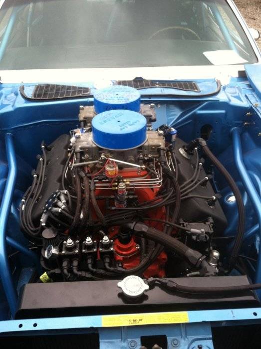

Nothing wrong with a tunnel ram on the street. Not a 440, but I run a Indy tunnel ram with two 1050 dominators on the street and spray 2 kits with it at the strip.
