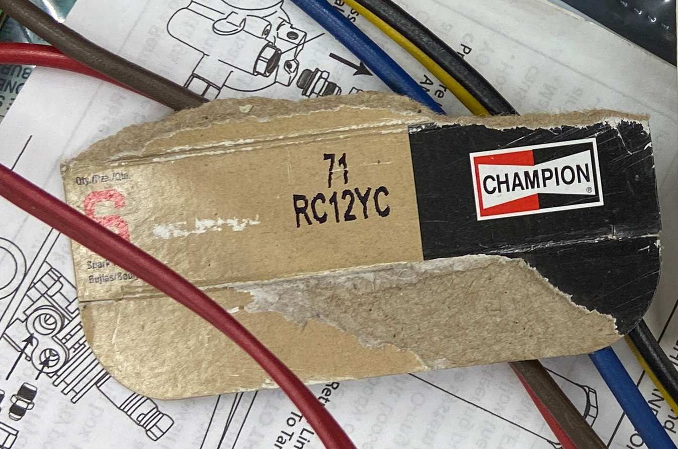

I use Champion plugs in my 440 6brrl. She starts right up and idles great. 1K miles on them so far.
Champs or Autolites
Big blocks use RJ12YC small blocks use RN12YC
big block Alum heads often use RC12YC
I've run Champion RJ12YC in my 70 Challenger 383 for years with no problems. Usually re-gap them every 10,000 miles and replace them every 30,000 miles.
Here comes the spark plug debate lol. I've used many, currently running Autolite 85s in my 440-6pack with no issues.

I'm running the Champions in my 440 with no issues at all, but I have had a few people tell me they prefer the Autolites
