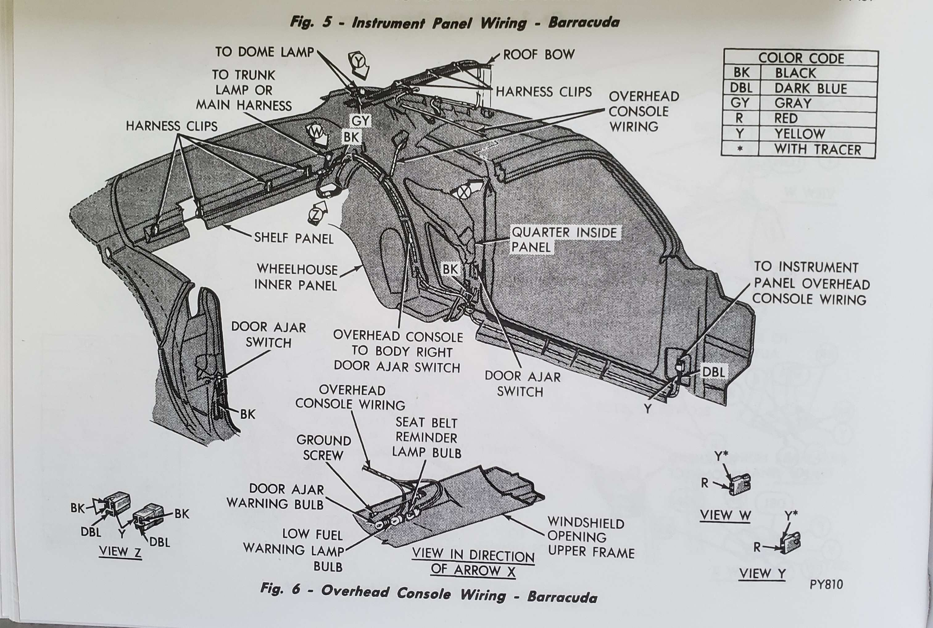

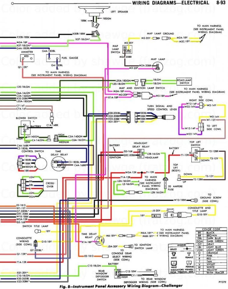

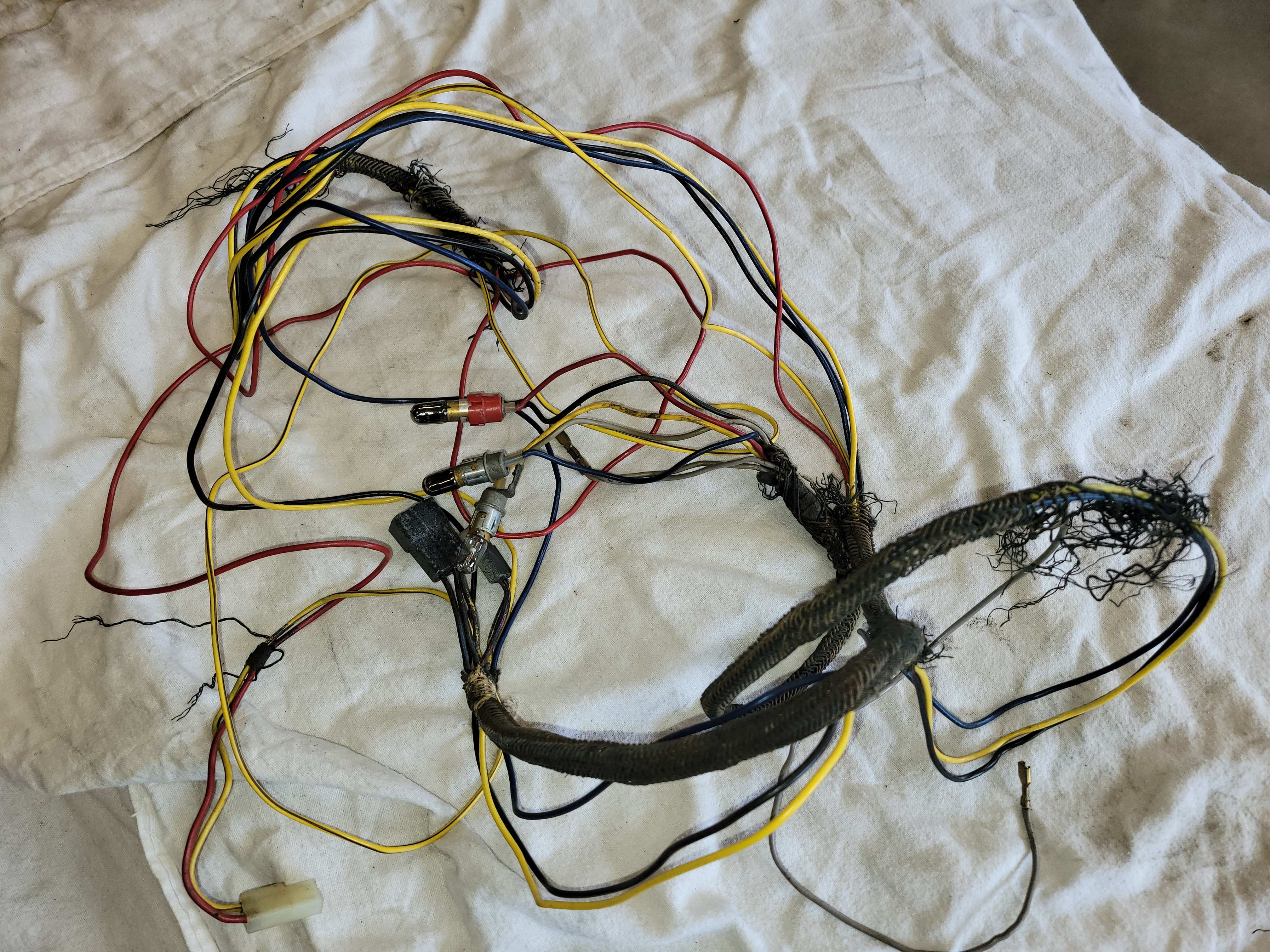

I have the harness, and the wiring diagram. Need pictures to put back together correct. Wondering if anyone had pictures of this operation?
Let me guess you headliner is in. If I remember the console wiring come out of the head liner and is clipped to it. Someone might be able to show that.

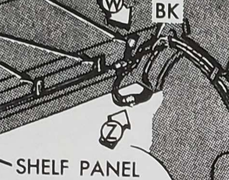

Great stuff there. Thanks. Just wondering if the harness hooks up by kick panel, or does it hook up in trunk area on taillight harness?
Look in the trunk at the wheel well area. That's where the dome light connects.
If it's not there, It needs the harness to the front.
Going to try my best to get that stuff hooked up tomorrow. Will keep you posted. Thanks again GCJ

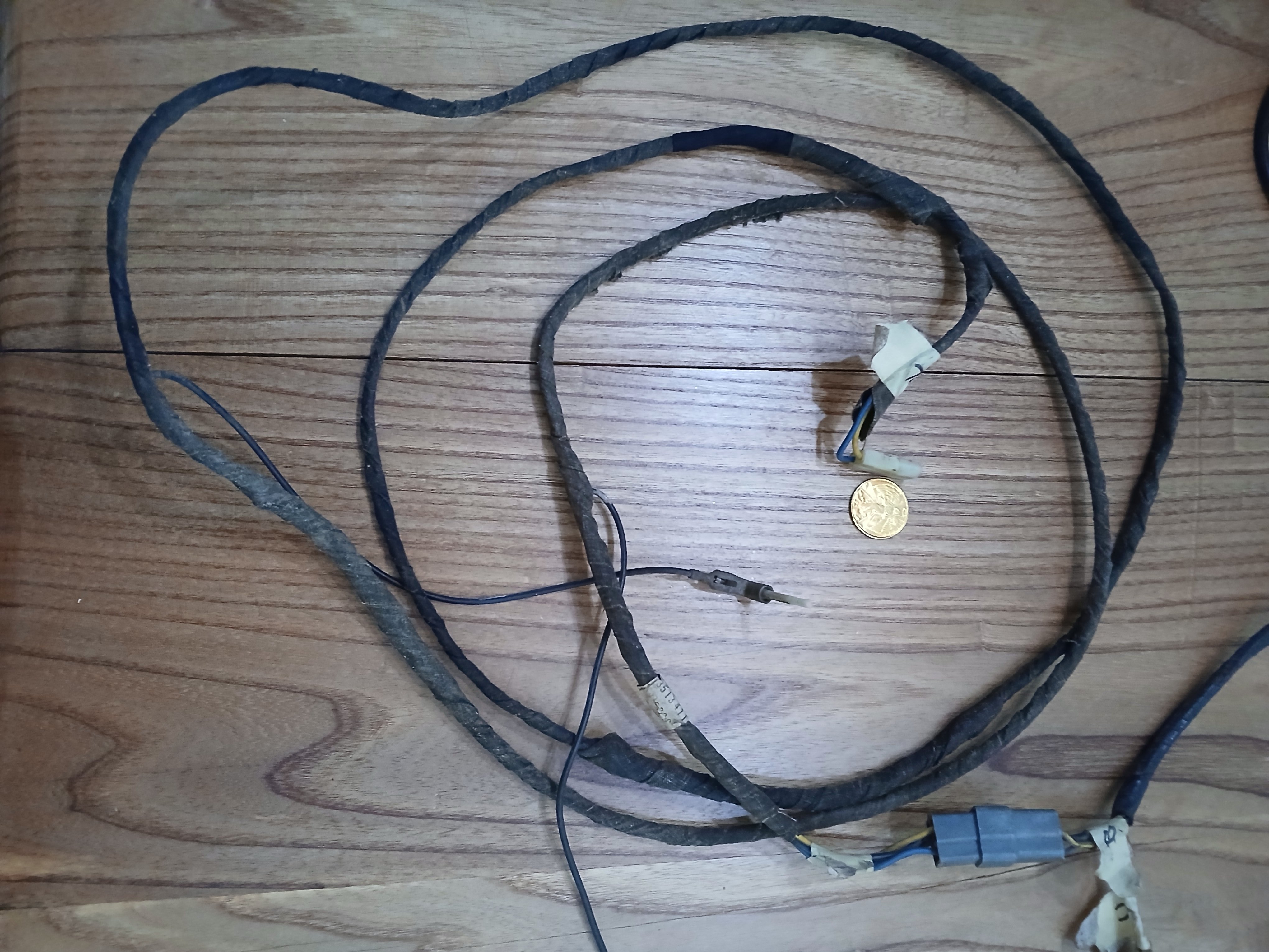

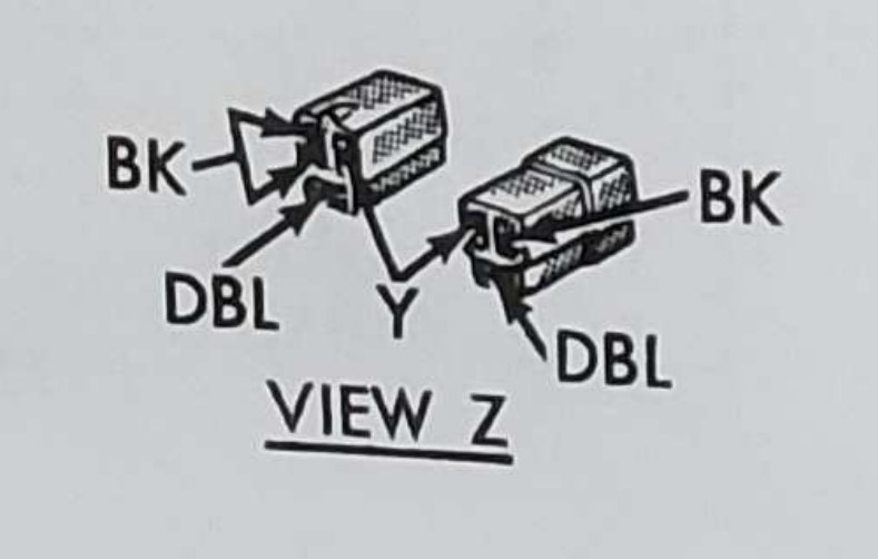

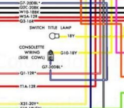

Not very good at explaining this, but here goes. The wire shown is for door ajar on drivers side. Where the gold coin is a connector. Does this connector connect to connector by kick panel on drivers side?
The antenna lead would be a tattle tail of where things go. Lay it out and see. Low fuel relay.
Thanks, I believe I got it!! Haven't hooked up battery yet. Double checking everything is correct, and grounded. Plus a little praying. Keep ya posted.
