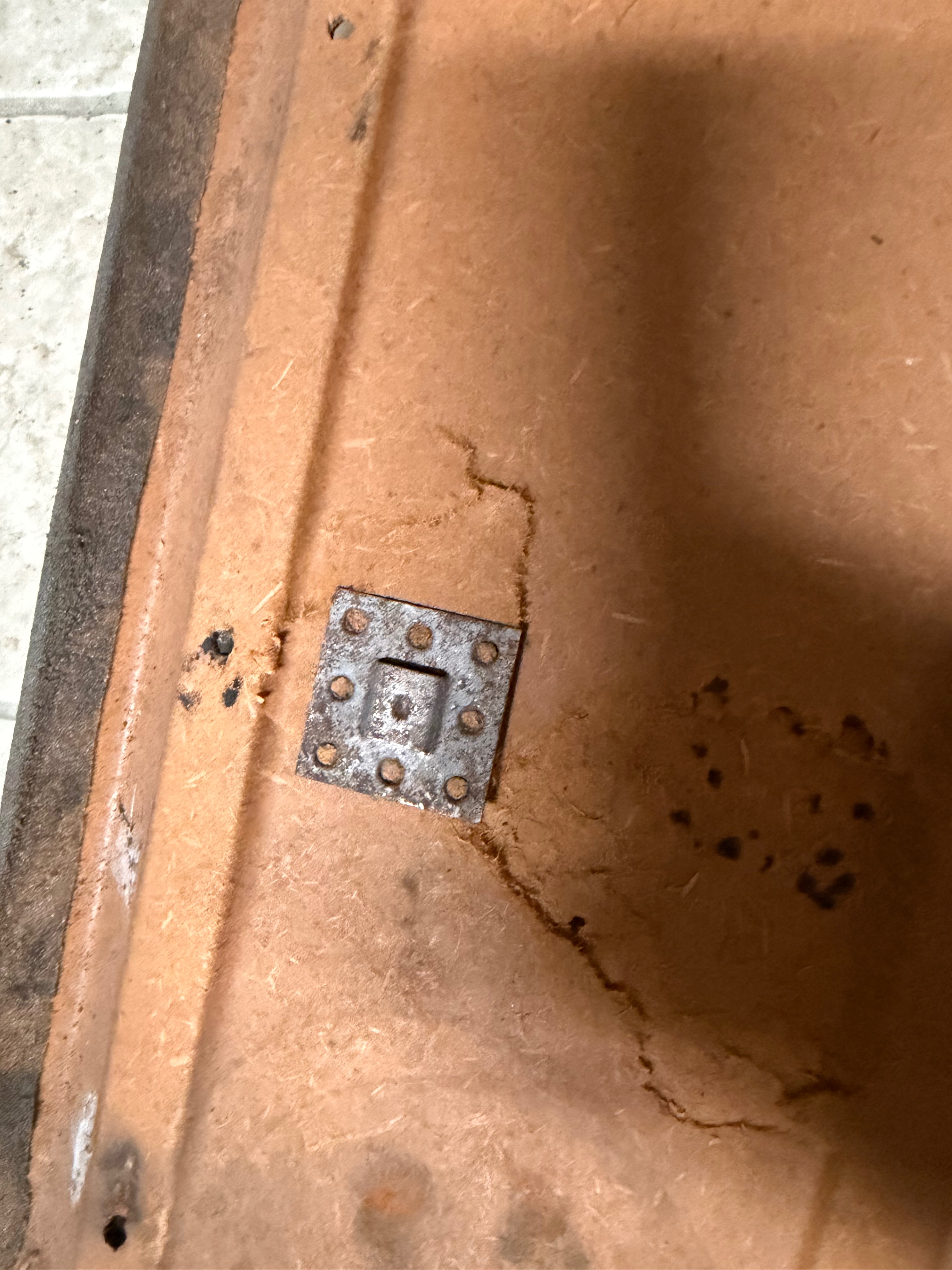

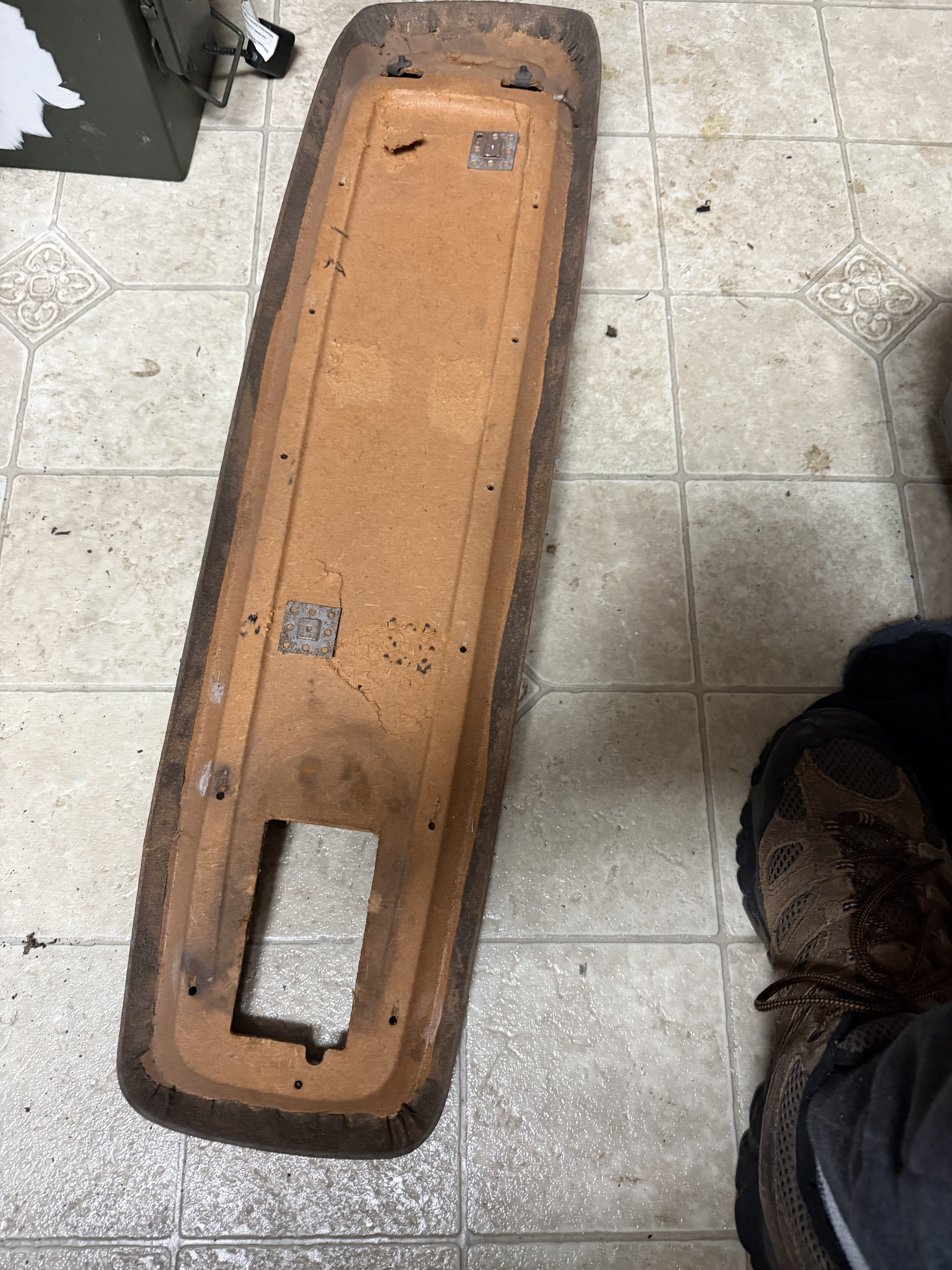

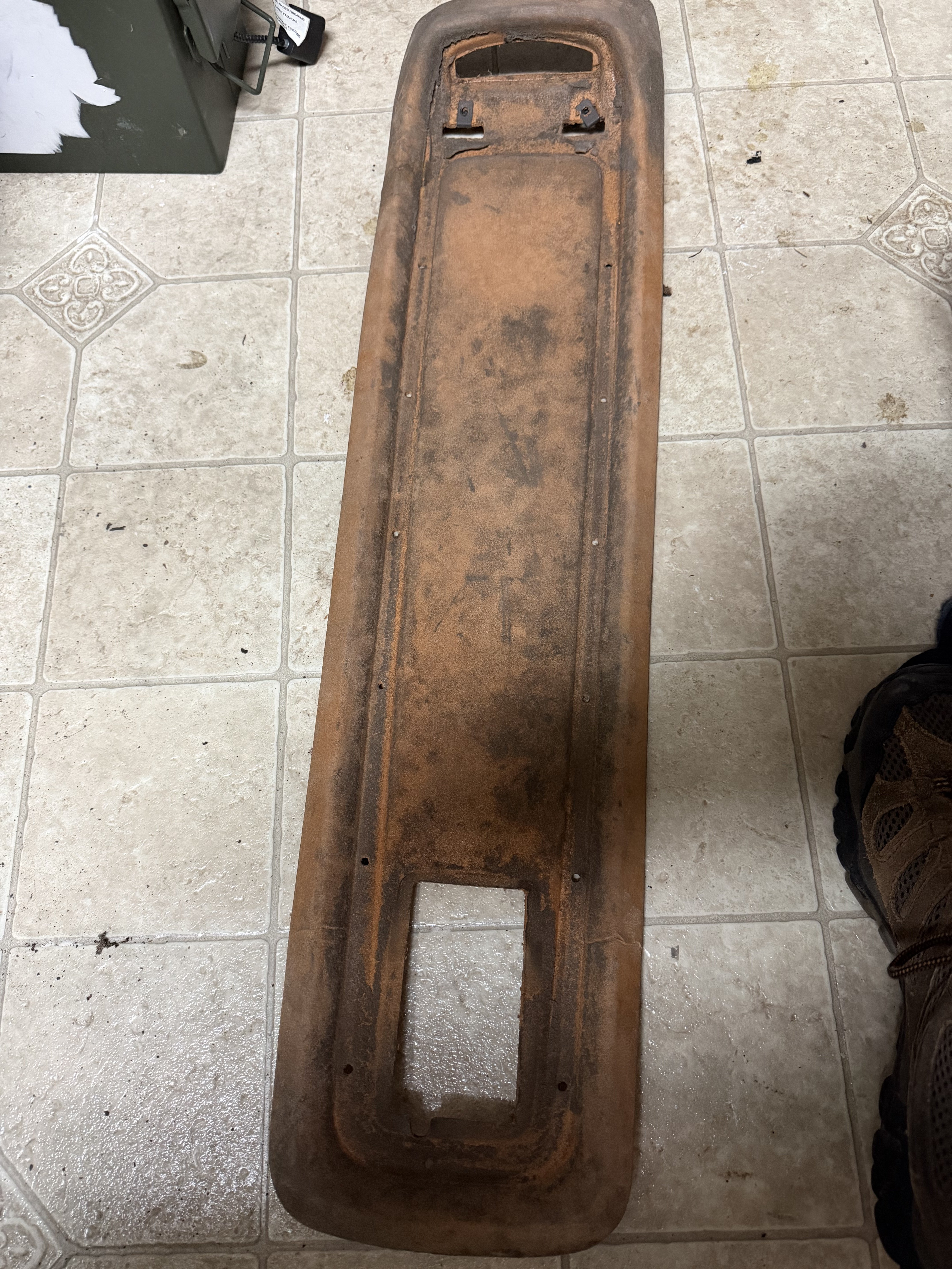

I just stripped an overhead console that I have. Not sure if this cardboard frame can be saved. Is anyone reproducing them?
Like pschlosser says, repair it. Looks like a fun project to handle. If you have the small steel attaching plates, I would use an adhesive to secure them to the console. JB weld makes quite a few adhesives that will work very well.I just stripped an overhead console that I have. Not sure if this cardboard frame can be saved. Is anyone reproducing them?
The console will probably be ok with the two you are missing but you may be able to find some online. Those plates were used on door panels as well. If you have an old shcool salvage yard near by you could check there also.I can post my progress. Unfortunately I am missing 2 of the metal squares. I assume those are used for mounting the console?

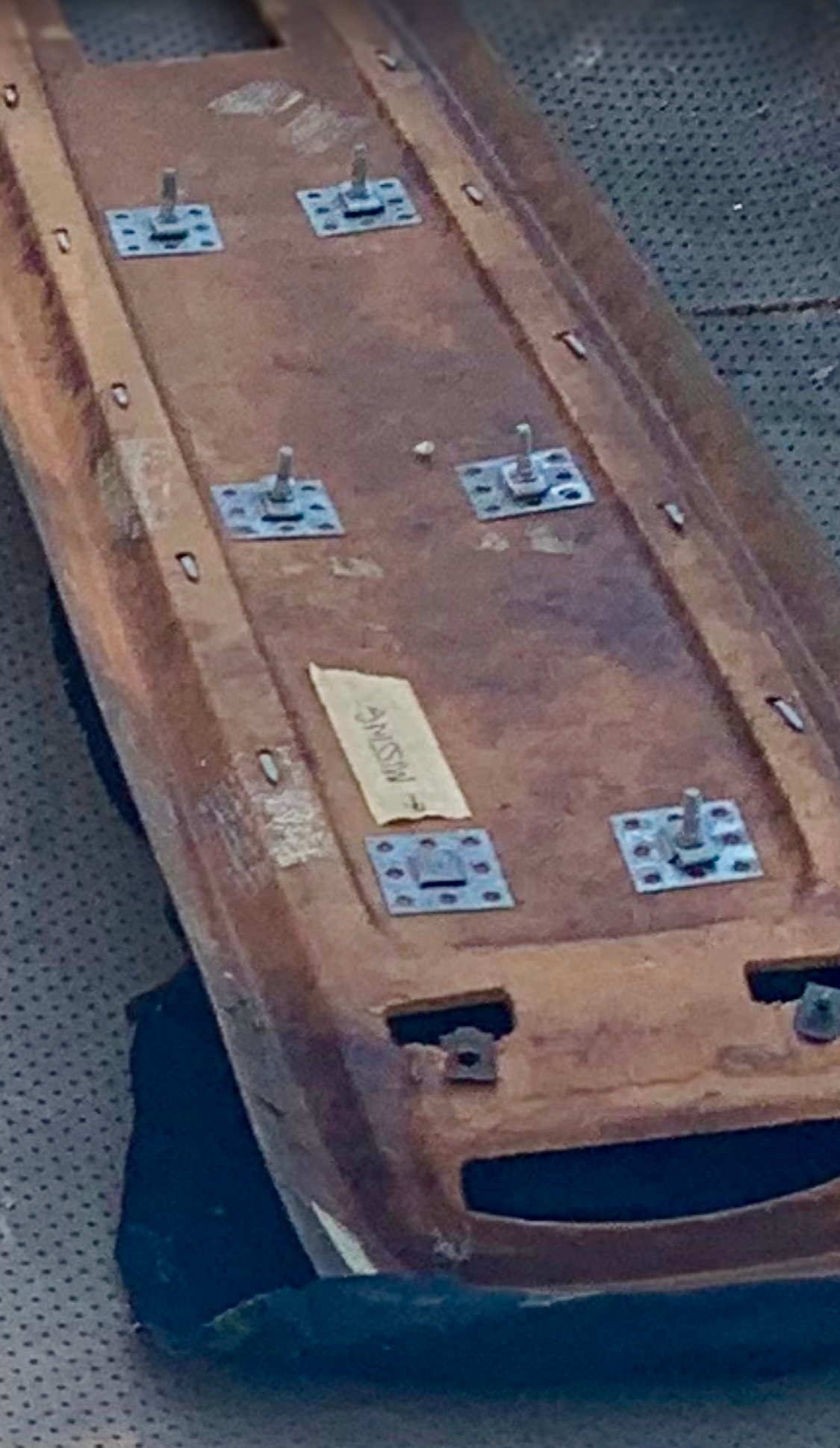

I used the plastic 1" squares you get at HDepot. Took the two sided tape off. Just like Ronbo suggested, I used the slow setting JB Weld. Be sure to let it set for 48hrs. I placed tapered screws (I think 1/4-20) in the center hole of each. When the glue sets the screws will not turn. I bolted them through the fiberglass headliner I got from SEheadliner which only had 4 holes for it. So I did not use the two spaces in the center. I tightened the nuts to get the consolette tight to the headliner - not till they stopped turning. I think it looks pretty good. One thing, make sure the material grain runs in the same direction as the headliner material. Mine was put on 90deg off. I think I'm the only one who'll notice.I can post my progress. Unfortunately I am missing 2 of the metal squares. I assume those are used for mounting the console?

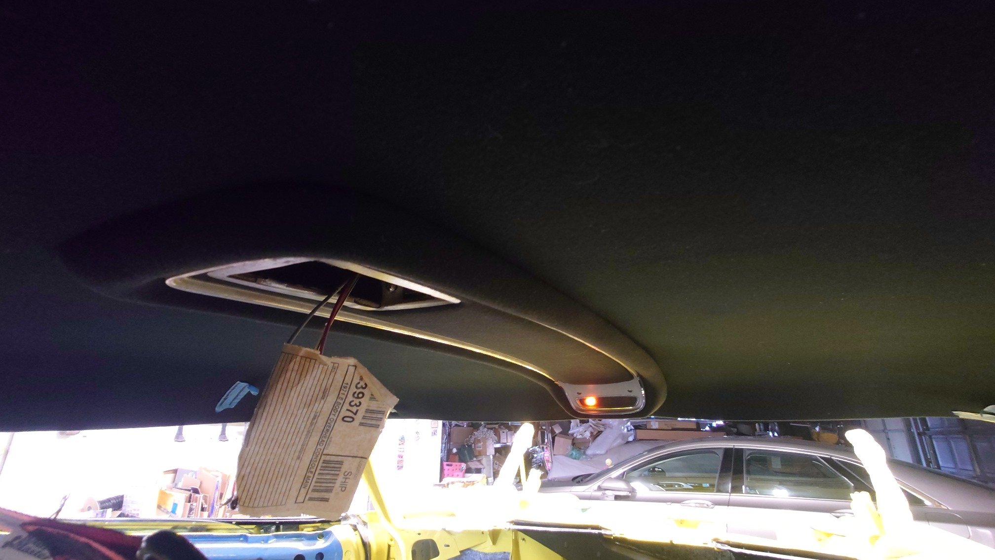

One more thing on the overhead consolette. I'm using LEDs vs bulbs for the display. The incandescent bulbs get hot and melt the display. If the OEM low fuel relay is used, that lamp needs to remain an incandescent bulb. It appeared to me that relay is dependent on the bulb resistance to work properly. I made a different electrical design using a modern day ISO relay allowing me to use an LED.

I went to his site (it's been a while). It looks like he's also remaking the overhead panel. Maybe something to investigate. I do love the quality of the headliner.
Mine was in horrible shape when removed - I did get one from seheadliners.com. It looks better than new and functions like it should.I just stripped an overhead console that I have. Not sure if this cardboard frame can be saved. Is anyone reproducing them?
