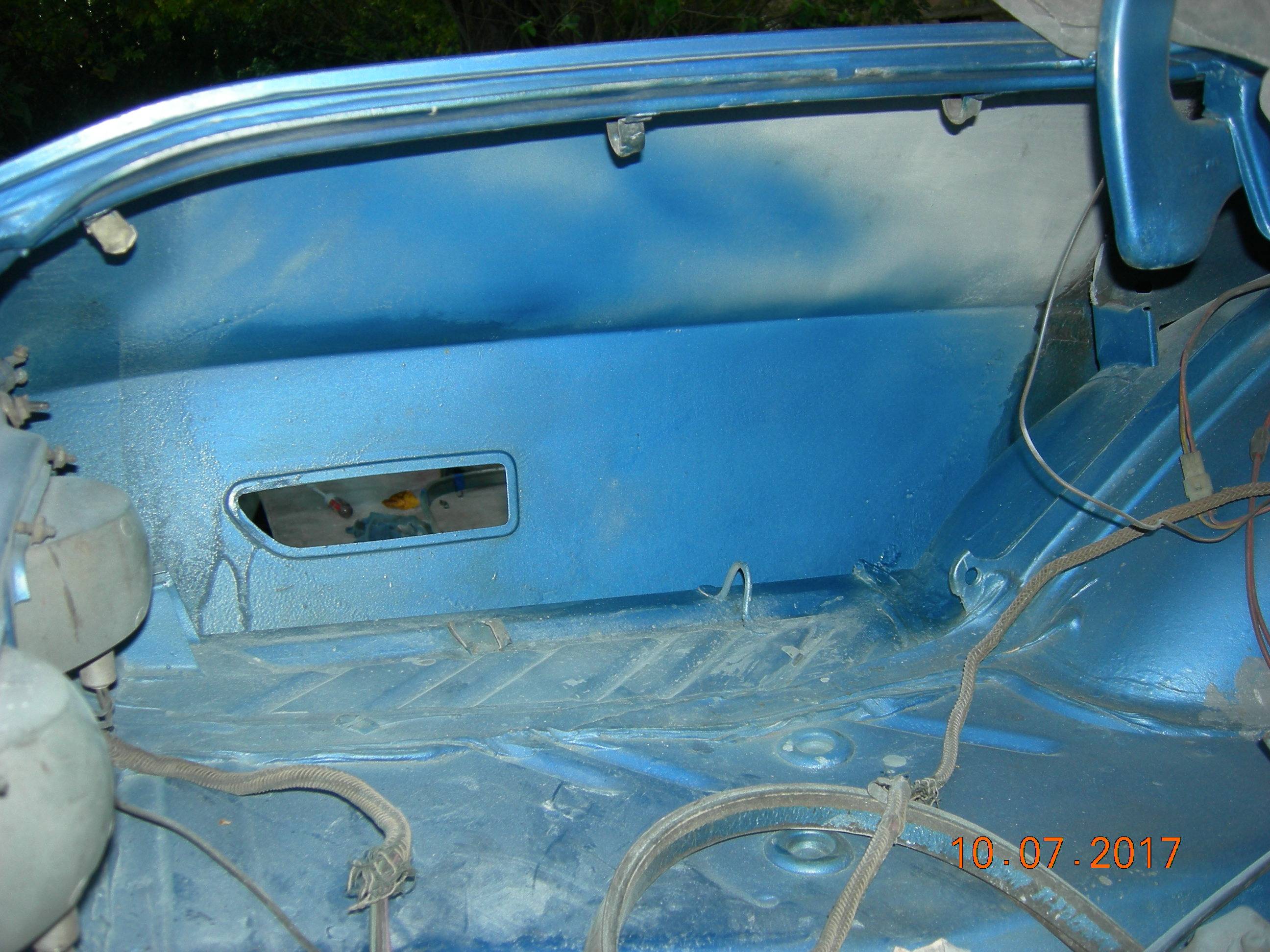

Does anyone know where the overhead light's wire connect into the wiring harness. I don't want to pull the car apart to replace the light assembly. It's shorting and running the battery down.

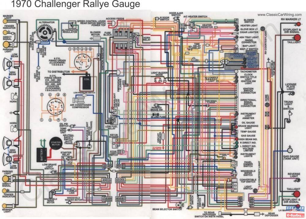

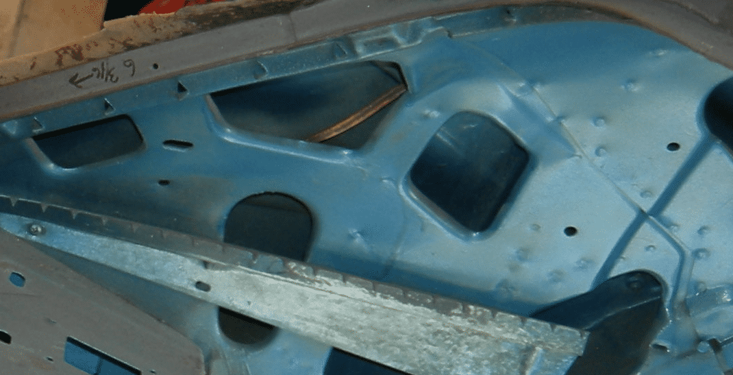

The dome light runs on the driver side and up the sail panel to the roof.

It looks like it is the connection on rear fender well in the picture. I looked at a wiring diagram couldn't relate that to the car exactly. Thanks so much for the picture.
