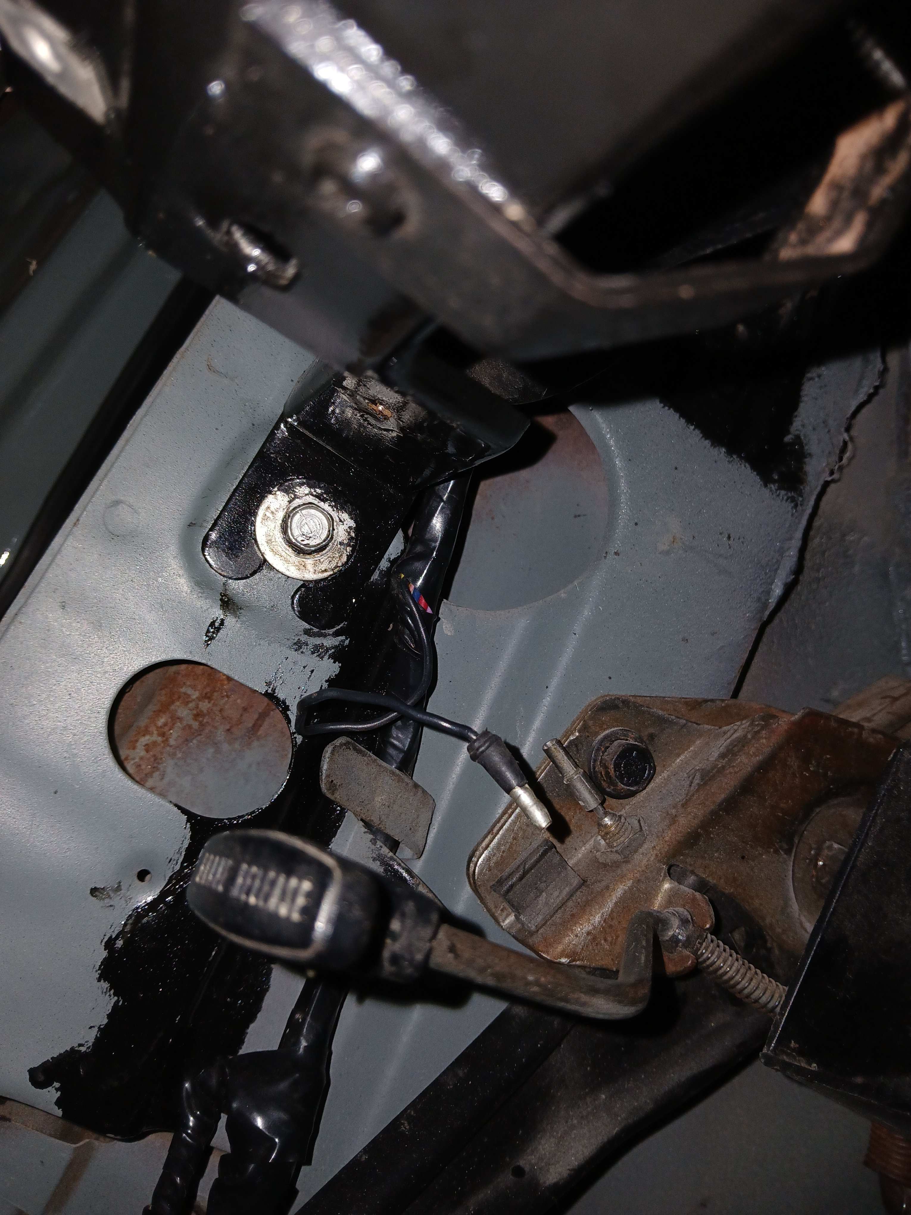

Hi, my first question on the forum. I am about to reconnect my parking brake switch and wire for the first time in probably 20 years. The photo shows the switch at the center and what I believe is the correct black wire and male connector, looking at parking brake assembly with switch from under the dash. A previous thread is helpful in identifying the correct wire, but does the male connector just insert into the hollow tube at the top of the switch? Or is there something I might be missing? I don't want to break anything while trying to jam the connector in.

Yes, just plug that male wire into the connector. When the brake handle is pulled the socket makes contact & is grounded thus completing the circuit. It should activate the parking brake light on your dash.
Great, thank you! Couldn't get to it today but should be able to tomorrow. Getting ready to reinstall the standard gauge cluster and switches after repairs and some refinishing.

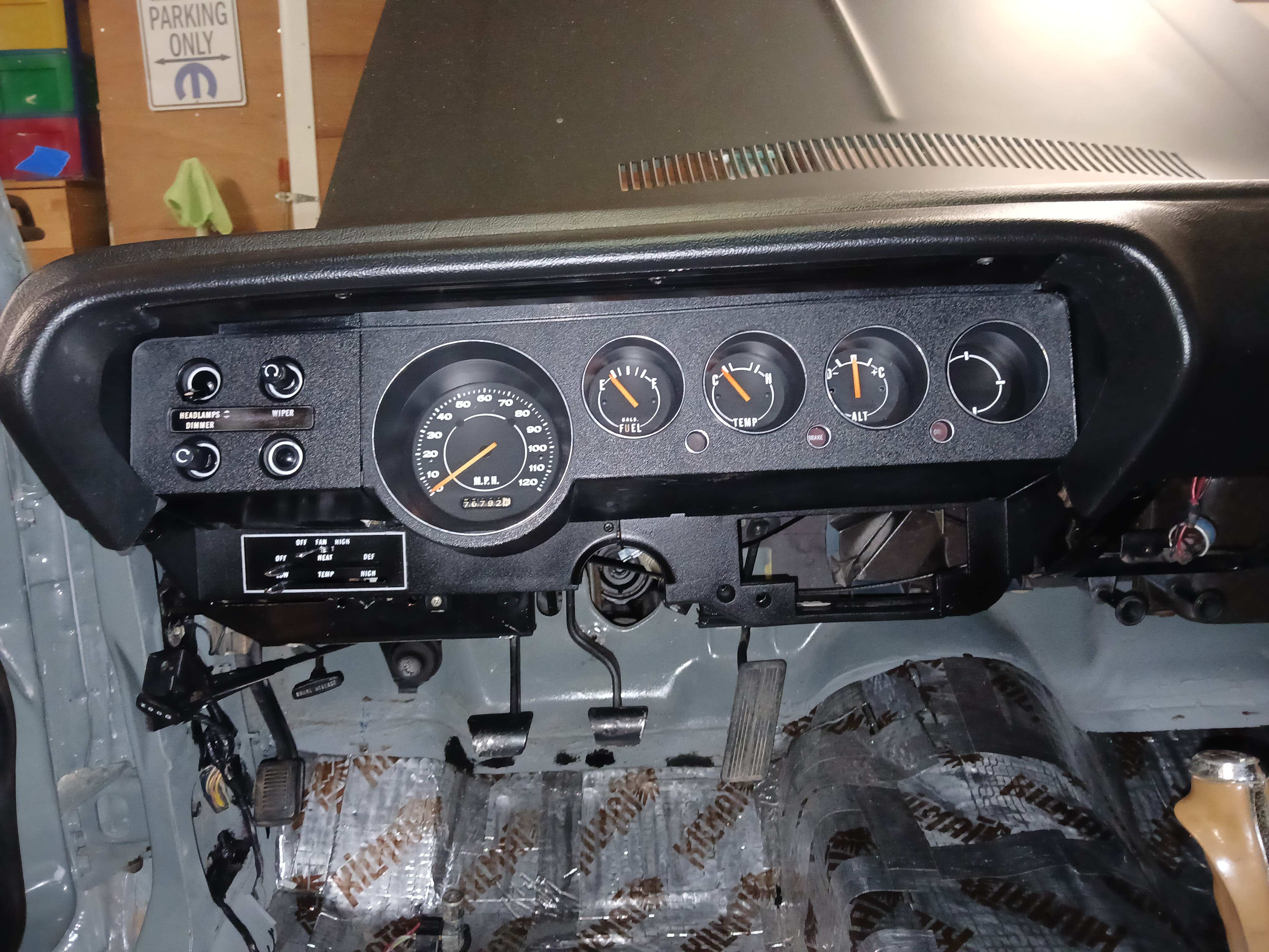

OK, the parking brake light connection went fine. Thank you! I hooked up the brake light switch at the same time and today installed the original standard gauge cluster that came with my first Challenger, a 72. I thoroughly cleaned the cluster housing, touched up a couple of gauge rivets that had corroded, and polished the clear gauge lens with plastic polish. I have one of those kits for polishing plastic headlights and the polish that came with it worked really well. The lens was really nasty so I hit it with 2000 and 2500 grit sanding pads first. I cleaned all switches and gauge connections as part of this task.
The plastic bezel housing is near complete. I had to fix a crack with JB Weld epoxy for plastic, touched up with black wrinkle paint. Tomorrow I will paint the gauge surrounds with a liquid chrome pen.
I have a complete rallye gauge cluster from a parts car I bought (and sold after taking key parts) but I anticipate it will take a year to restore it, so this panel will do for now. Steering column going back in next week.

Well done! Looks great!
Wow, installing the plastic bezel and light bar ended up taking around 3.5 hours today; very fiddly to get the screws lined up with the metal tabs they screw into. Also, the plastic is now 50 years old and brittle. I had to repair a couple of cracks with plastic epoxy putty and repair a small plastic tab that broke off the bottom of the heater control unit when I was inserting a screw. I was not even cranking it down hard!
I will post follow-on photos in a new thread under restoration progress.

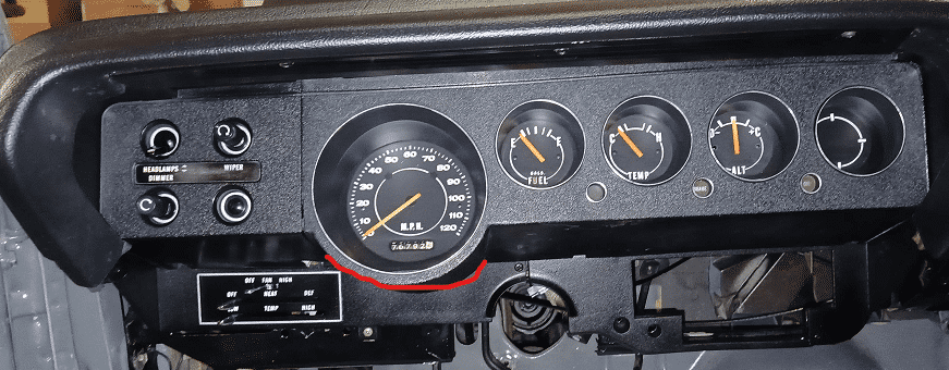

You will need to get a different heater control panel if you plan to use the Rallye Instrument Cluster. That pesky semi-circular cutout ruins the look.
Very common to see a Rallye cluster upgrade with the old heater control panel or A/C-Heater control panel.
The heater control panels are available brand new.
OER ME1450 1970-74 Barracuda, Cuda, Challenger; Heater Control Panel; w/o AC
Part Number: 691-ME1450
MoparCarGuy, thanks for the info and link to new part. I was aware of the need to obtain the correct heater control but figured I would have to find a used one.
