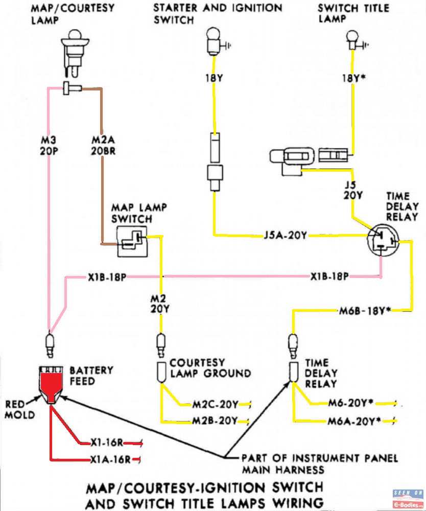

Time delay relay is cylindrical, and I believe taped to the steering column originally to dissipate heat.
Low fuel relay for the overhead console as well as the key buzzer relay are located along the passenger side of the dash frame to the right of the glove box. I can dig up a pic if it will help.
