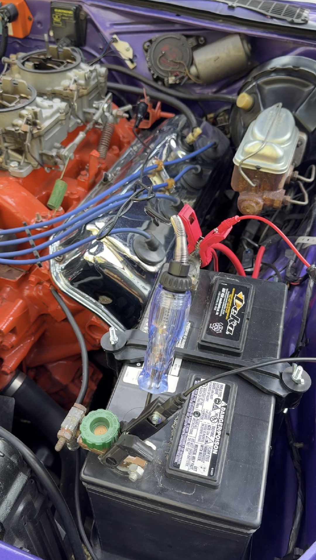

So, I got my '71 Hemi Challenger out of hibernation (Climate and Critter Controlled) only to find that the Oil Pressure Gauge wasn't registering. The engine sounded normal, but I wasn't about to take chances. Back in the day - my attention would be given to the Oil Pressure Sending Unit as they are prone to failure and well this one might be 55 yrs old so. But in my mind, there were other possibilities including wiring, gauge failure, fuse or an engine mechanical despite no tattle-tail sounds. Process of elimination; My good friend Blair, who runs one of the top tier Mopar restoration shops on the East Coast suggested that I test the wiring before going all-in on a Sending Unit replacement. This was brilliant advice. I disconnected the OPSU connector and ran a test light (for resistance) to the negative terminal. Turning the ignition key to run (not start) the gauge came to life! This eliminated any wiring or fuse (are they fused or just fusible linked) possibilities. My focus shifted to the OPSU which I tried to resurrect by cleaning and tightening the contacts and threads to enable grounding (even through the Teflon tape). But to no avail unfortunately, the old unit had given up the ghost. Upon replacement and starting, the dash gauge came to life (again) reading close to the "H" while warming up. Interesting observation, the test light was blinking while I was conducting the wiring test. Not a continuous light as I expected. Unfortunately, I can't upload the short video I made. Here's a couple of Pics. Next Project - Fuel Gauge!

The test light was dimming because the limiter applies 5 volts to the gages. It does it by turning the 12 volts on and off, if constant it would fry the gages. The new electronic voltage limiters apply a constant 5 volts to the gages, much better system.

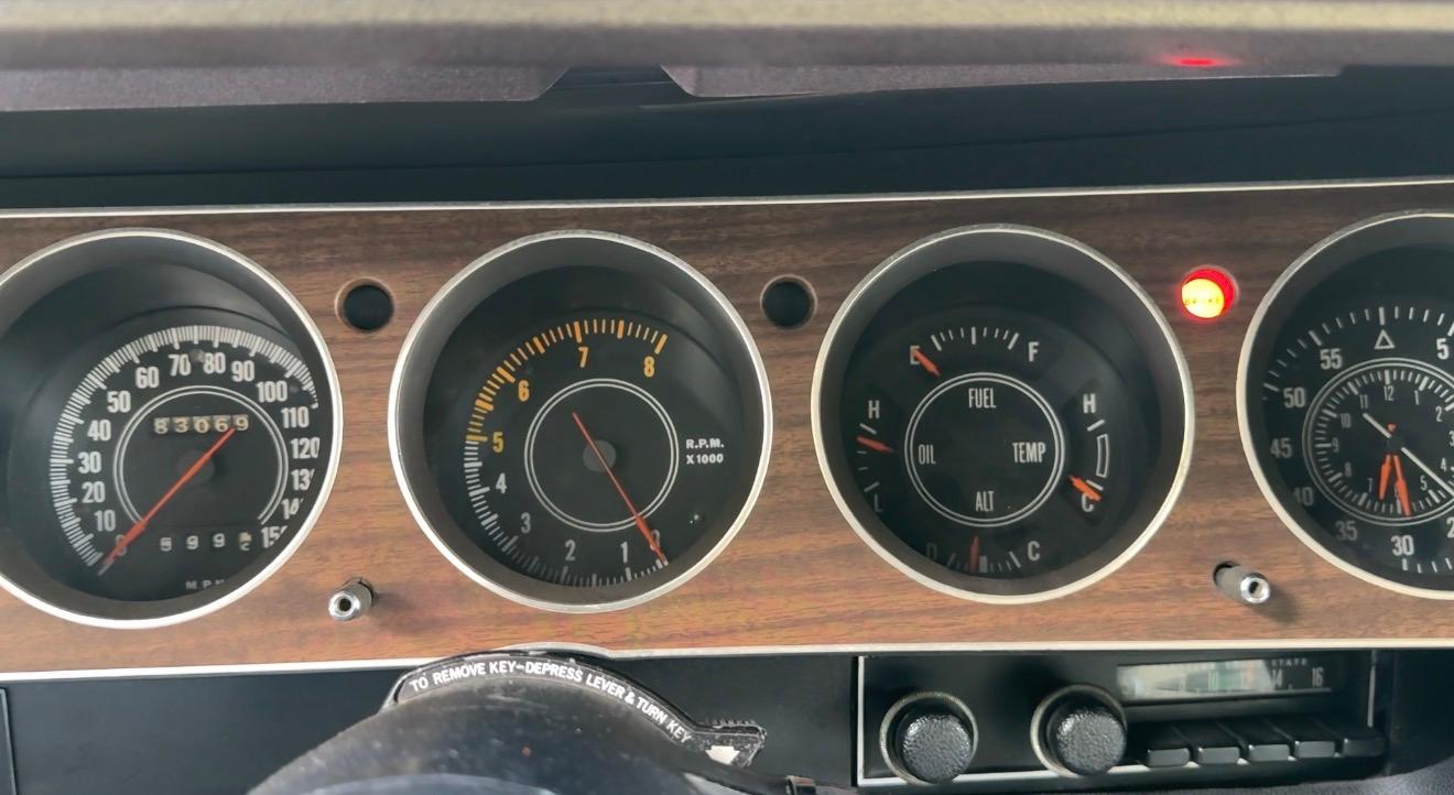

I welcome seeing an image of the instrument cluster while the engine is running. I'm working a theory the voltage regulator behind the dash has failed.
I had to capture a screen shot from a video -

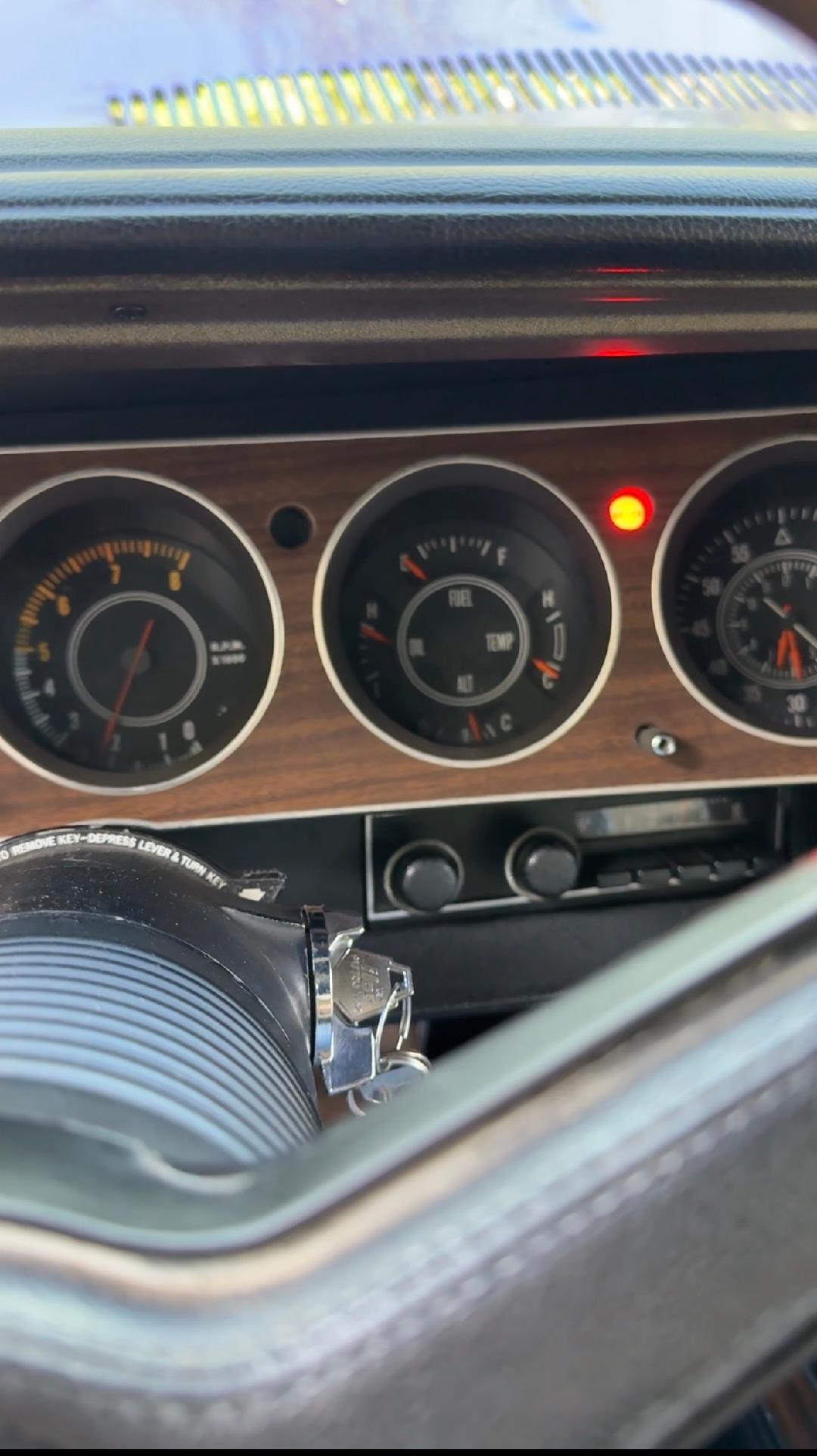

I'll mention that I have another pic at idle where the alternator is discharging slightly. The Temperature Gauge is working btw. The source vid was taken shortly after starting.
On rallye instrument clusters, the temperature, oil and fuel gauges feed off of a common part, a voltage limiter, attached to the back of the cluster. When that sucker fails, all three of the gauges fail together.
While your fuel and temperature gauges (in the photo) may not be working (unless the engine is cold) the oil pressure gauge appears functioning, so my theory its the voltage limiter is kaput.

Nothing wrong with using an auxillary gauge to verify there's nothing wrong with his 426 Hemi. It's sounds like we have the same idea @moparleo perhaps I didn't provide enough description. I didn't mean gauges for his dash, but under the hood to trouble shoot. I have in my arsenal, auxillary oil pressure, fuel pressure, water temperature and vacuum gauges to use. I agree, the factory dash gauges are not that accurate. Spending some money on diagnostic equipment for any engine is a smart thing. Even more so for a 426 Hemi as they are rarer.
Sorry for any confusion - the engine was not running. I had the ignition in the "On" posistion while I "jumped" the Oil Pressure Sending Unit with a test light. Doing this the Oil Pressure Gauge on the dashboard registered a reading as the test light's resistance matched up with what a functioning sending unit would provide in the normal range. So please ignore the Tach, Fuel and Temp gauge readings from that picture.
