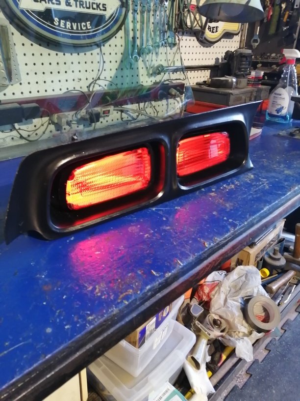

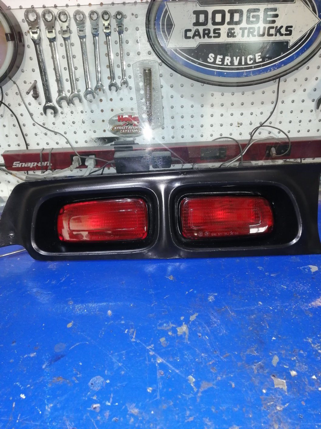

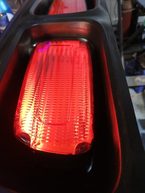

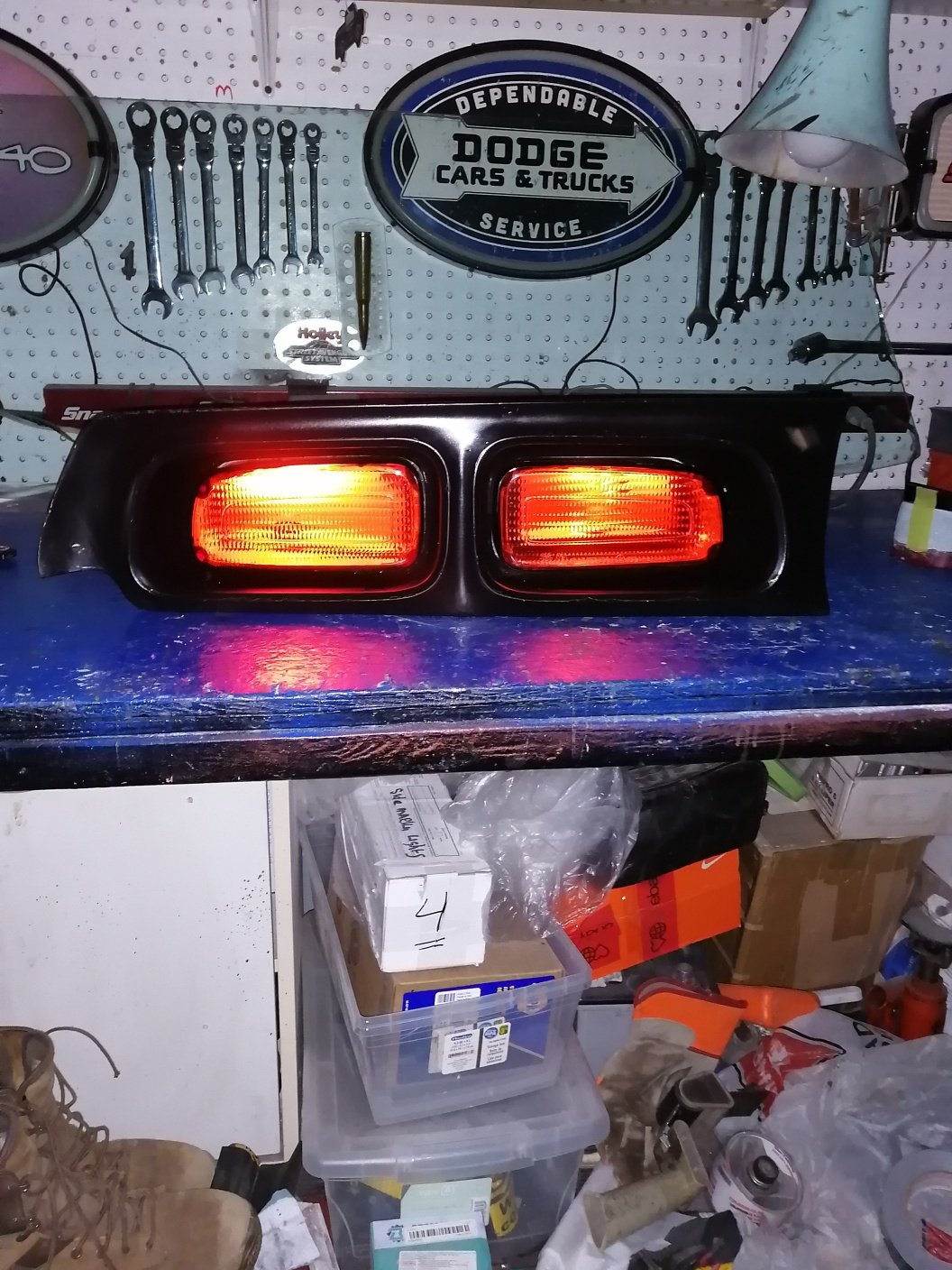

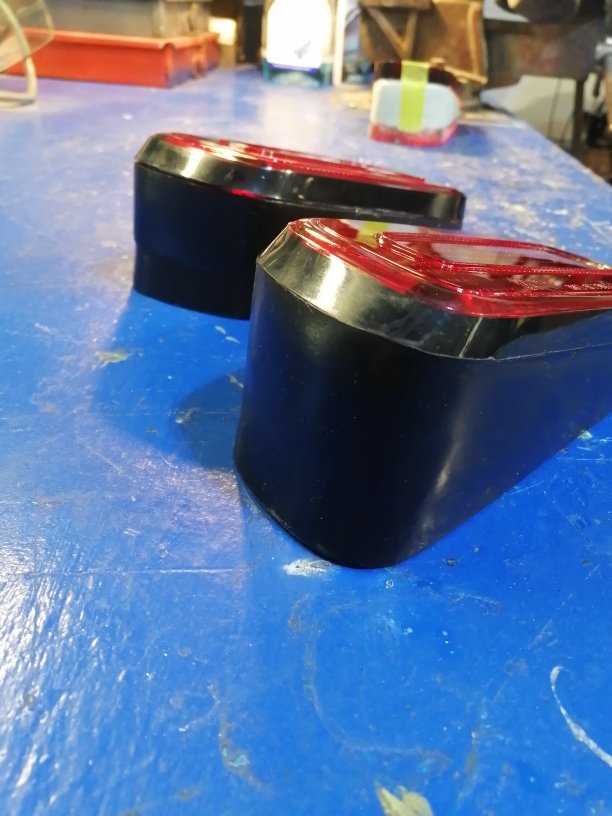

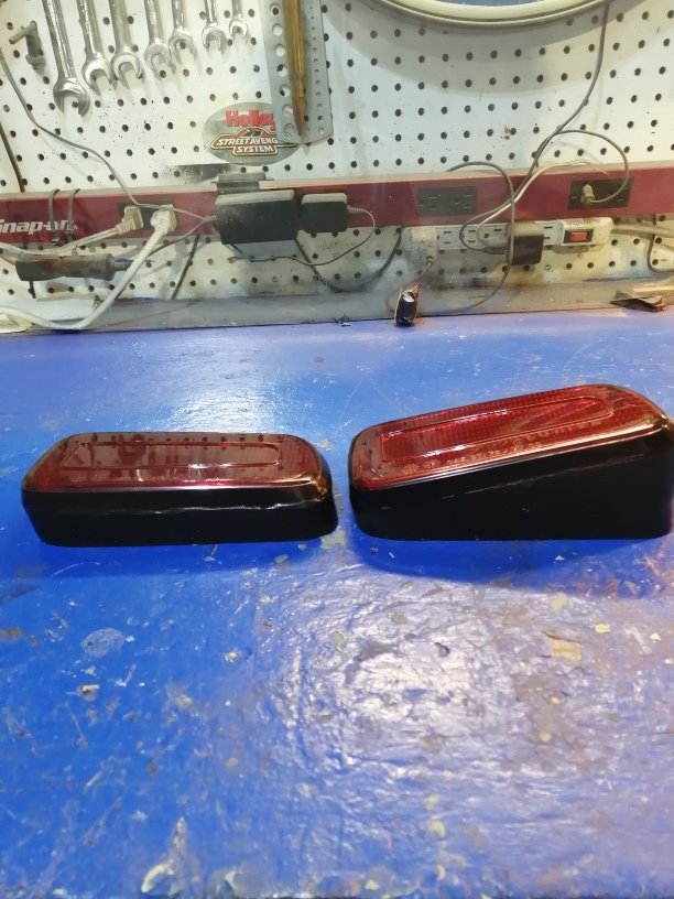

Today at 11:10 AM #1 C Copilot Well-Known Member Joined Jan 11, 2024 Messages 77 Reaction score 59 Location Canada I like the lights squared up in the housing and reverse light removed. No mods to vehicles, just cutting up an extra set of taillights. If you squint, it mint. Last edited: Today at 11:19 AM

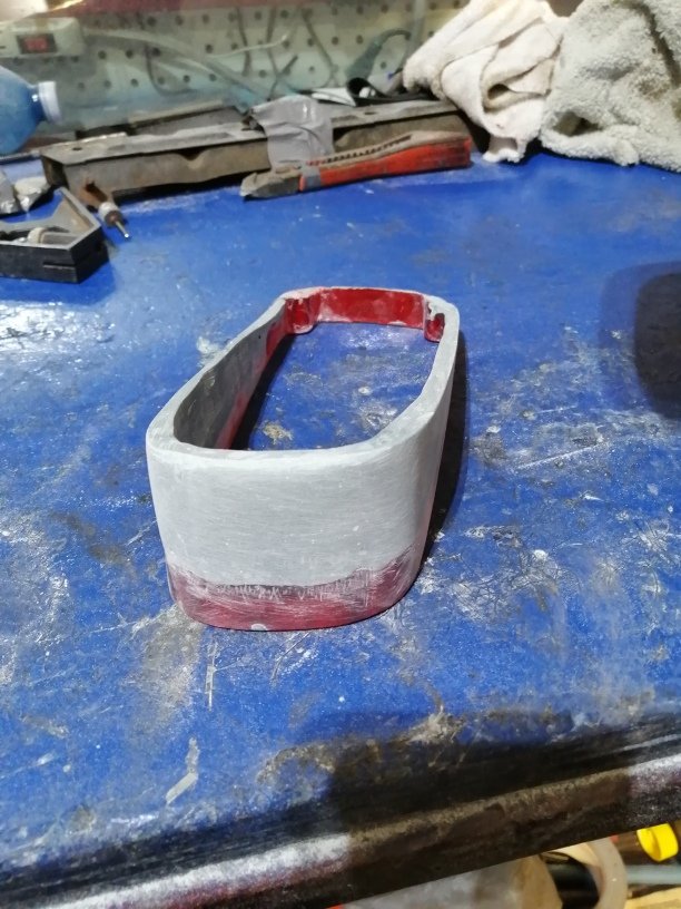

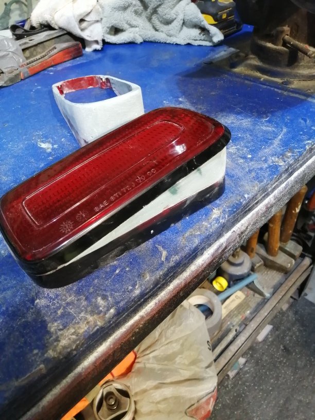

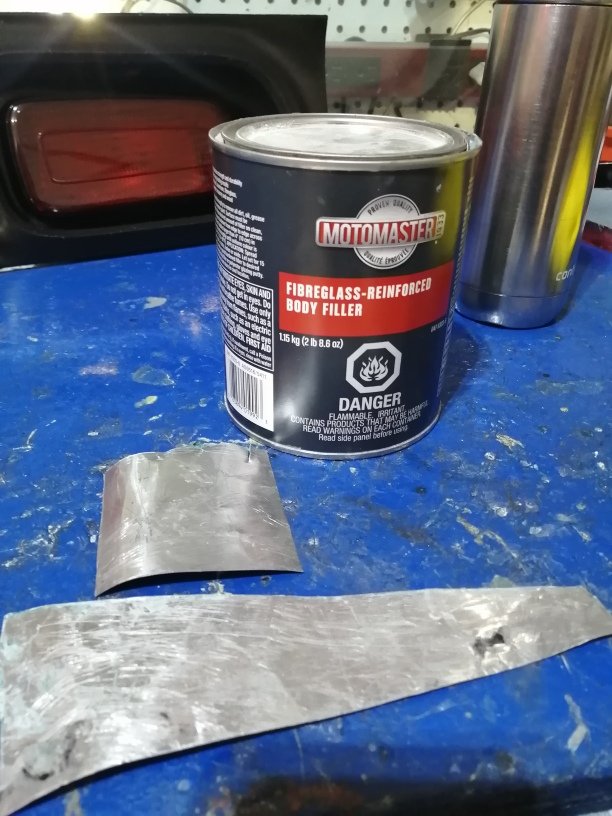

Today at 11:29 AM #2 E ERAT340 Member Joined Dec 29, 2008 Messages 21 Reaction score 10 Location SE Mi. Copilot! Looks Great.....better than mine! What did you use to build up that wedge?
41 minutes ago #3 C Copilot Well-Known Member Joined Jan 11, 2024 Messages 77 Reaction score 59 Location Canada ERAT340 said: Copilot! Looks Great.....better than mine! What did you use to build up that wedge? Click to expand... Fiberglass re-enforced body filler.
