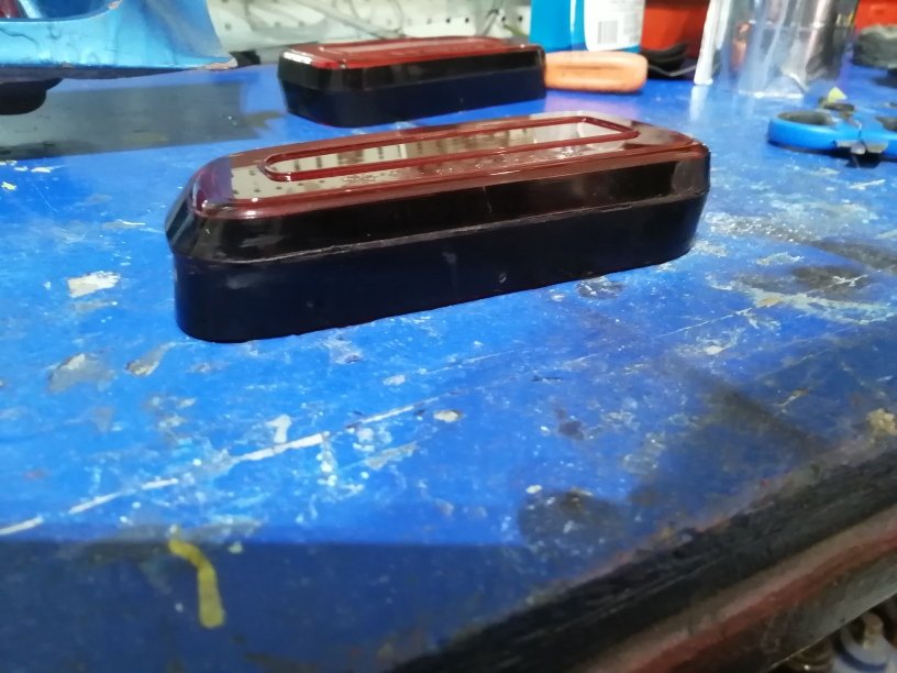

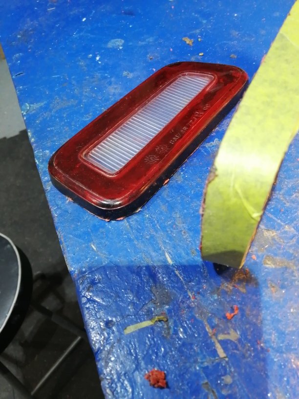

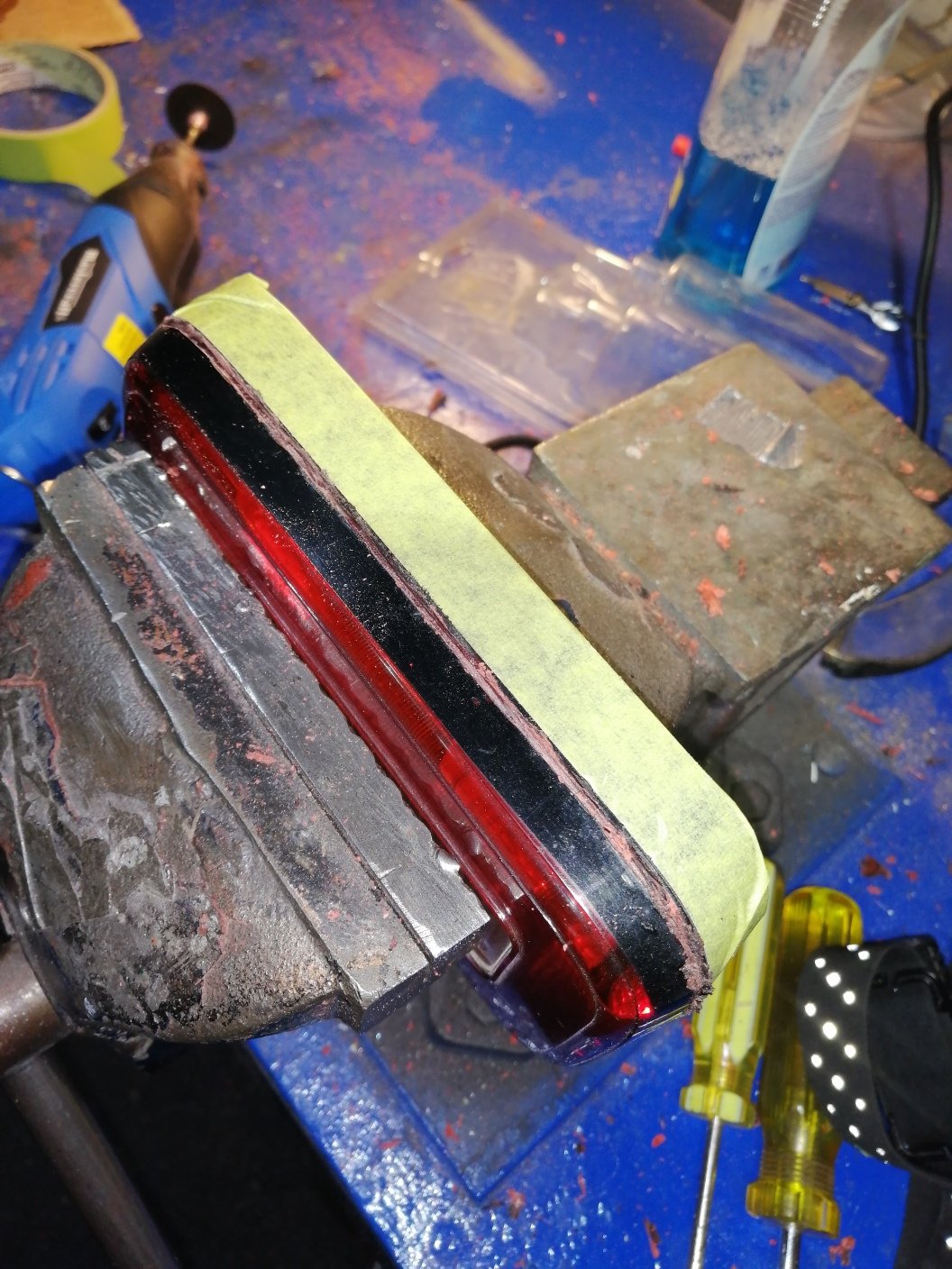

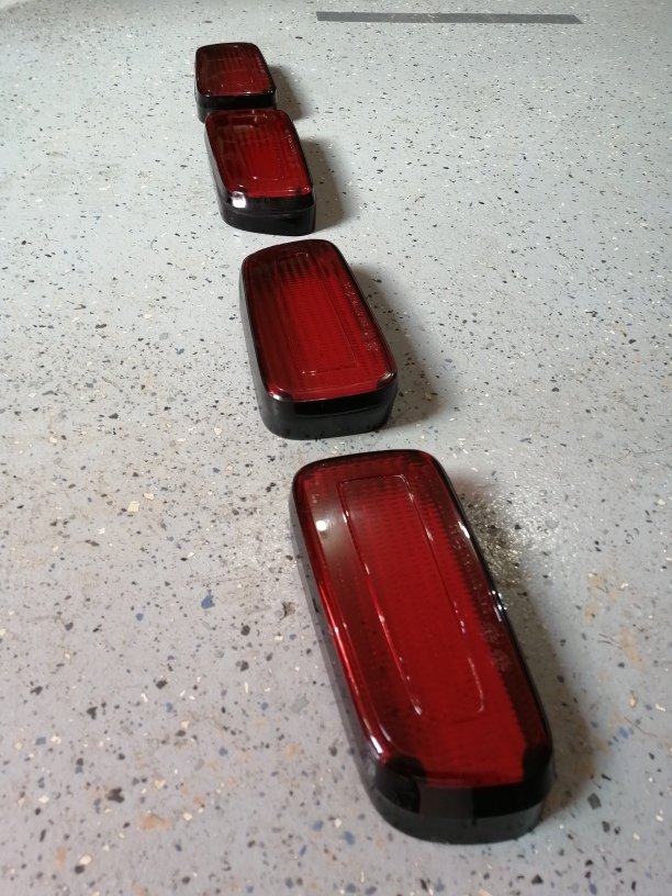

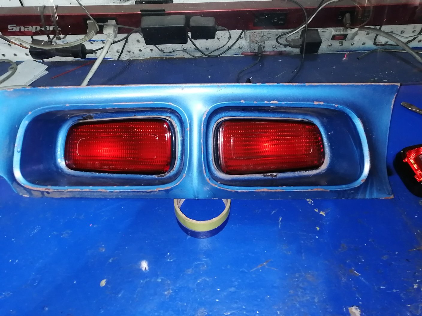

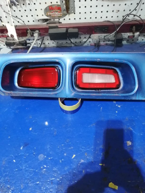

I ask the question last week about modifying the reverse lights on my 73, never did like the look. One member said that he cut his in half with a bandsaw. So I figured I would give it a try. I don't have a bandsaw so I used a cutoff wheel on my dremel tool. So you have to cut four taillights in half, low RPM because the plastic melts easy.
