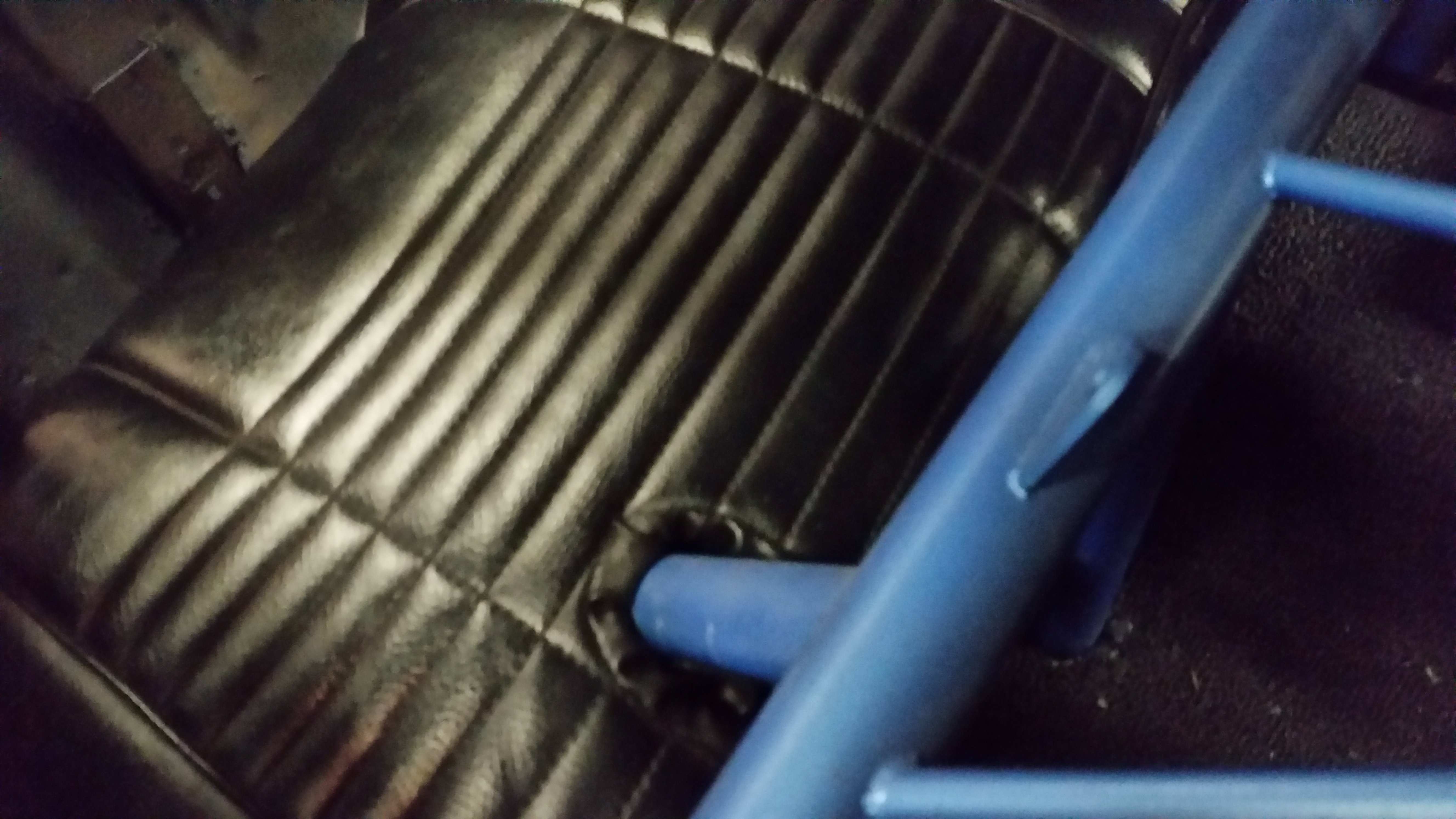

Unfortunately, mine is not passenger friendly to get into the rear seat. However, I do still have the full interior. The cage just goes through the rear seat. We do use the rear seat for my cool shirt racing cool suit ice cooler for beverages on the street for shows and cruising.

That's a bit more cage than I'm considering but it is nicely done, and required by that beast.

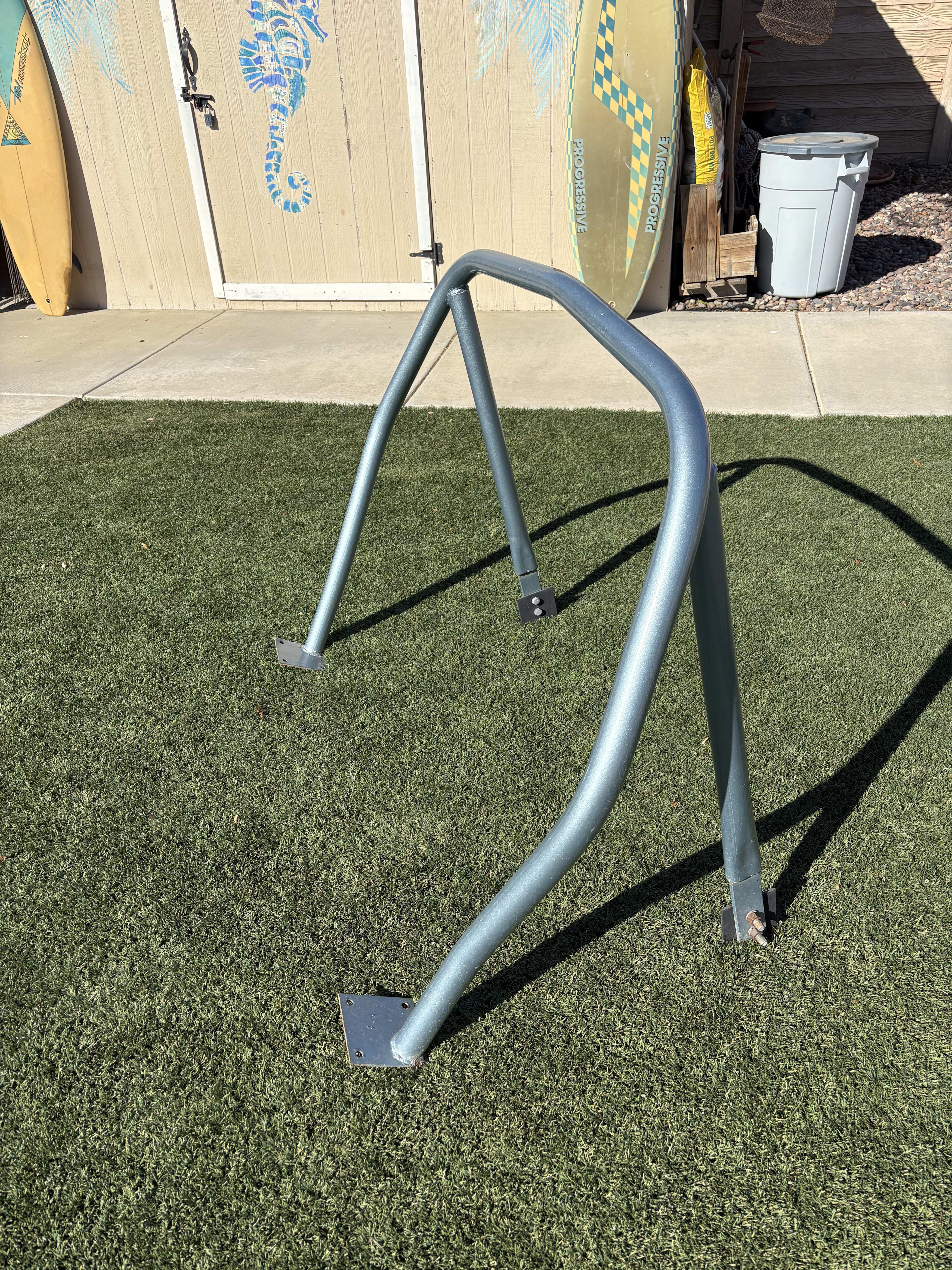

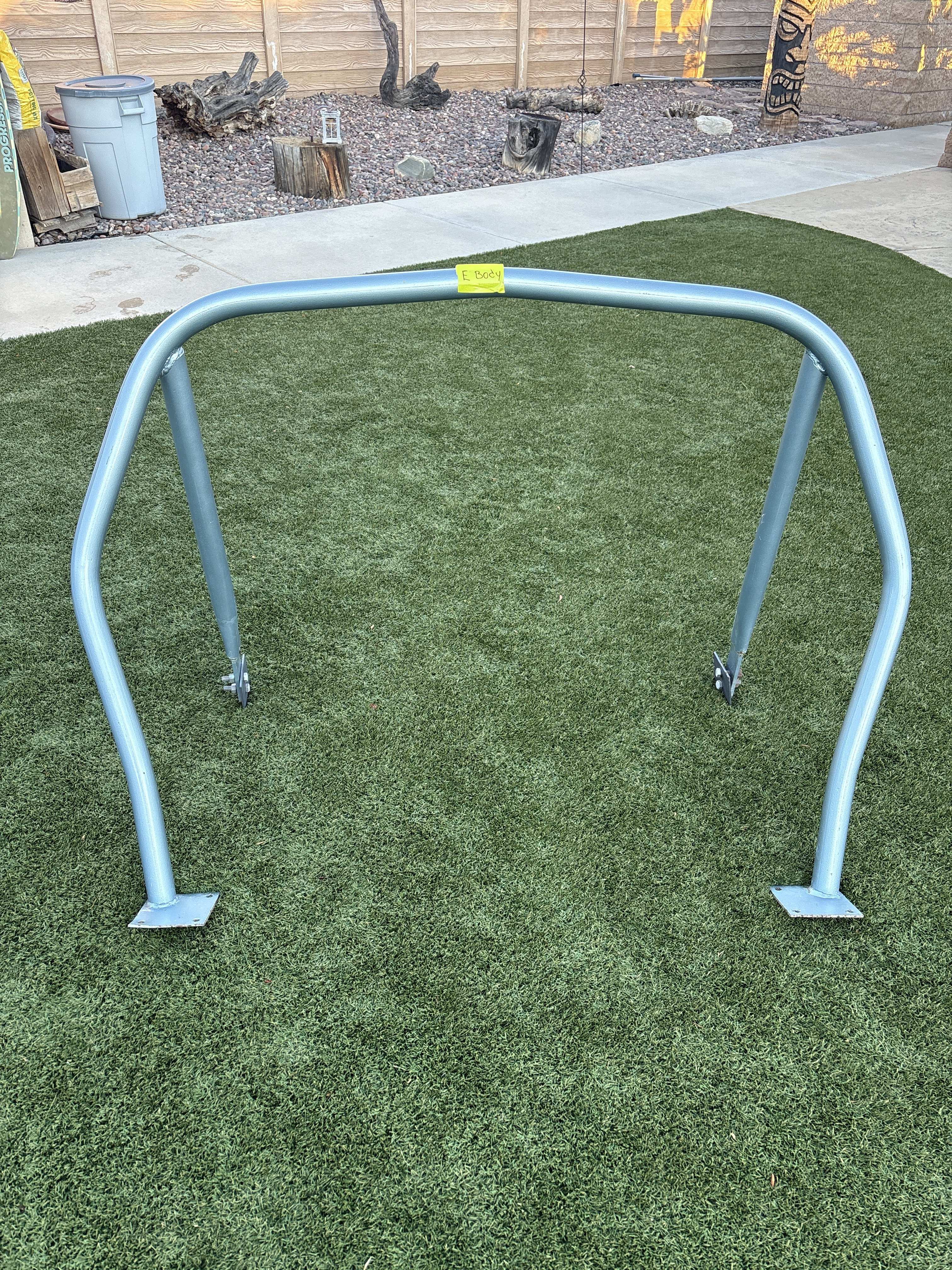

Hey gzig5, here is a photo of the roll bar form my 70 Barracuda. It’s rear passenger friendly too. Maybe this will give you some insight on your design. If you were closer I would consider selling it. 🌴

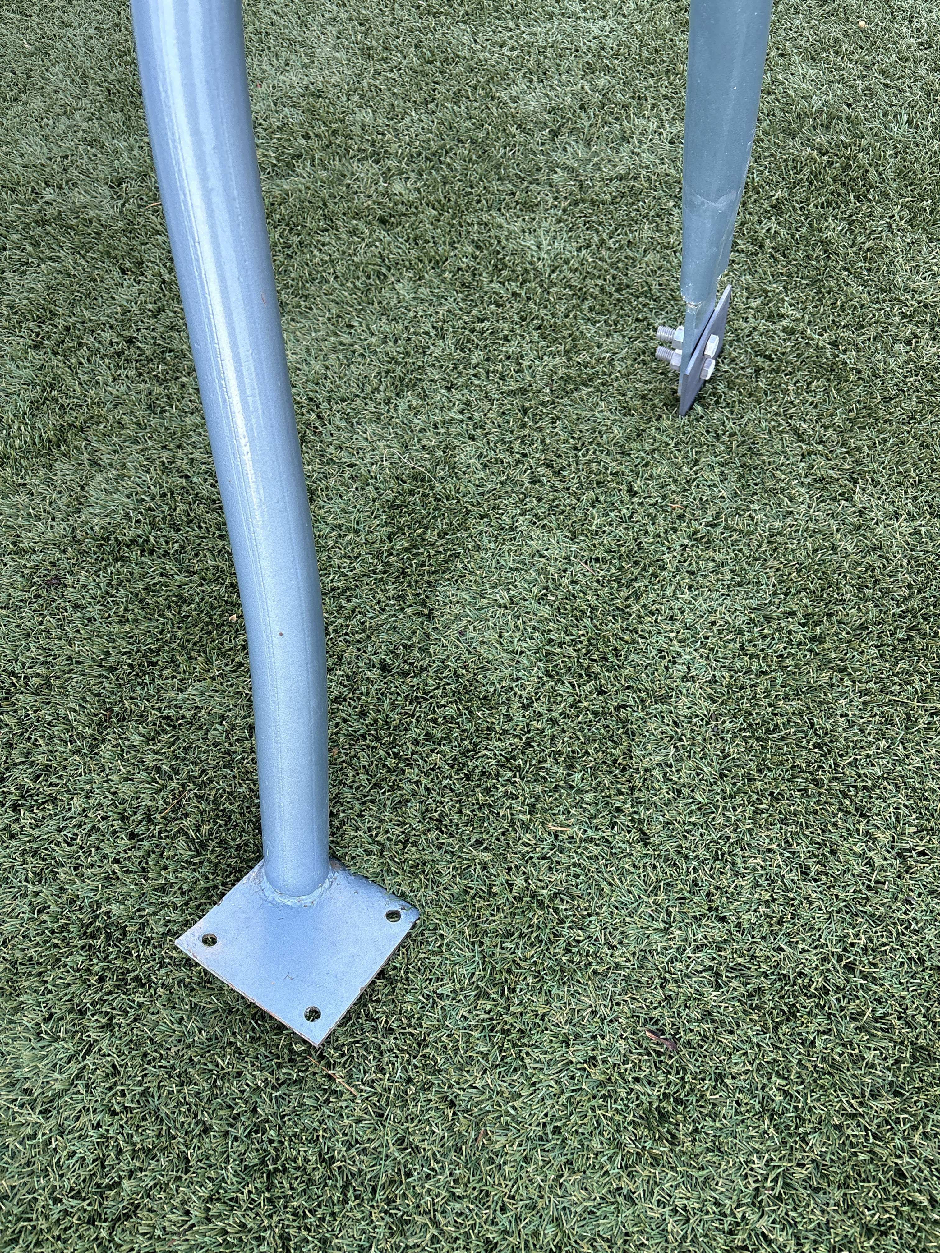

Gzig5, here is a front view of my roll bar to include one of the mounting points. Hopefully this gives you an idea to create one that meets your vision. 🌴
Thanks for the pic. Looking forward to more information. Especially interested in where the four points land in the interior.
To answer your questions: The rear points bolt into the wheel wells on side of seats. The front points bolt into the floor pan just before the door openings. 🌴

For example, NHRA would require this bar to be welded to 6x6x.125 plates that are then bolted into the car. However, I'm not sure if they would approve it without a cross bar. Of course your e.t. and mph may be a factor in that as well. The lack of a cross bar also means you would have to then be cognizant of the position of a harness mount to maintain proper angularity.
