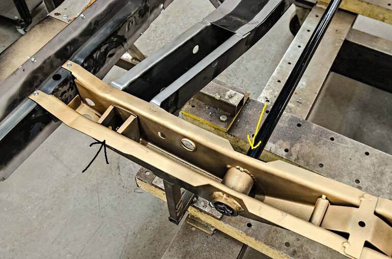

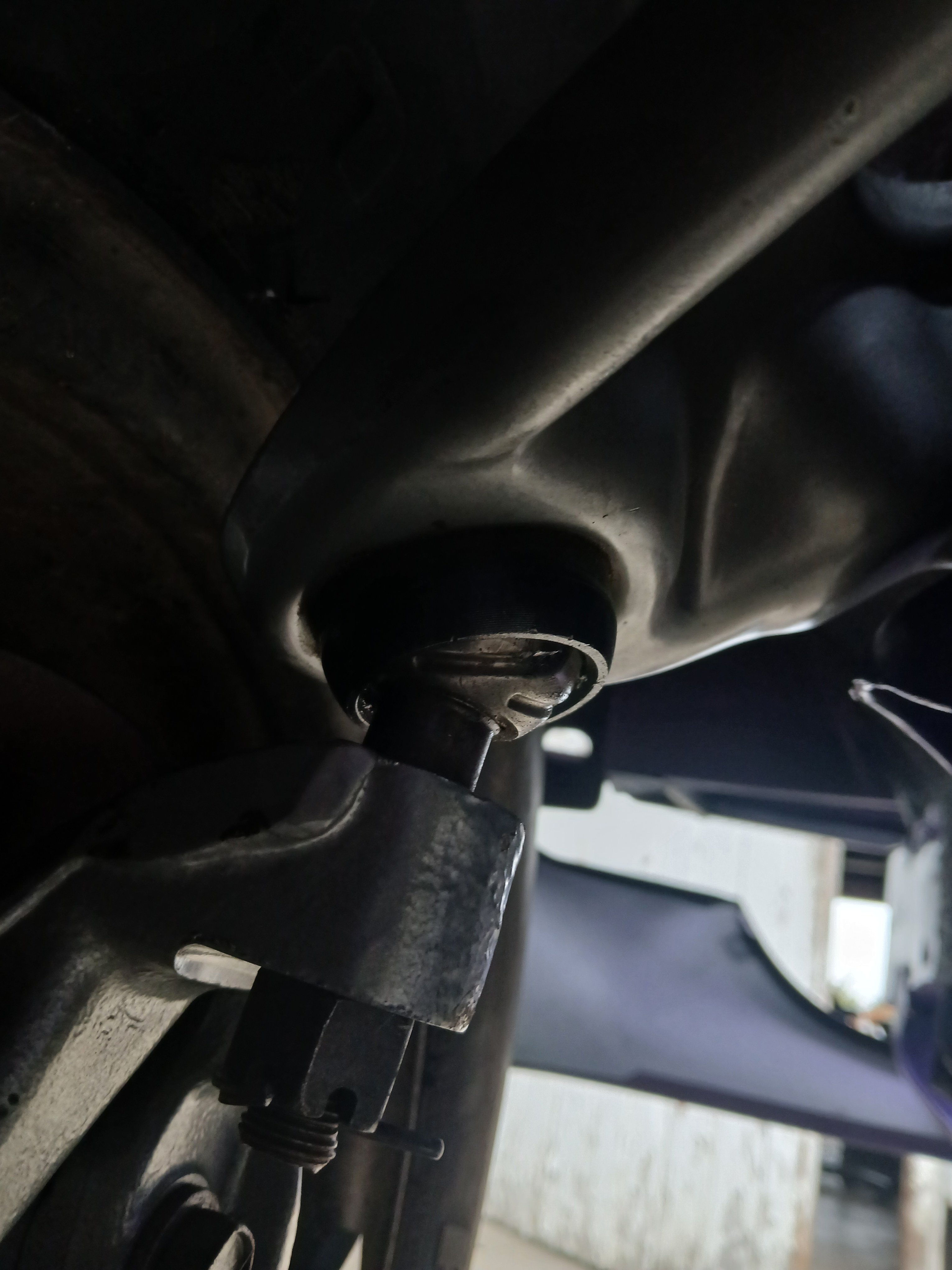

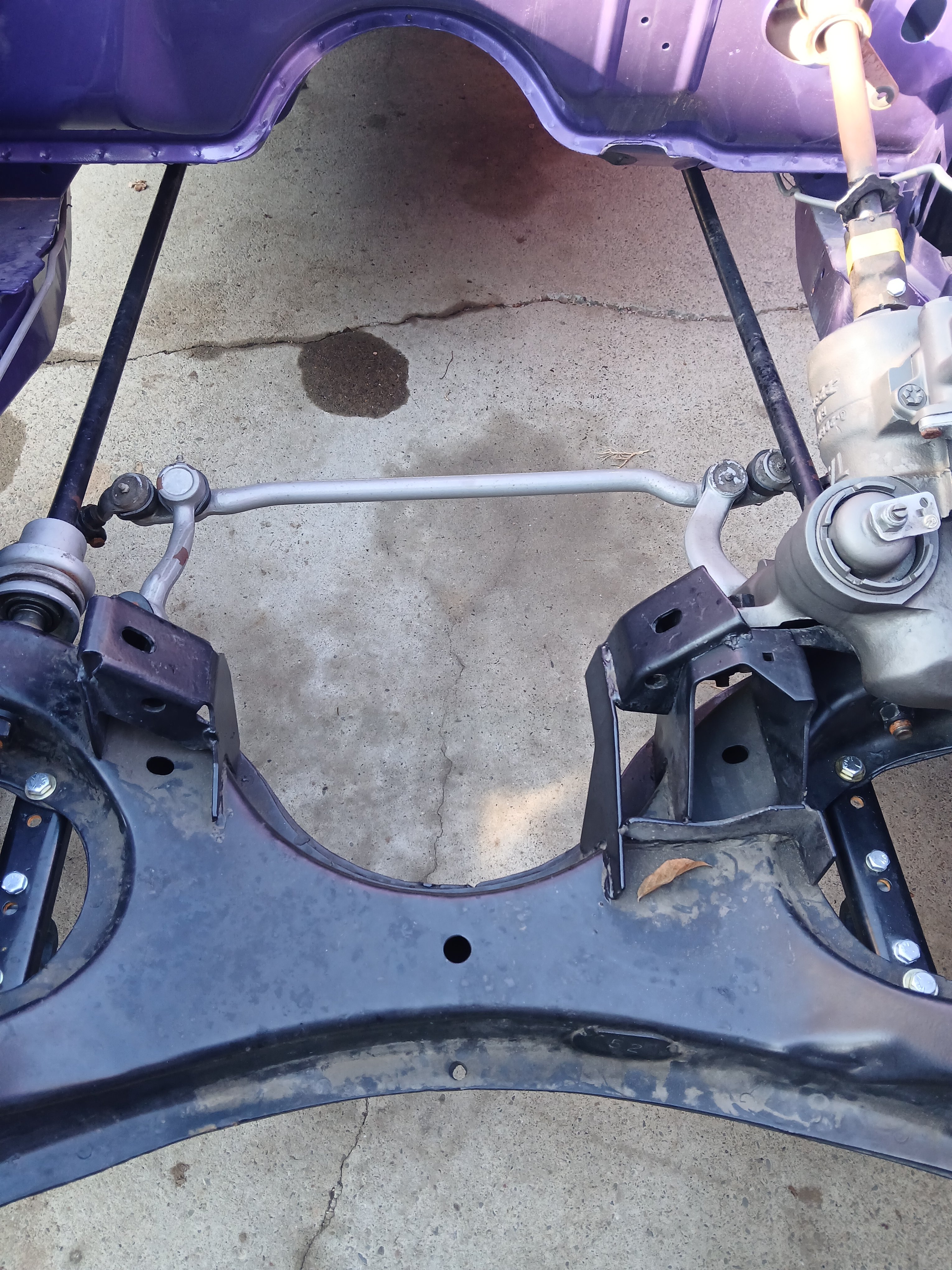

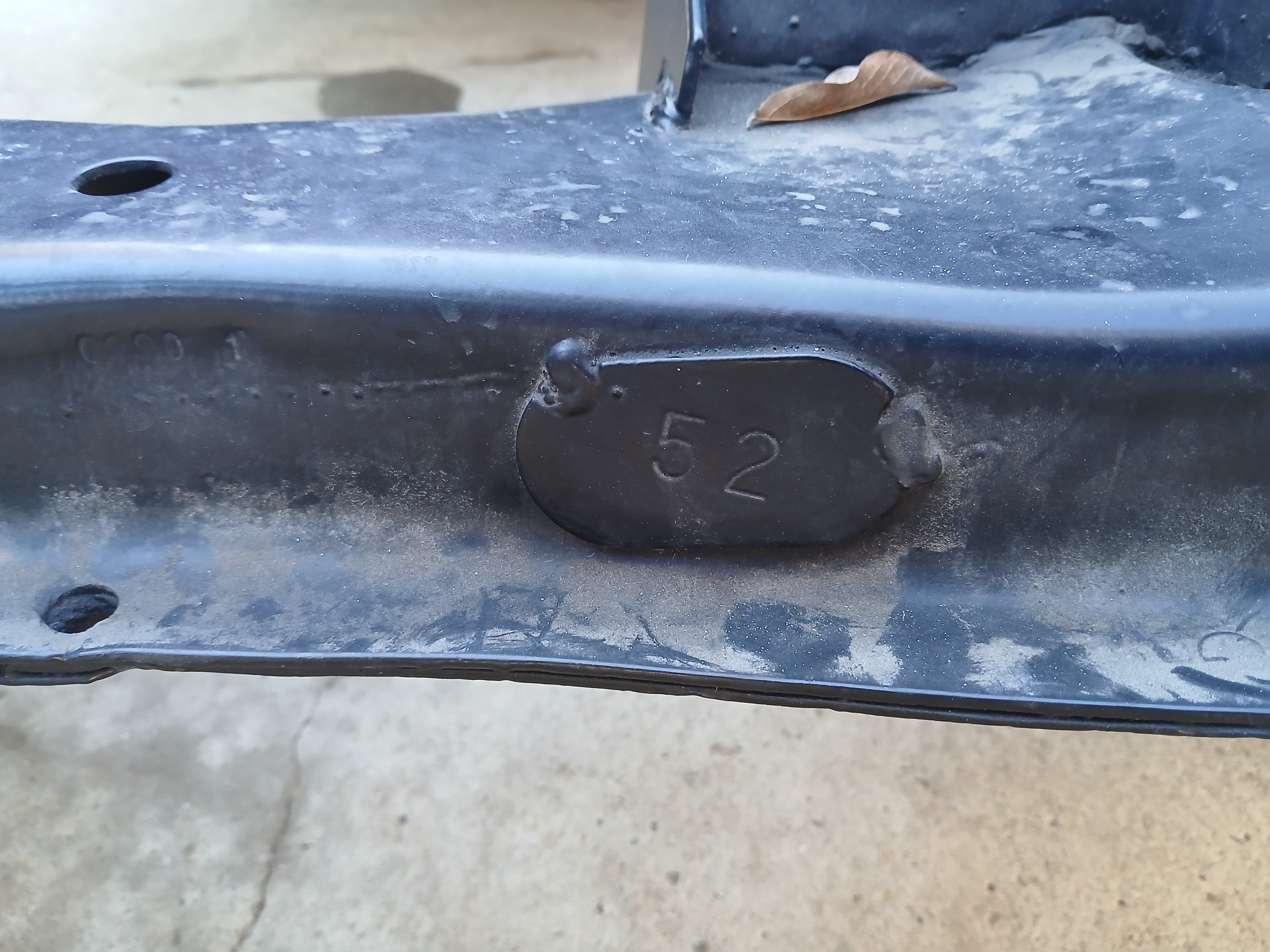

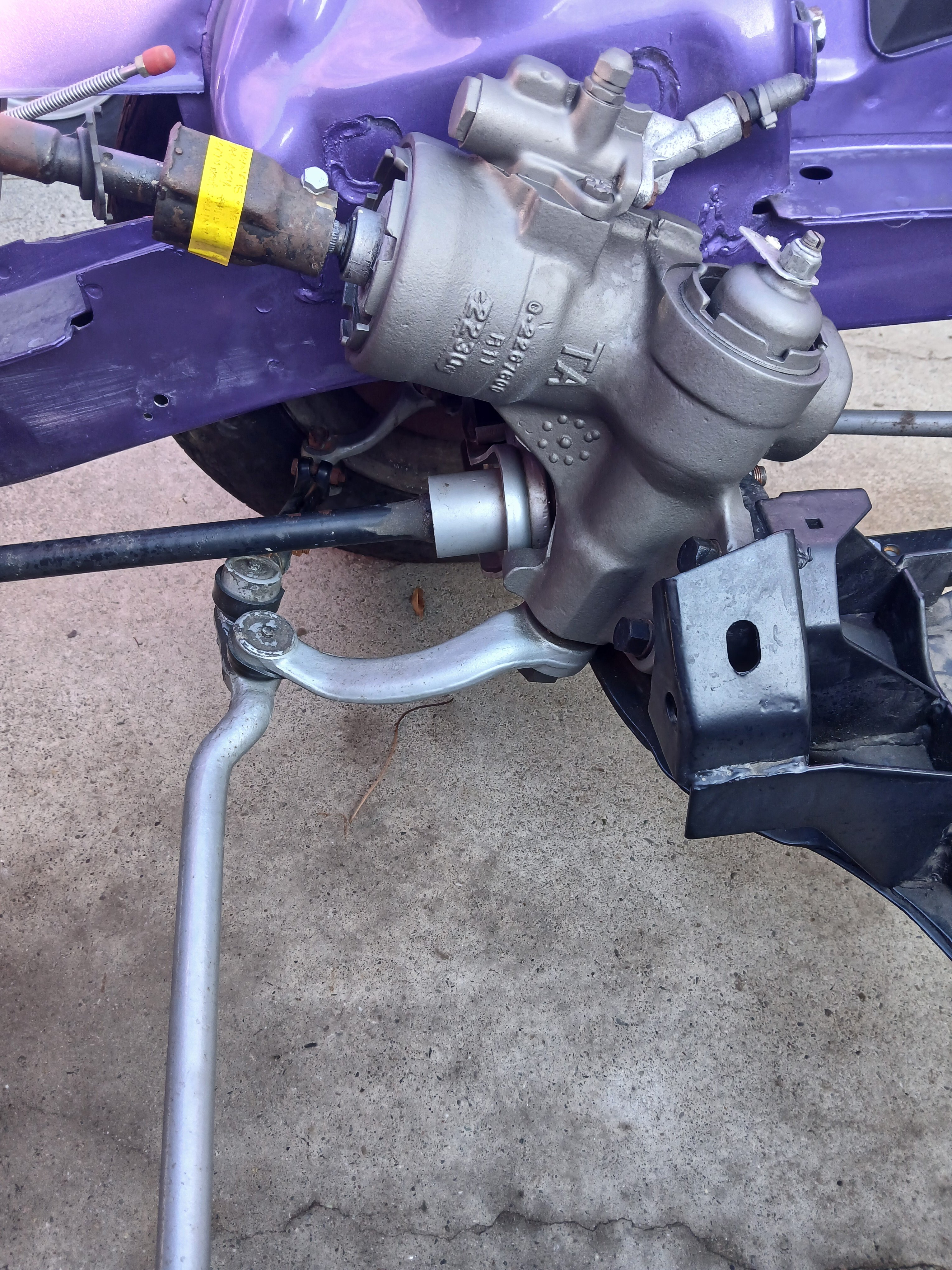

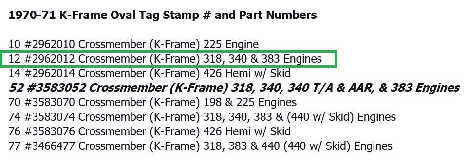

I'm just starting on this project and noticed an alignment problem with the drag link. The pitman arm is contacting the torsion bar. Do I have a miss-matched combination of parts?
Of the top of my head. The tie rod ends from center to center are about 12". I see TA box. The original steering link did not have a equal length idler arm.
