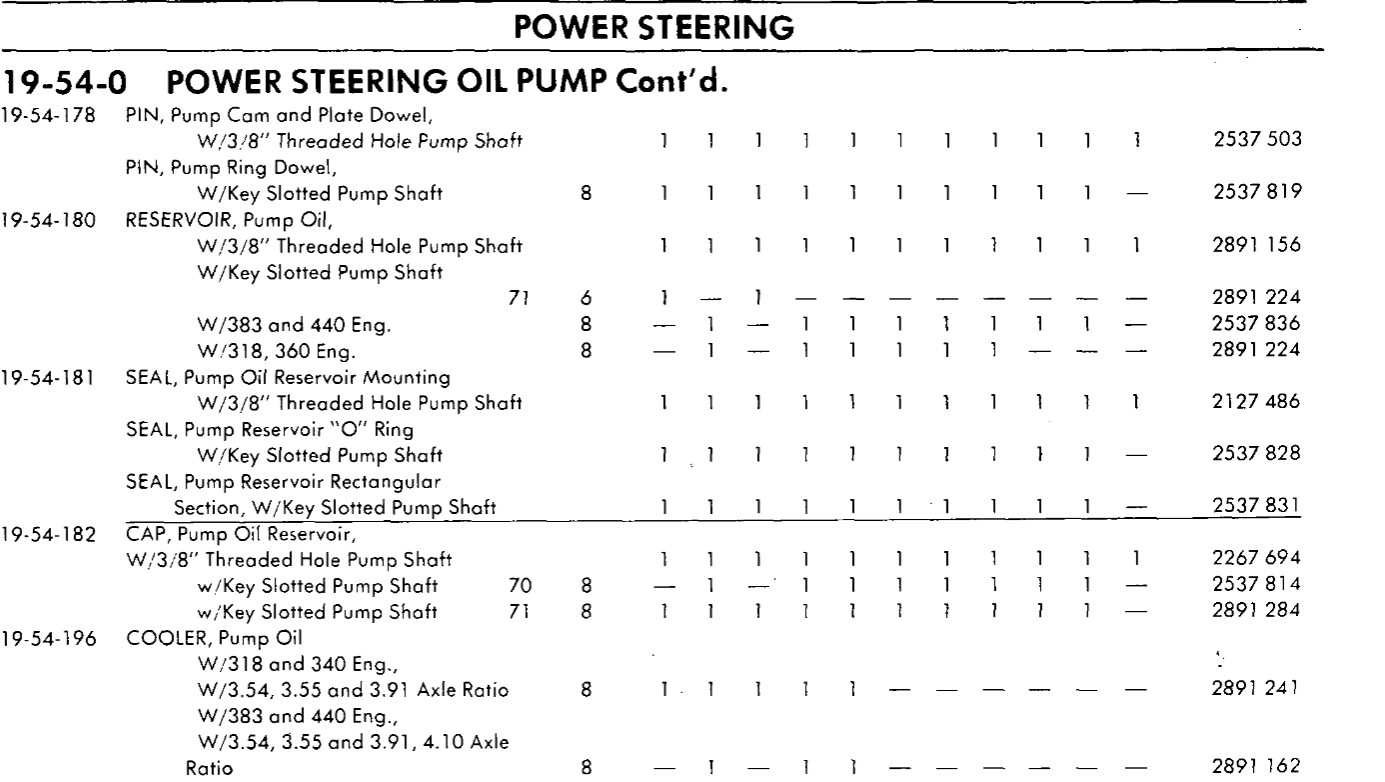

I guess you could send him to the parts books. You might also ask people to provide proof to the contrary.
19-54-196 COOLER, Pump Oil
