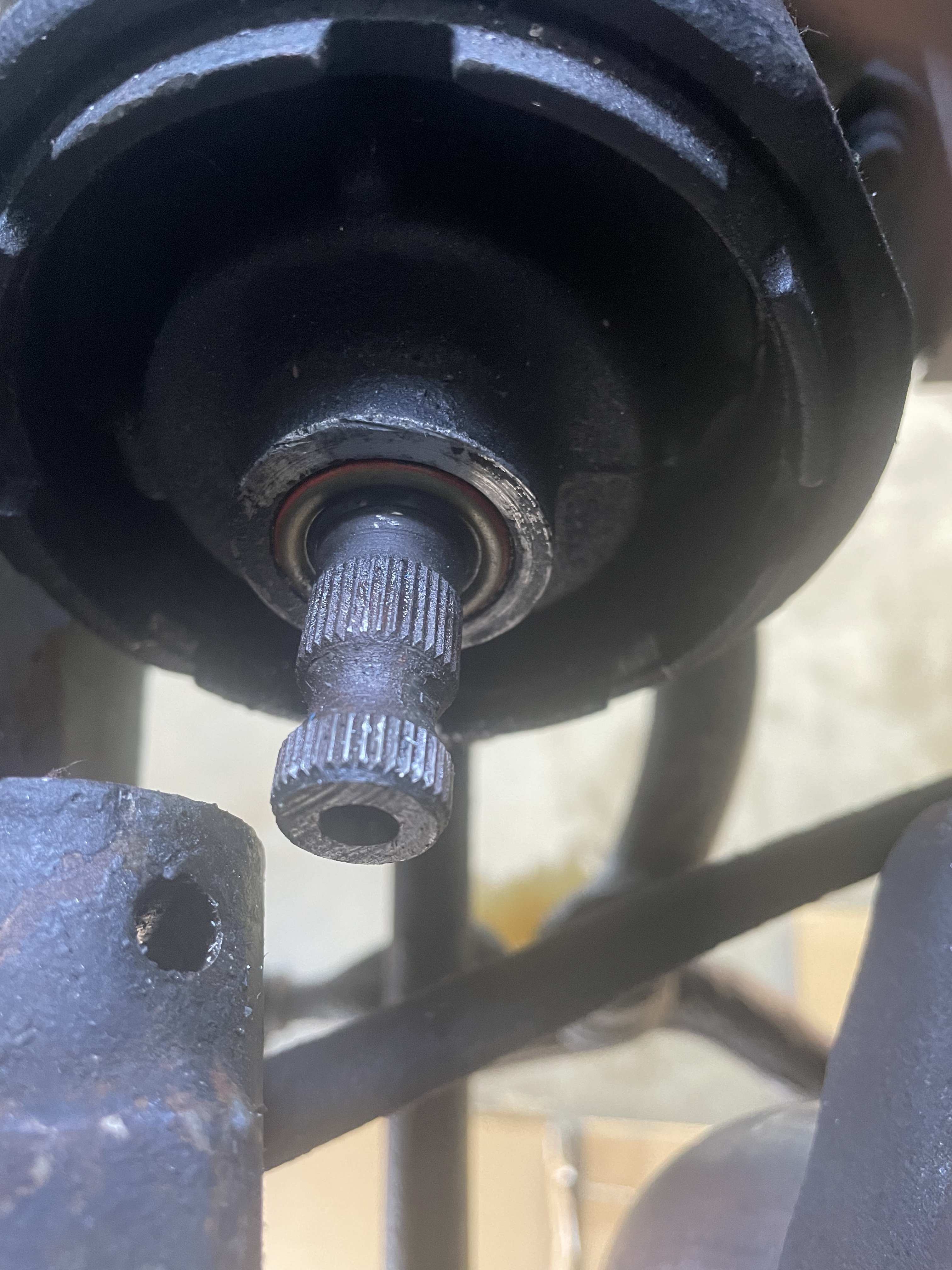

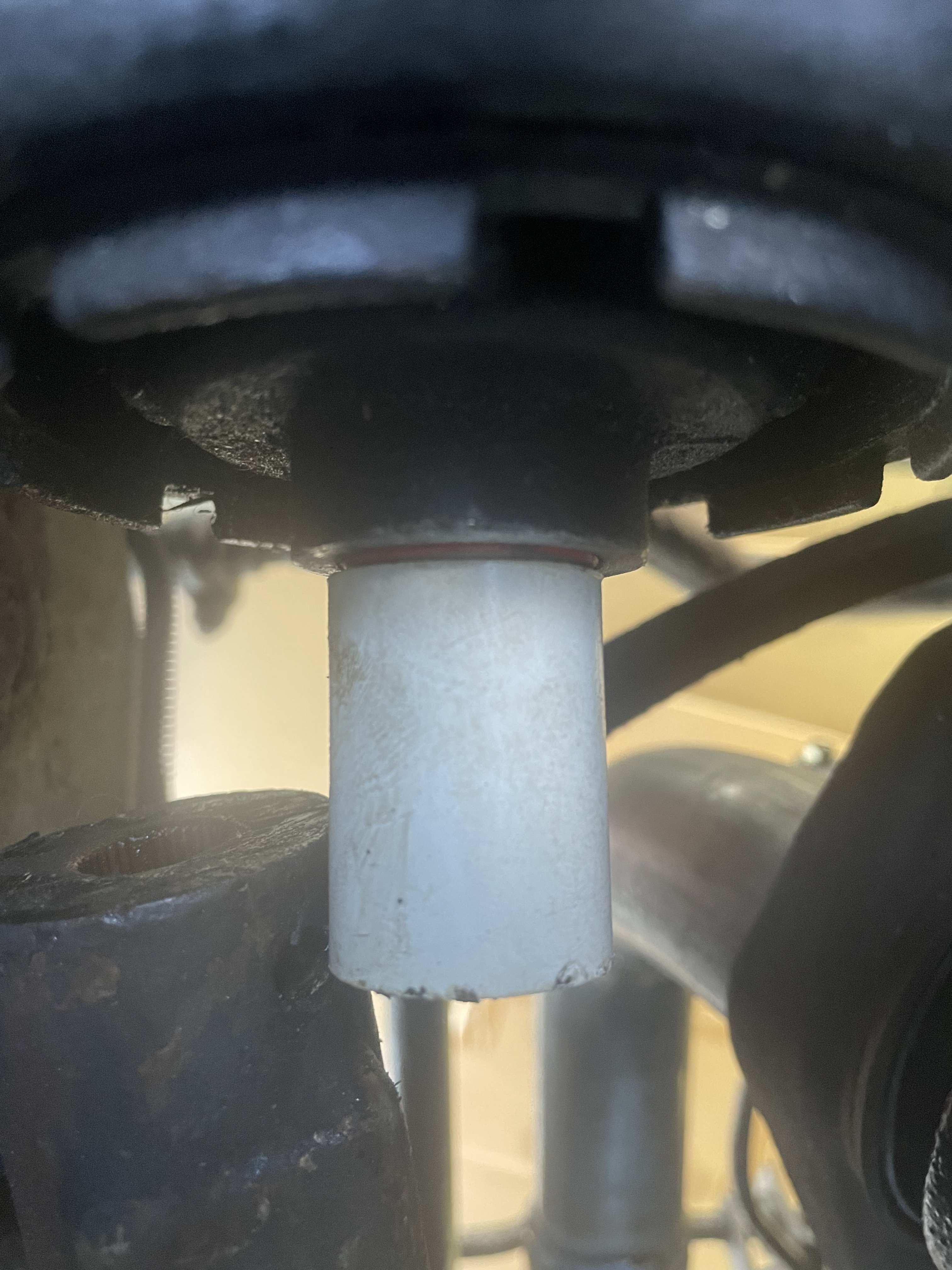

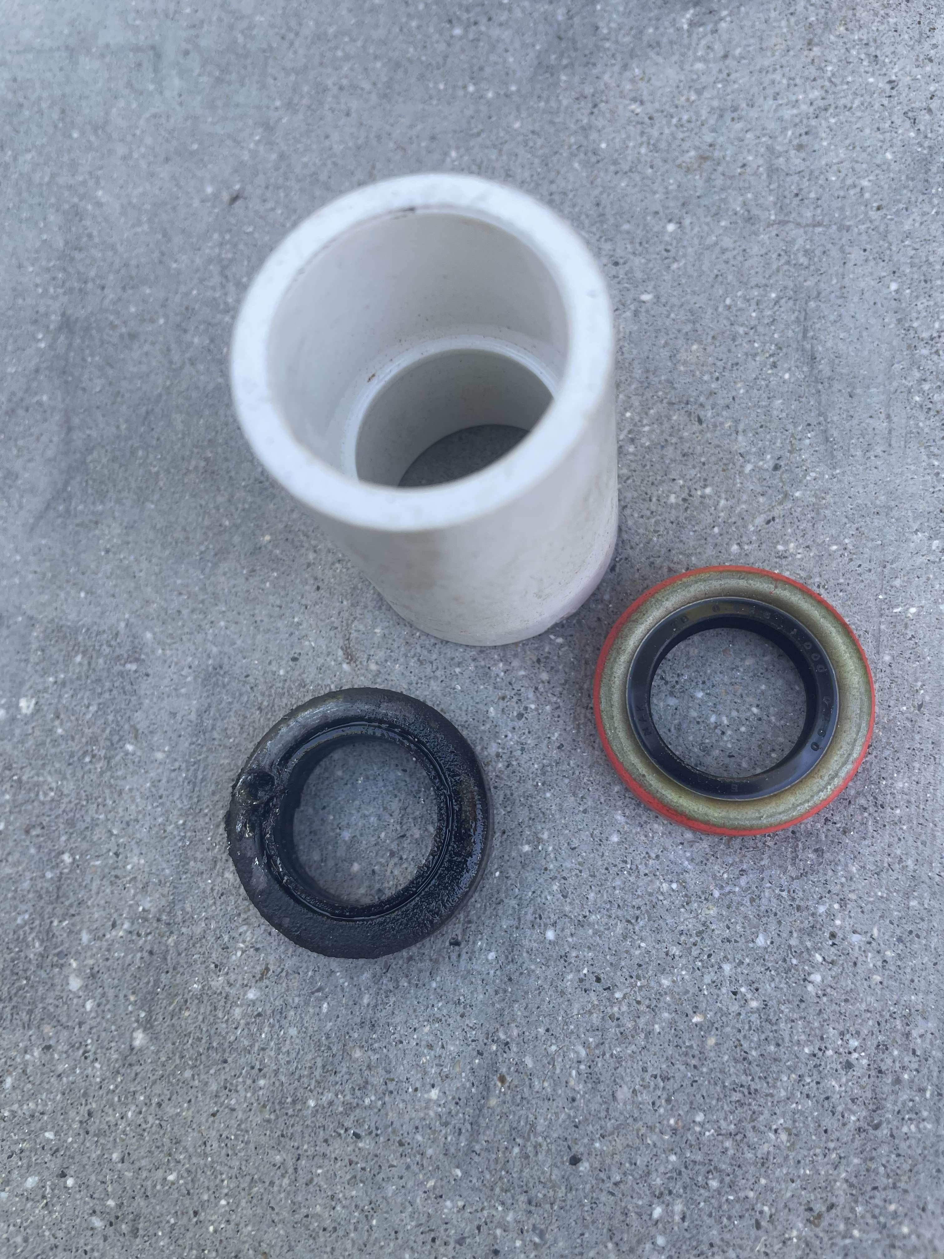

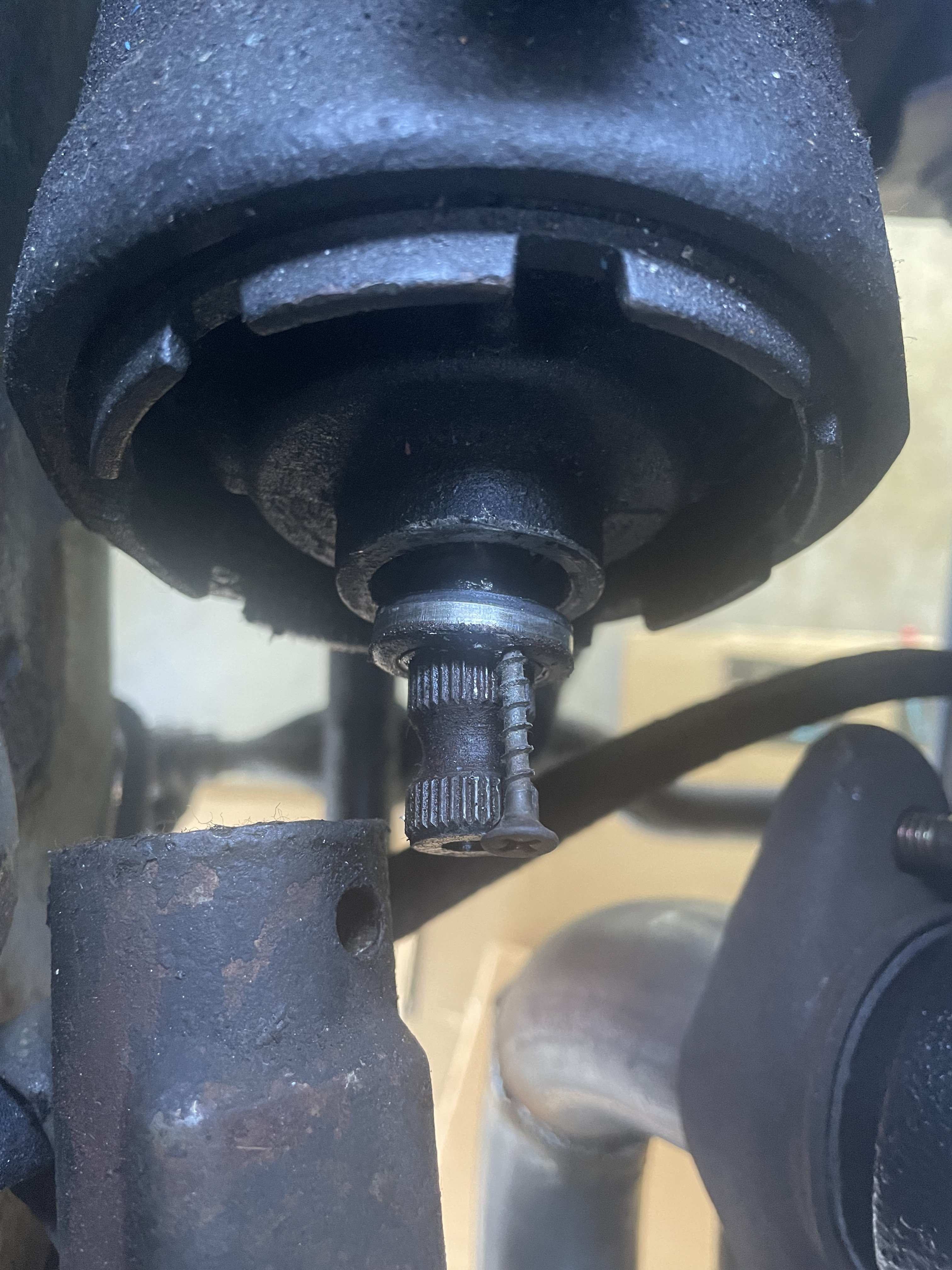

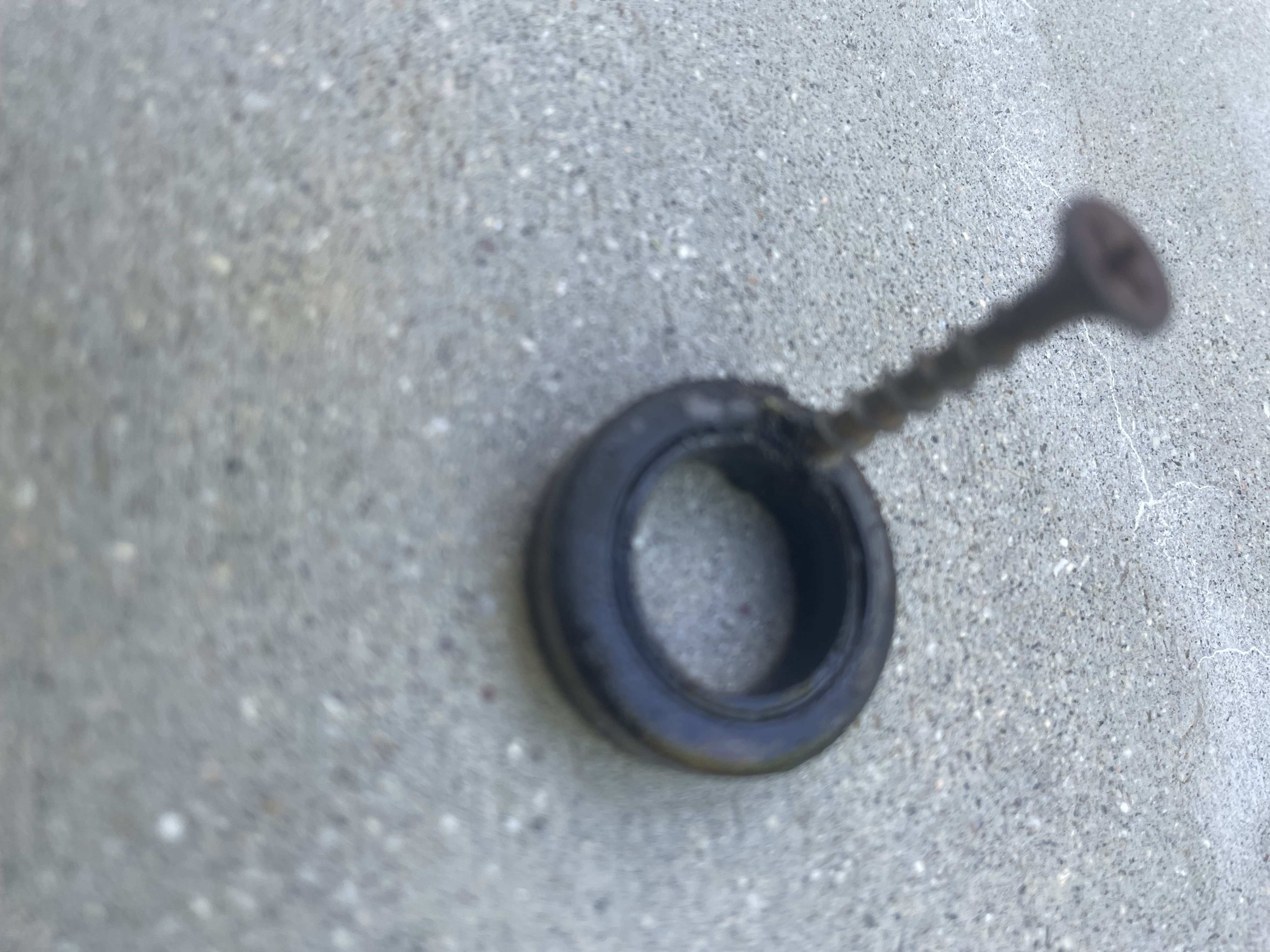

Power Steering Input Shaft - Seal Replacement
Thought these pics might help someone down the line, as they make it self explanatory. Was leaking bad before our Fall 2019 trip to the 50th Anniversary of the Aero car in Alabama and Georgia. I added leak sealer and it got me this far, but it's been pissing on the floor since starting the car...
