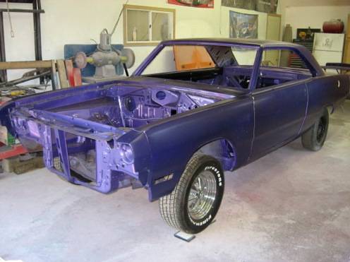

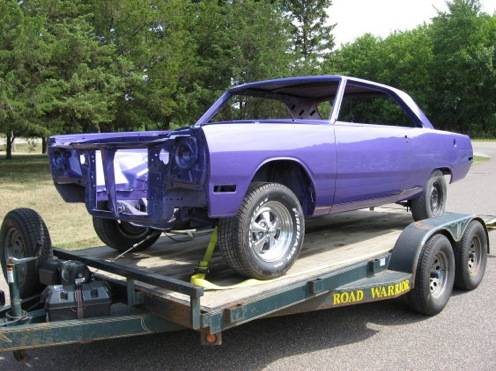

Whatever primer your going to use, just try and get a neutral color like gray, and then you won't have to worry about effecting the color.
When I restore a car, my last go-around of primer, I tint the primer to come as close to the color as possible. If you get a rock chip in the car it's not as noticeable by doing it that way. But by no means do you have to do this.
This car is C7 Plum Crazy, and I tinted my primer.
