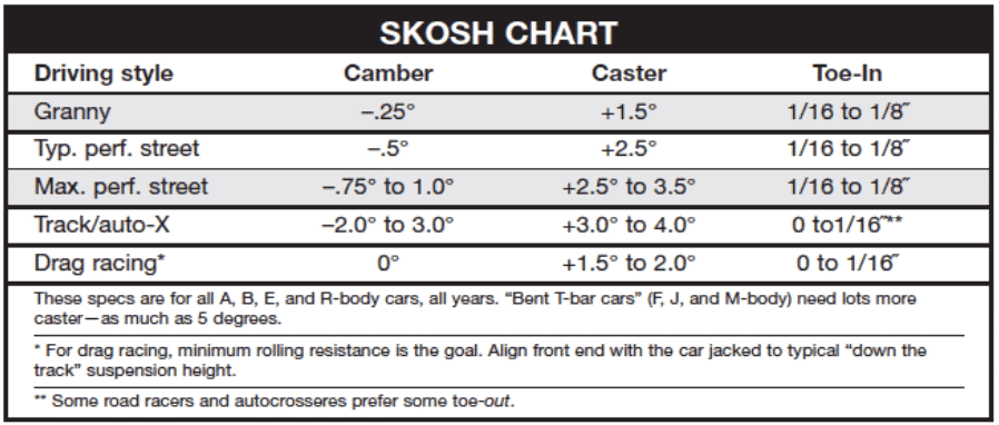

Lastly, after much debate and looking at the many options out there I decided to upgrade to the QA-1 upper control arms with the thought that if this didn't get me to the feel and handling I was looking for, I could always upgrade to the option from a well known suspension tuner that included the bump steer correction (upper control arm, with front pivot point relocating bracket, corrected tie rod links, etc.). I did some calculations to see what modifications would be required if I were to make upper control arms myself (yes, I have this capability), but after doing the calculations and looking at the price of the components, it made sense to buy arms with the relocated ball joint to compensate for the camber/caster changes that would make the car drive more like a modern vehicle. Thanks for the post from CudaRagTop. I've seen it in other posts, so if you are the original creator, please accept my apologies. Thanks to CudaRagTop for posting nonetheless. I chose to go with the typ. perf. street setup. I plan to autocross once in a while, but mainly street performance driving.

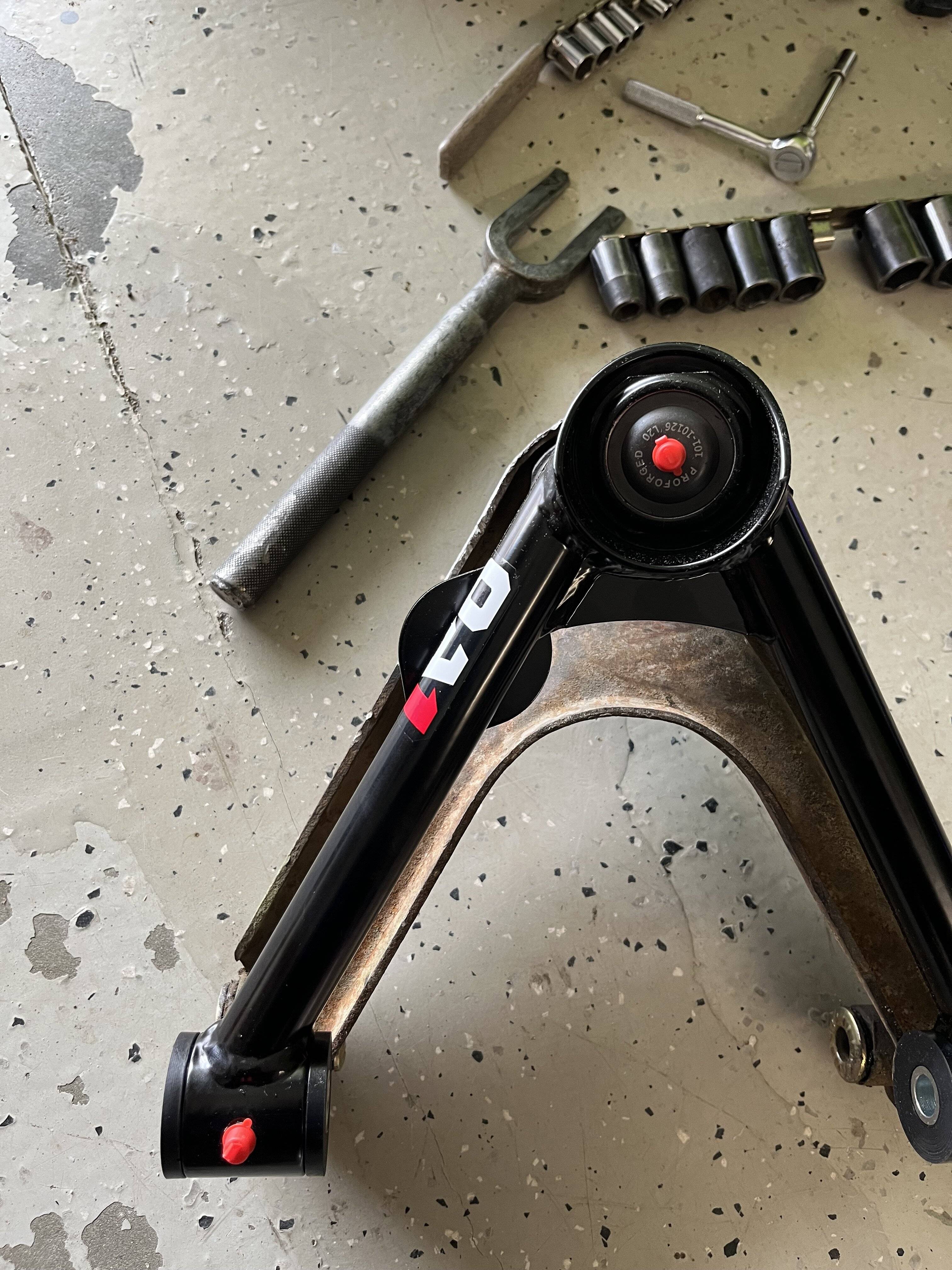

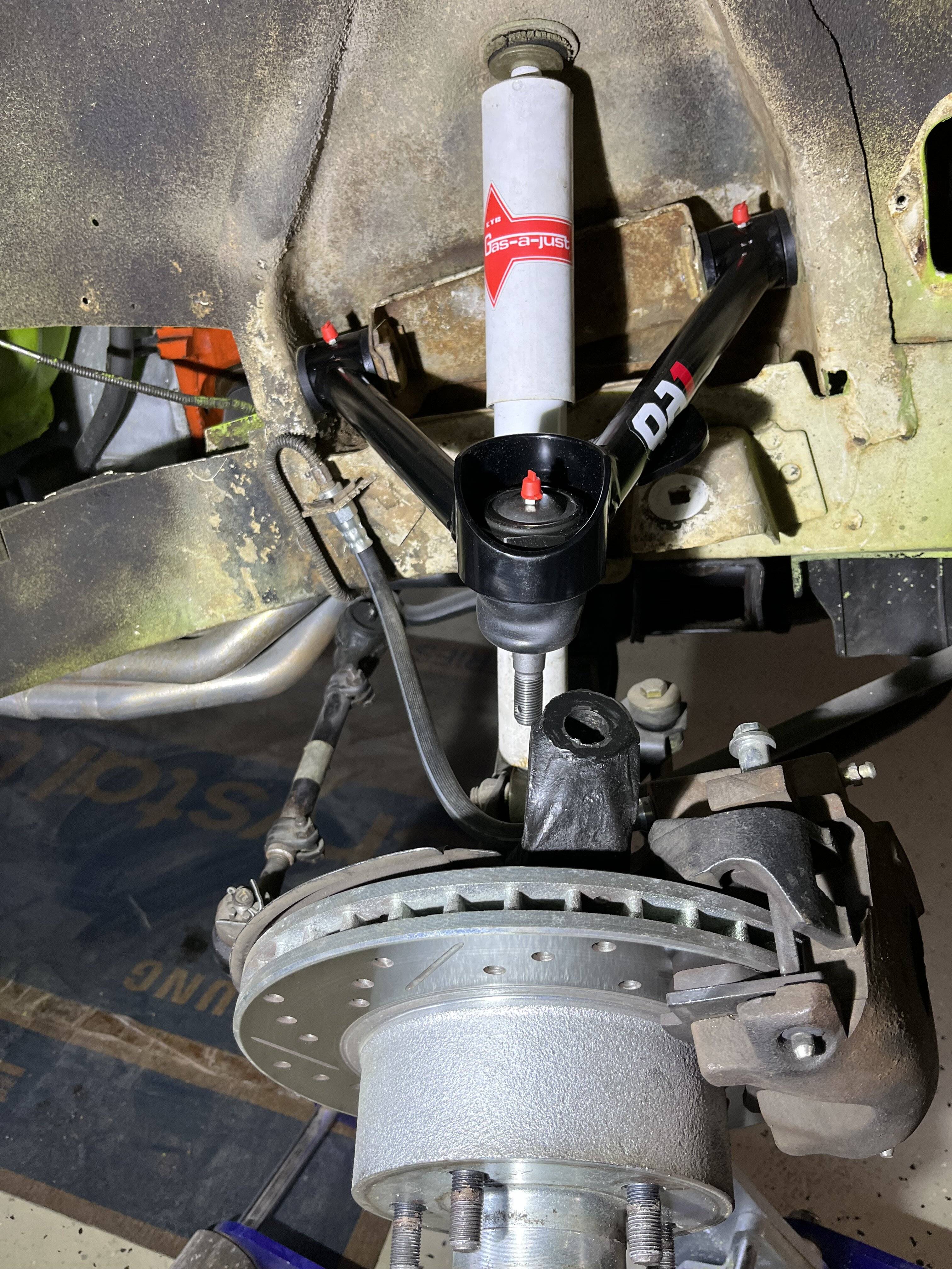

After recieving the QA-1 control arms, I laid them out next to the factory upper control arm to see how significant the changes are. See the photos below. It was hard to find a camera angle that really showed the differences, but the ball joint is further towards the rear of the car as expected, but a tiny bit further outboard. It was a little hard to tell how much as I did not build a jig or fixture to check them.
I did the alignment myself with the help of one of my racing buddies and we ended up with 3/4 degree negative camber on both fronts, and about 1/16" toe in. I haven't measured caster yet, but It is probably more than the 2.5 degrees. I'll be taking it to an alignment rack to do some additional fine tuning. I took it out for a test drive after completing the install and am very happy with the results. On-center feel is night and day better than it was and the car tracks true with no wandering or following grooves in the road. This was a big concern as many older cars I've driven with low profile tires tended to exacerbate this effect. If you are contemplating this change, I highly recommend it.
