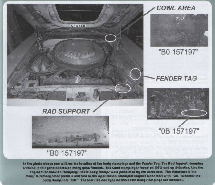

The 440+6 and the 440 do have the skid plate. All the 70 K-frames I have seen have the tag or coin with the part number on them. The VIN is not found on the trunk area. The VIN on the cowl is a partial VIN and may be enough for you to find the VIN for the car from a registry, etc.

The A66 and the T/A were the only 2 ways you could get a 340 in a '70 Challenger so what do you mean by the standard 340 K member?
The numbers Austa is speeking of were stamped on coin sized metal tags that were welded to the forward facing side of the K member just off center on the driver's side.
