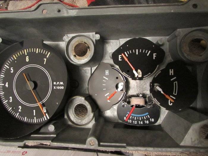

I bought a Sun voltmeter and put it in my Rallye cluster. Not a perfect match, but I think it looks good. Rod
rklein71
Feb 27, 2015
1,233
595
Amarillo Texas

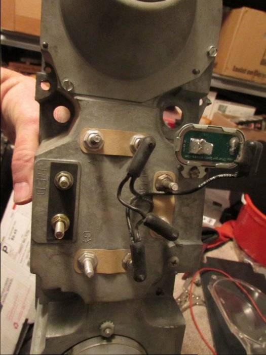

I bought this gauge: Sunpro 2" Voltmeter Black / Black Bezel New CP7985 0-18V. The gauge housing had to be enlarged slightly because the posts are just a tad wider than the Mopar ammeter. You also have to disassemble the Sun gauge to get just the gauge itself and I had to bend the little resister in and insulate wire off the resistor from the case. Hope this helps. I have not painted my needles yet so they all match.

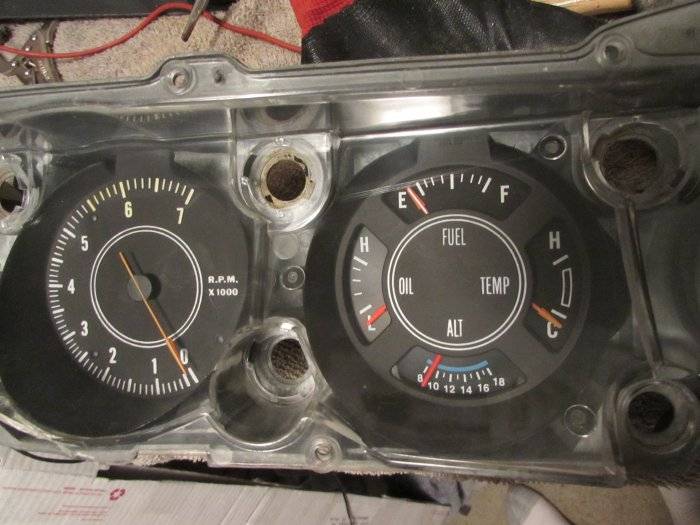

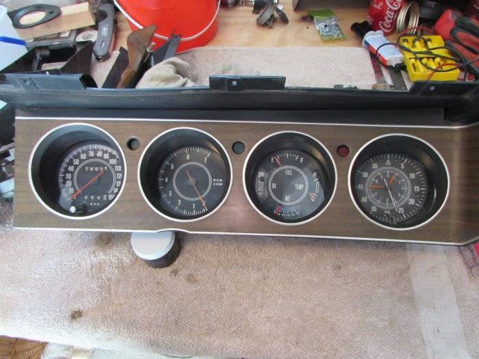

I plan on following most of Maddog recommendations. Will be splicing the two ammeter wires together, running a 10 gauge wire from the alternator to the starter relay, adding a couple of fusible links, diode regulator, relays for the headlights. Will need to connect a positive wire to the red post and a ground to the negative to wire it up. You don't want to connect the two wires from the ammeter as they are both positive. The current flow through the ammeter is what is being shown on the ammeter gauge.
I did a tach upgrade from Realtime Engineering and a quartz clock upgrade as well. Here is a picture of my project.
