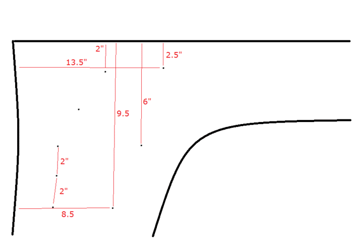

Would anyone happen to know the measurements of where to mount the Fender louvers that we’re on 72-74 Challengers. Or know where I could find a template of any sort? I’ve looked all over the web to no avail.

Not the best thing but should be better than what you have - these measurements were taken off my old factory fender - i didnt grab all the hole locations but it you have the louver and the location of the three main holes you should be good to locate the others - this just makes sure it is canted correctly

Awesome!! Thank you very much! I’ll get this to my body guy.

also note that the top line is not the top of the fender - it is the "crease" body line
