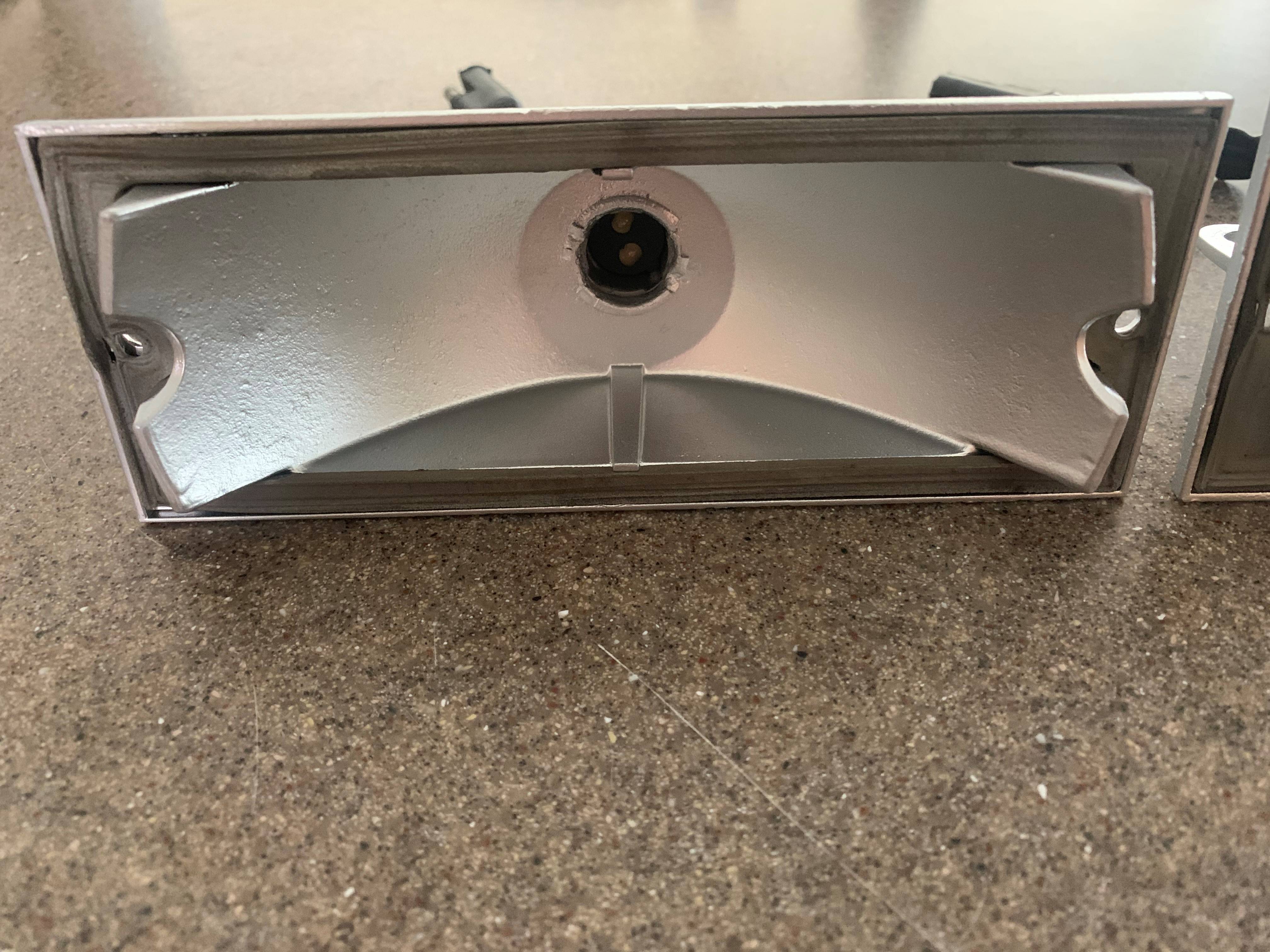

Does anyone know where I can find a replacement front turn signal socket for a 70 Barracuda? Mine are pretty corroded and I would like to install LED bulbs. I looked online. I could only find the 71-74 light socket. Also, how do I remove the old part. Do I twist and pull the old socket out from the back? Thanks.
The socket is pressed in. Remove the conecntors. Then use a 71 the socket parts to rebuild. The other is to remove the socket and use a 71. The hole might be the same for it to fit. someone here migth know better.

I found the the part that you posted. It cost over $500. new. I can get a complete assembly with the lens for $250. I found a pair of new pigtails for a 70 on ebay but I can't figure out how to remove the old ones, Thanks

I found the part that you posted, It's $500, new. I can get a complete assembly with the lens for $250. I found the pigtail for a 70 on Ebay, new. I can't figure out to remove the old socket. I may just buy the complete assembly. Thanks
You would have to grind out the flange on the old socket to remove it from the housing & stake in a new socket
That's what I thought. I think I will probably replace the whole assembly. I can't believe the repop reflector is over $500. Thanks
