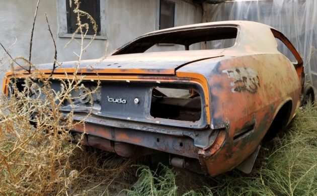

I've never seen anyone say what they have in their projects. Approximately $50,000.00.
Purchase price $12,000.00.
If you started just with that bare body, you did darn good with $38 assuming the 50 included the purchase price.
12 plus the 38 for 50.
I did get some parts with the car. No drive train, doors and some interior parts. Alot of work myself. Sheet metal, frames, new parts, still surprised at the amount of cash it takes to complete one.

I purchase this approximately 6 years ago. I've been on the look out for the original drive train with no luck. Nice looking orange car with white interior.
So... I plan on this as a driver car.

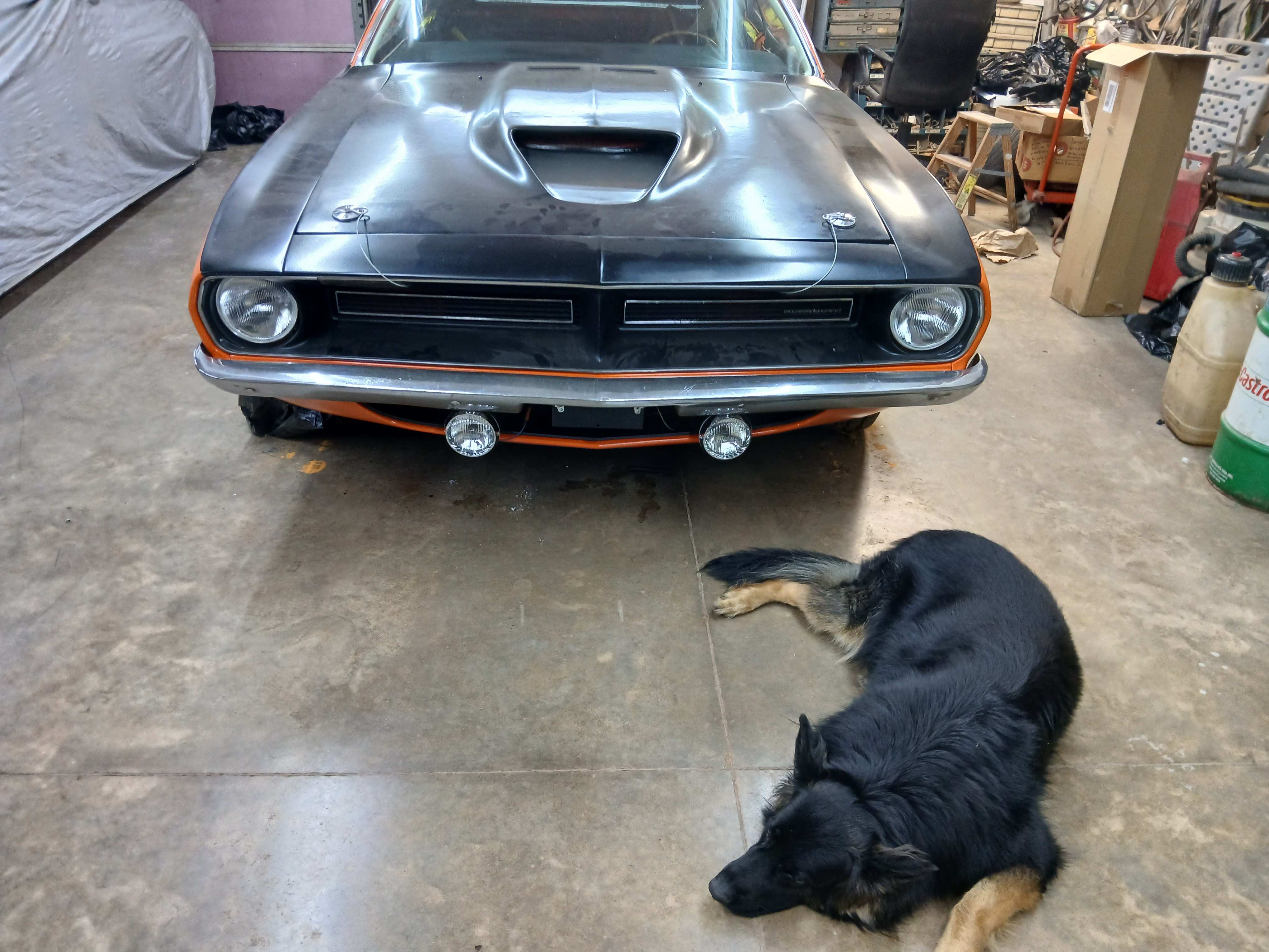

1969 340 J heads
Bored 416/Deck-balanced/10-1 pistons
340 6-pack intake .065 off sides .040 off ends
Holley carbs- Outboards 440-500cfm
Center carb 440-350 cfm
Comp Cams-1,600 -5,800 range
Duration 268/280,Lift 477/480
TCI Torque converter 1,600-2,000 range
Shorty S.S. headers-21/4 outlet.
Borgeson 14:1 ratio power steering box.
Really getting close to having her back on the road.

Off topic I know, but that is a good lookin' dog.
Nothing like a good dog to ride shotgun before you have to use it.
When I got home my dog was just as happy to see me, as if I was gone for 5 days or five minutes. It just didn't matter. The wife would say. Your back already!
Looking great Tom! Glad to see so much done to the shell.
Do you have a build thread?
What do you have left to have it on the road?
What is the 0B number?
Yes
Just interior panels for the white interior, seats, maybe adding the 1971 cassette player if the radio shop ever gets finished with it. A few things underneath. I've done the cam break-in with no issues. Final adjustments on timing and carburetor, then give her a couple road tests if the ice and snow stay away long enough. Diffinatly be at Columbus Nats Ohio next August.
