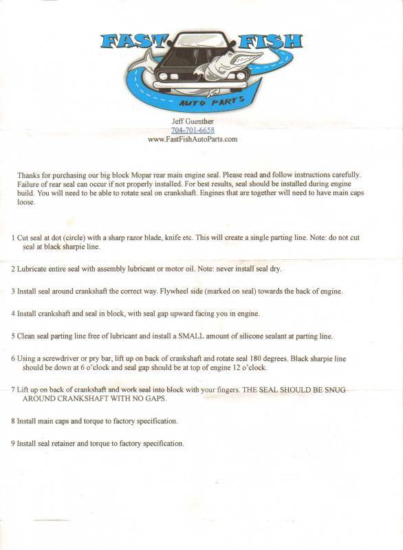

My 383 had a real bad leak. The shop that replaced it said the seal that came from CARQUEST lip would've just barley stuck out of the main. They located this and said that it was tough to get into place because it was so much beefier than the standard style. They did not have to lift the engine any, only remove the steering rod. Here's the link to the seal and also a pic of the instructions that comes with it.
http://www.fastfishautoparts.com/Performance-Engine-Seals.html
