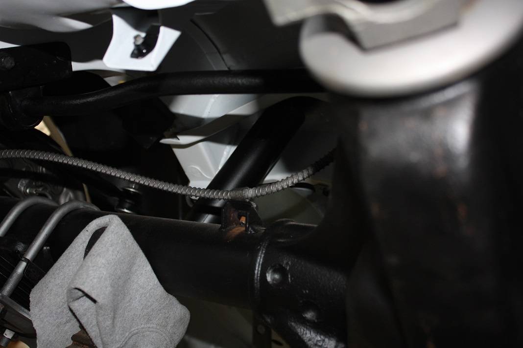

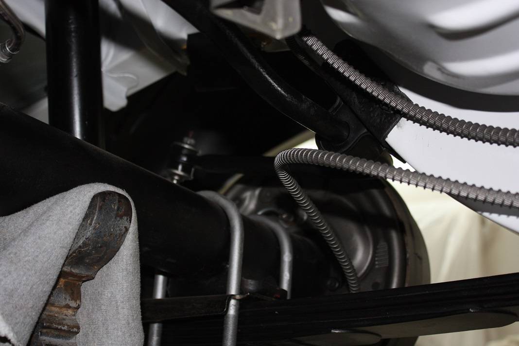

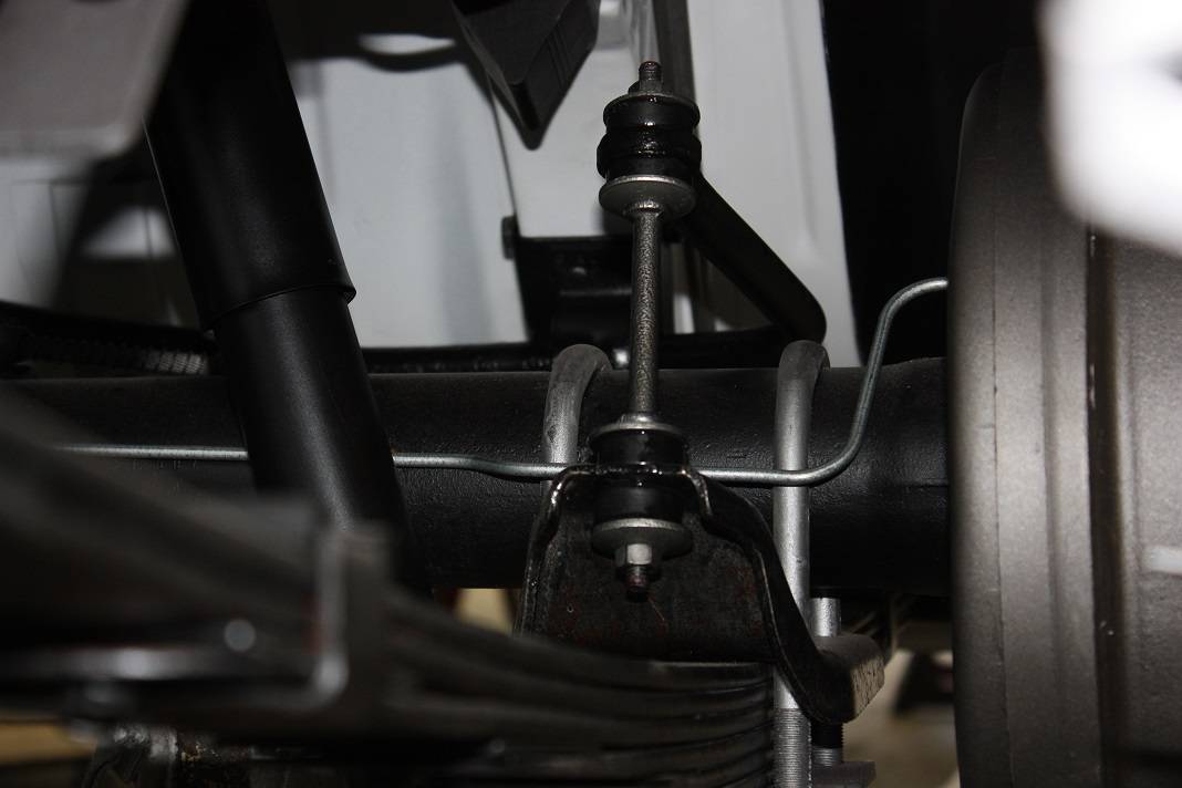

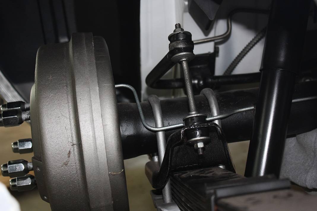

Hello SCHU:
I searched through the restoration pics of my car and these are the best I could find of what you are searching for, hope they are of some help to you. In the first pic you can see the bottom of the "dual exhaust" dr side hanger at the very top of the pic. The "welded on" hanger on the passenger side is at the top left of the second pic. The sway bar clears the hangers and the Dana 60 fine. These pics are prior to installing the exhaust, but it all fit like a glove. I used Accurate LTD 2.5 inch exhaust with resonators like you intend. jess

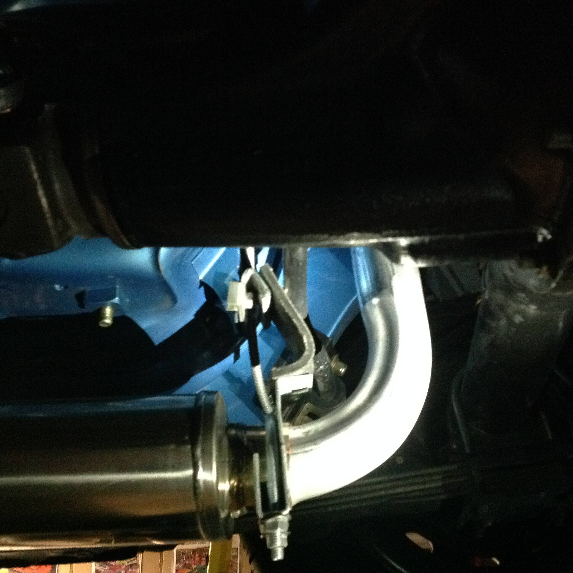

Jess, thanks for looking at your restoration pics for me. Yes I'm running full Accurate Ltd repro exhaust , but I unfortunately reused the modified existing 2 1/4" exhaust resonator hangers.
Now that I have pr of new Accurate hangers, it looks very tight, so I was wondering do you remember does the reinforced rubber straps loop over top and around the rear word side of the sway bar ? Holding up in place, kinds looks like the strap rubber could rub the bar but should not be a problem. I'll try to upload photo of current wrong/ modified hanger, that shows it hitting sway barresonator hanger RH side (pic #2 side view).jpg.
