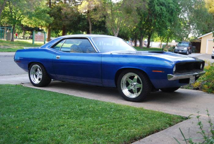

Hey Big Al,

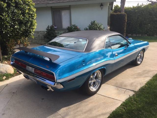

Without any mods, l tucked a pair of 275 x 40 x 17” under my Cuda. They ride on 17” x 9-1/2” Centerlines. Unfortunately, Centerline does not offer this series anymore. I used a Percy Wheel Fitment tool to determine the correct offset. They’re a bit spedy ($75.00) but money well spent. Good luck finding the perfect combo.
Fishgutz.

Hey Big Al,
Fishgutz.
Your setup looks great.... Thanks.

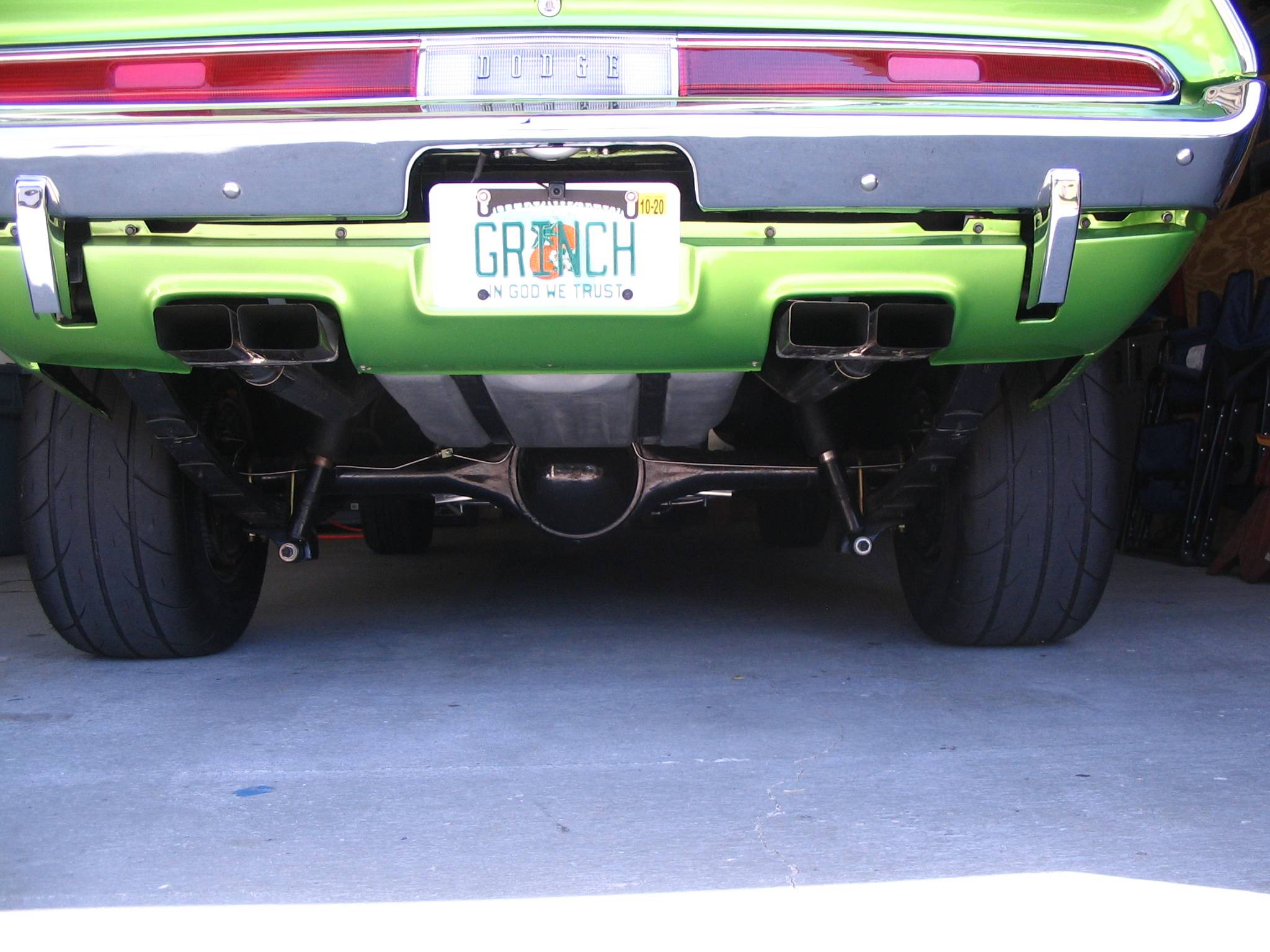

A 315 requires more than just an inch. I have mine moved into the frame rails (3") and it is tight all around with 316/60/15 D/R's but I have my car sitting pretty low for a 30" tall tire.

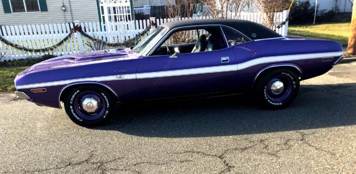

Hope this helps
Running 255- 50-17 rear- could go a hair wider and taller
225-50-17 front
Firm Feel Suspension
Car sits about an inch lower than stock
Handles and rides really well, corners very flat
Running 17 in wheels to fit over the Wilwood brakes
Next step to get 17"magnum 500 style wheels-not a fan of what I have
enjoy your ride

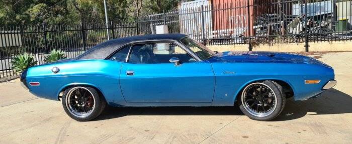

AUSTA
Apr 16, 2015
959
515
PERTH WA
Trying on the Forgeline ZX3 test fit on a standard setup rear 5.75 backspace 275/40/18 Bridgestone super sport pilot front 4.5 245/40/18 same about 1/2 clearance both sides on rear
1 inch difference in height front to rear both about 1/4 inch height (smaller) different than a standard TA setup

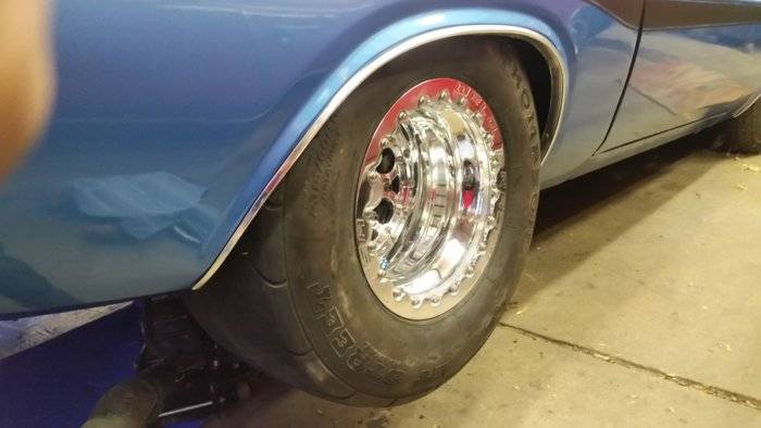

Cratos
Sep 11, 2018
408
65
Sunny Florida
the A body rear I picked up needed them added on, someone have moved them way inboard like for a drag car. so yes I had to have them added @ 44 inch center to center for things to line up. the keystones 15 x 10s did not offer diffarnt back spacings but they are a deep dish wheel.
