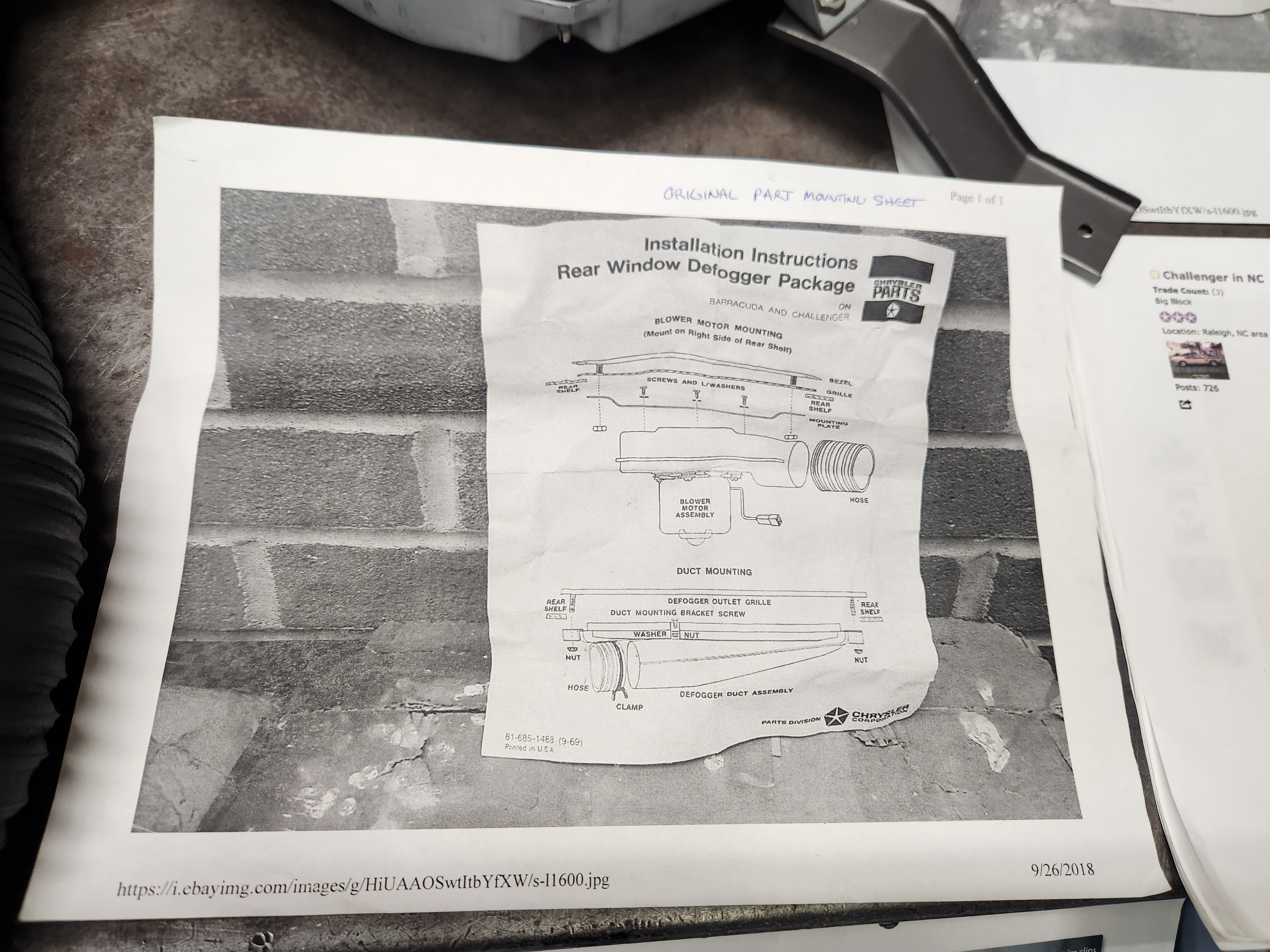

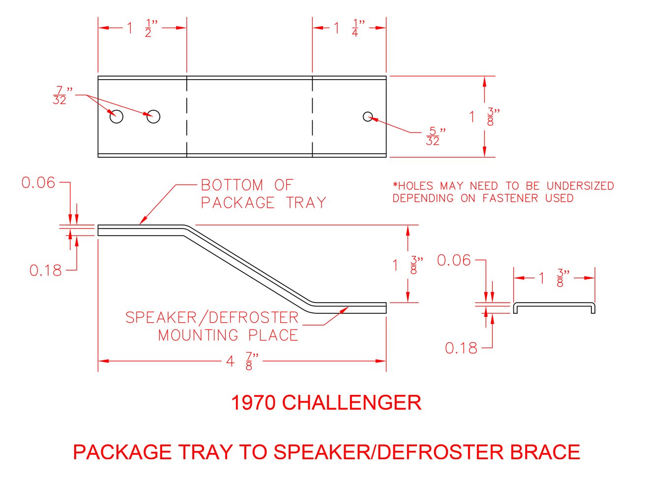

Good catch, updated image with overall dimension.Does anyone happen to know the overall length of this bracket? This diagram is great and shows the lengths of each of the flat sections but wasn't sure on the length of the "sloped" section to see if I can get this fabricated somewhere.
