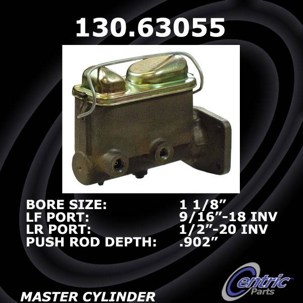

The aftermarket replacement units seem to all be 1 1/8 in bore which will work in a pinch. I picked up several new units to see what was out there;

Some people like the quality of the Centric Units if you have to go for a replacement while you look for an original.
