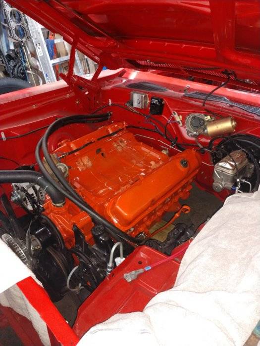

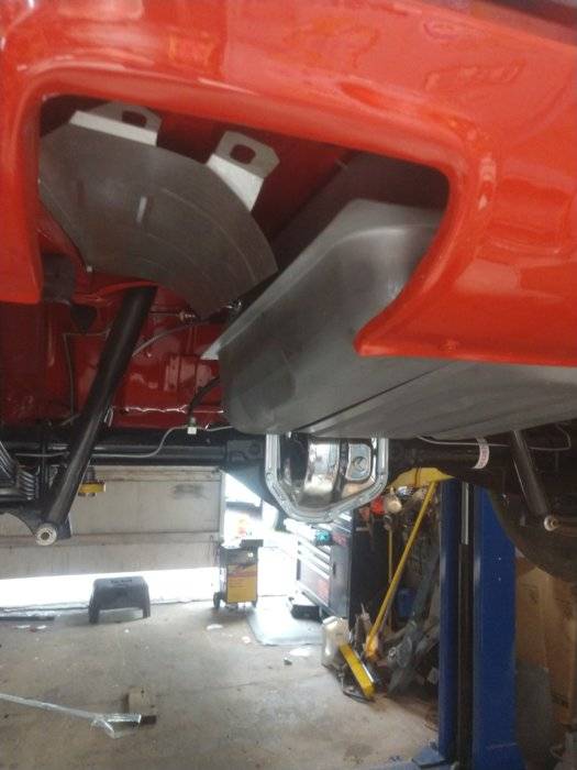

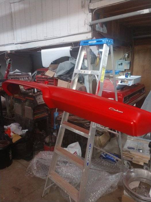

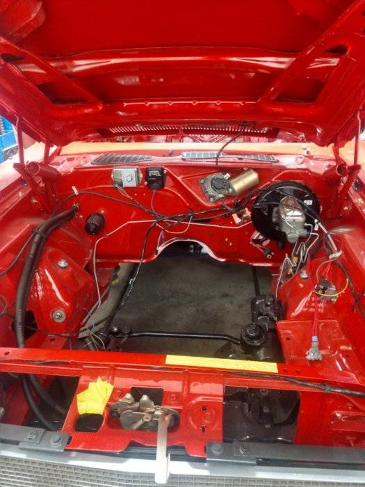

I have a 71 R/T, it was in bad shape when I got it; I replaced the firewall, roof, driver’s floor, Dutchman panel, trunk pan and extensions, fenders, hood, trunk lid, driver’s door skin, and passenger lower quarter; amazingly my inner fenders were good. Here is a link to my photo album, it’s a couple of years ago, but many pics. :

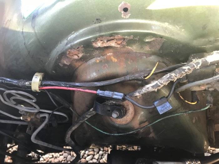

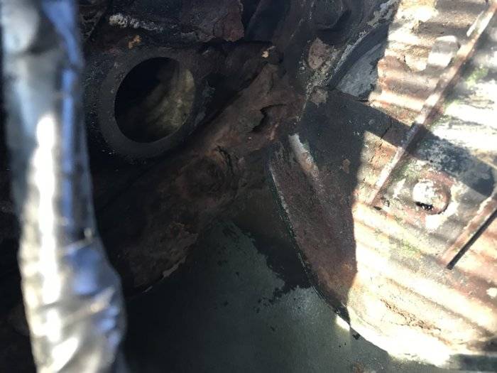

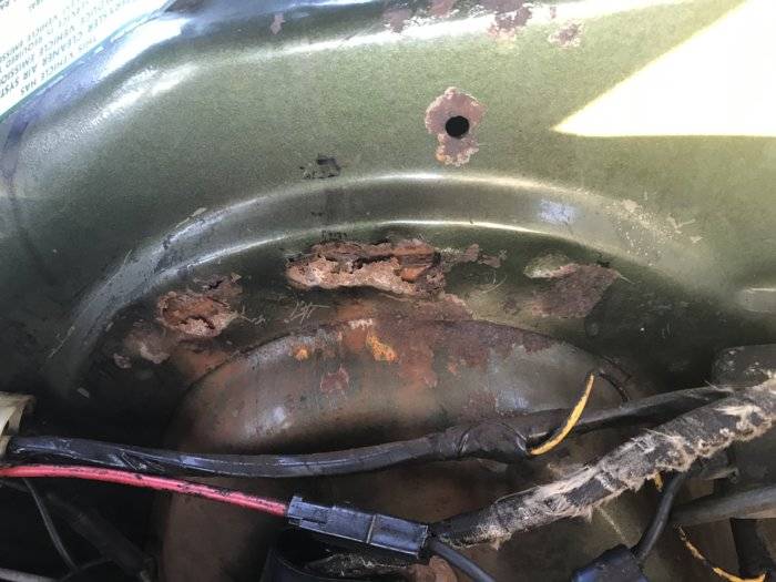

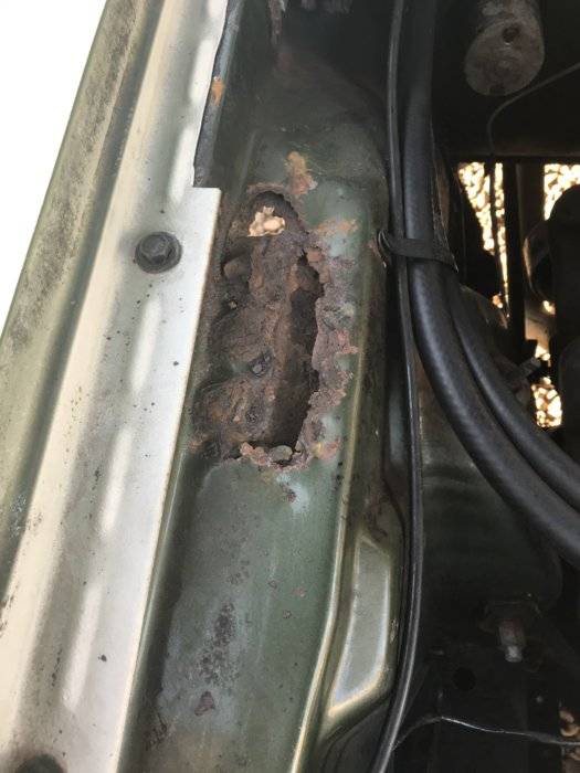

I would sandblast the area so you can properly assess the damage and it will make it a lot easier to weld if you decide to repair it rather then replace it.
Thanks, that’s what i throught Also. Btw for the inner fender repair you mentioned brackets. Do you mean the upper en under fender to cowl brackets ?

There are 3 brackets on each side 6 in total that join the inner fenders to the firewall, one of them has the 2 rear hood hinge bolt holes in it, one is small and goes on the corner of the firewall at the top and the last one is a long 90 degree bracket that joins the inner fender to the firewall at the bottom.
aussiemark
Nov 29, 2014
1,224
333
Perth Western Australia
I just remembered the small bracket on the corner of the firewall joins to the inner fender brace ( the support that joins the firewall to the shock tower under the front fender) if you aren't replacing the firewall you won't need this one so you will only need 4 braces in total AMD part number 260-1570-2P and part number 260-1570-P the lower brackets (260-1570-P) may be reusable as long as they are not rusted but the top ones with the hood hinge bolt holes in them are usually rusted.

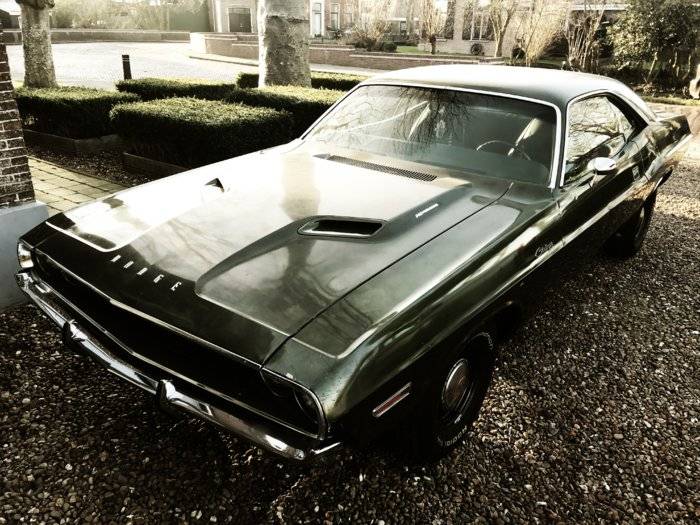

I am ready to restore my 1970 Challenger 340 4 speed in the Netherlands (Europe). I already put in new carpet and a new driver’s Seat cover (legendary) . The car now needs new inner fenders (both sides) . Because i have to order these from the USA i really want to know which fenders fit the best and are the best quality. And of course where to order. Most people say AMD is the best. But what About Dynacorn? They are cheaper and you can buy a whole kit. But are they bad ? Can you please help me ? And If you have Amy suggestions they are more than welcome! Marc

Looks like you will need to replace support bar from firewall to shock tower just did my ,70 challlenger
